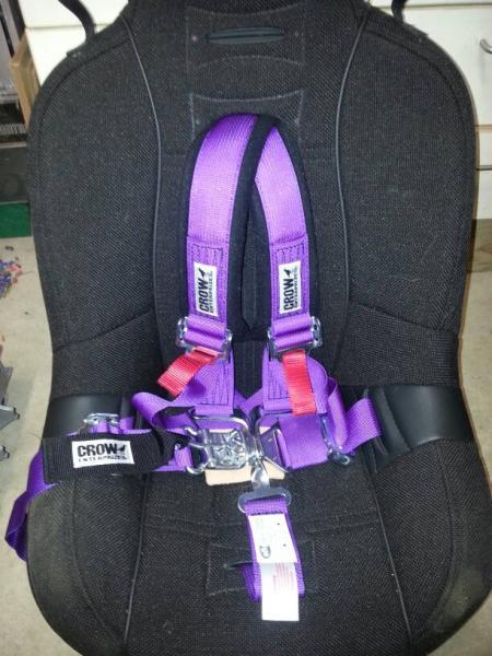

Something was delivered today that made a little girl very excited!

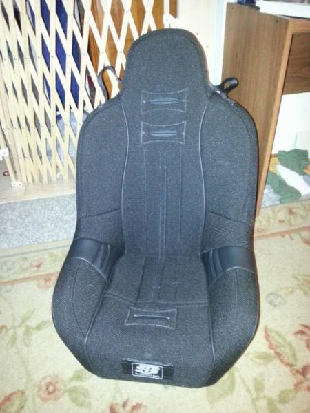

Yeah, she is very excited. The seat was a little on the pricey side, but the piece of mind is worth the extra money. I found some cheapo kids seats that were like $80 cheaper, but on top of not being a high quality seat, they were smaller. Since this one is bigger and will last longer, it should be cheaper in the long run. I also have a brand new Crow 2" Junior 5-point harness on its way.
I decided to upgrade my seats as well. I'm 6'5" and my old seats were made for somebody about a foot shorter. The top of the headrest hit me about half way up my neck and the harness slot was about right in the bottom of my shoulder blades. If I had a bad rollover, it would probably break my spine. So I picked up a set of brand new PRP Comp Highbacks from Nick and sold the El cheapo JC Whitney seats at the swap meet. My head actually hits the headrest on the PRPs and the harness slot is actually at the same level as my shoulders, so it will be much safer now.

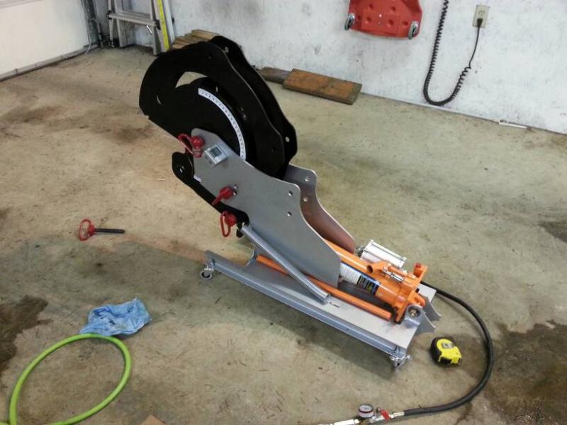

I also picked up my bender from Rogue at the swap meet. I got it all welded together and put a coat of paint on it last night, so I'll be assembling it tonight. I also got a metal brake for my HF shop press from Swag, so that should come in handy as well. I'm probably going to start bending tube on Sunday.

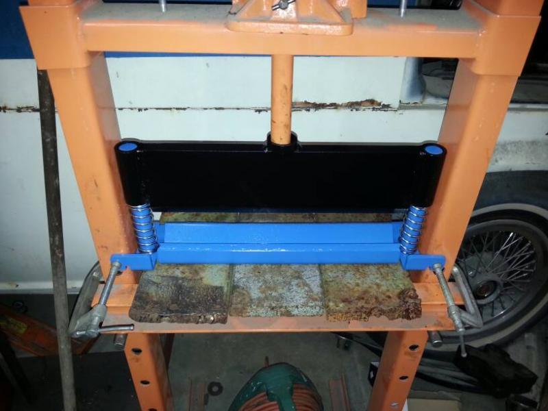

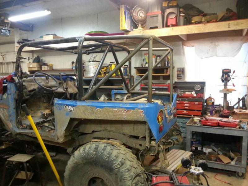

So spent some time.out in the shop today and made some decent progress. So first off, here are my new toys, Swag 12-ton press brake and a Rogue Fab bender.

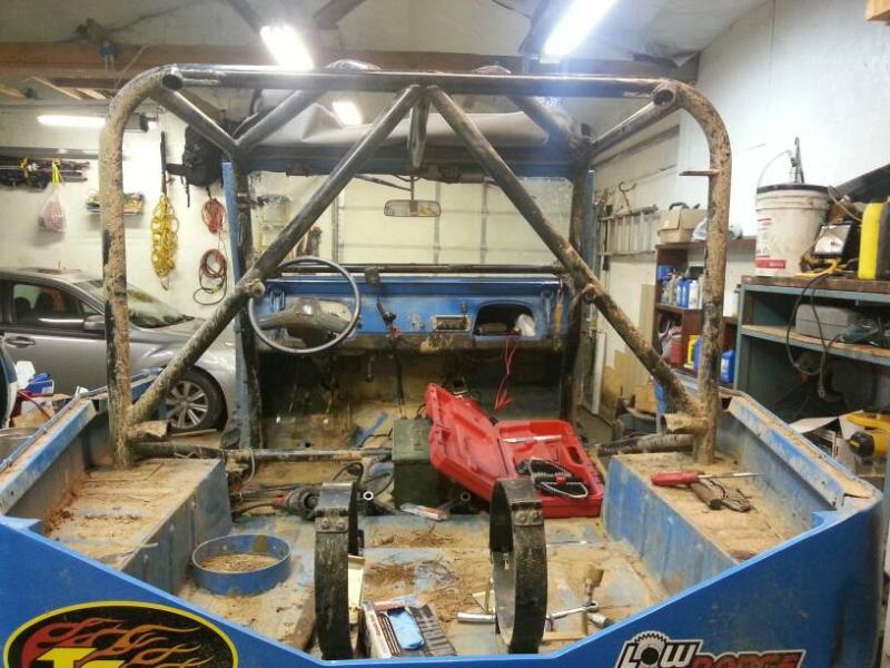

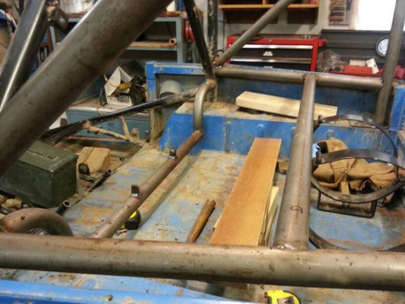

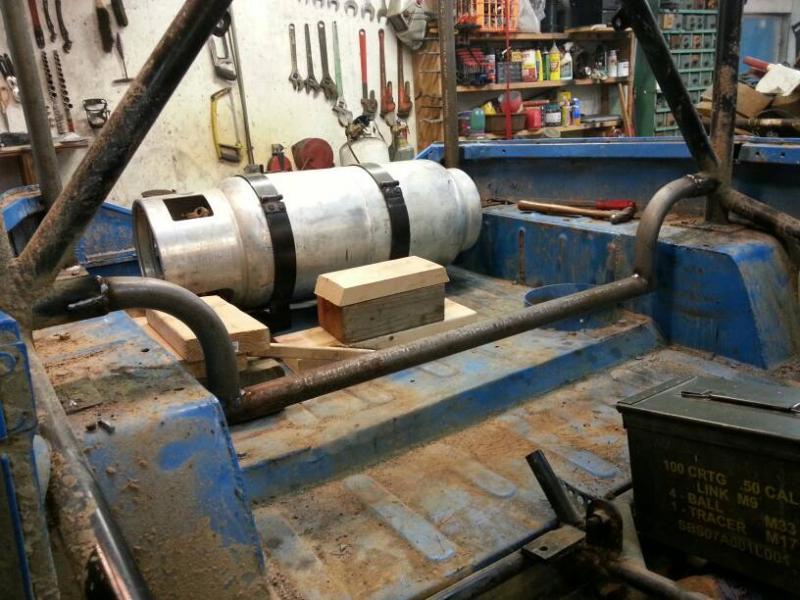

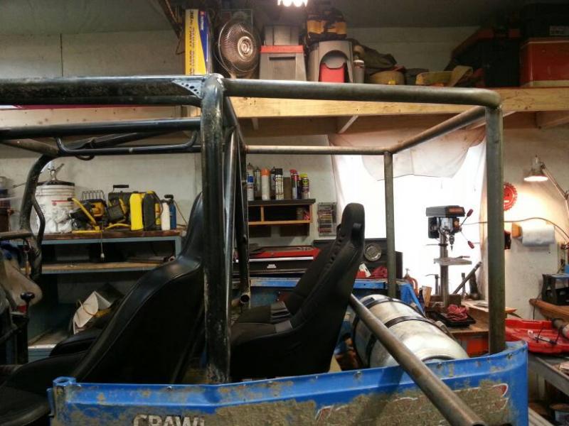

I got the rear halo and supports in. In the first two pics I have the seats sitting on blocks test fitting them.
I had to cut out the original cross bar out to make room for the seat. It worked out well that the old tube I cut out was 2", so I was able to slide the 1.75" tube inside the 4" or so I left. I'll be running some tabs off this bar to mount the front of Leia's seat to.

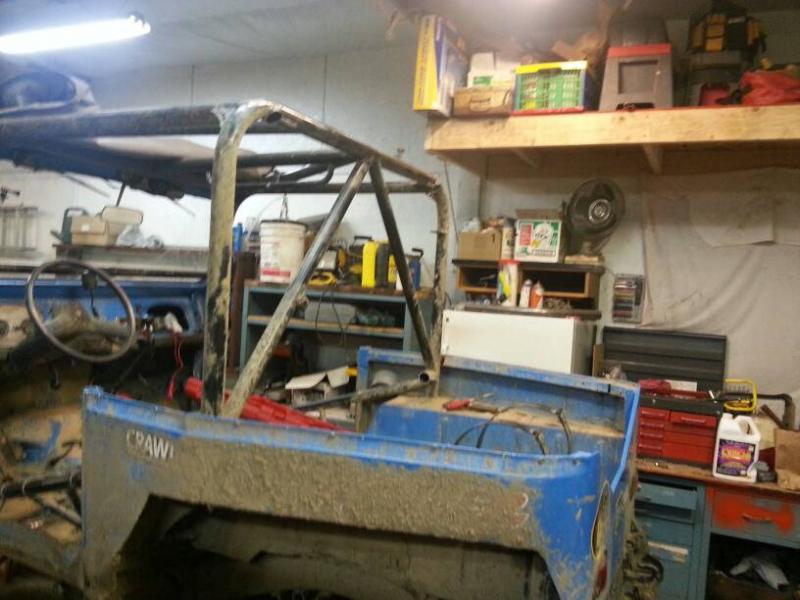

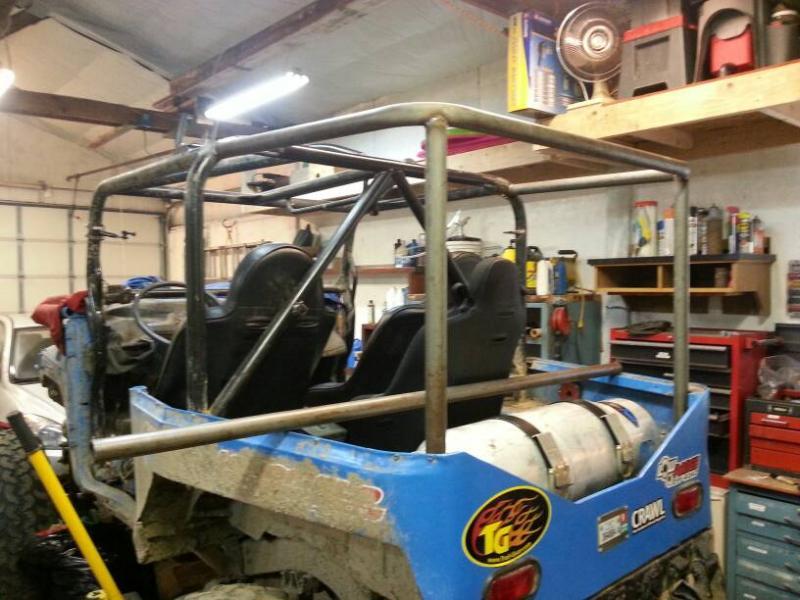

Made some more progress. Got the side bars in and I got the cross bar in that the seat frame will hang off of. I also got the front tabs for Leia's seat welded on. Leia's harness also showed up today too.
