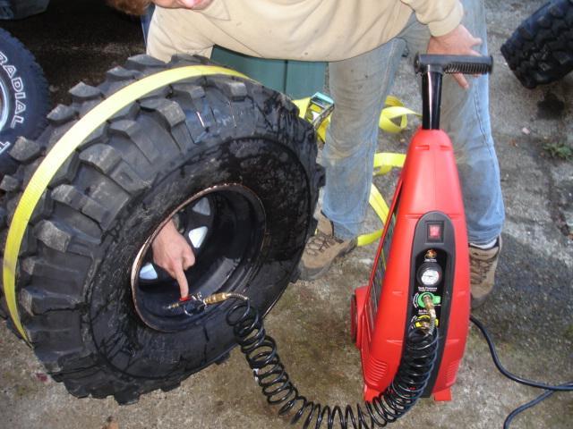

The Captain, and I use my MANLY compressor and threw the rims in the middle hole of the tires.......:D :redneck: :haha:

snwbrdpunk16 said:
30 bucks will buy 3 MAN hookers. :clappy:
and a compresser, that with the mad skilz of two man hos and a truck strap can put 4 large tires on rims and air up in 30 minutes or less! ILOVE BIG TIRES...I kept two here just for myself.....:redneck:
What are they now end tables or are they the coffee table so you can sit and stare at them all day
I am working on the GF to let me take them to bed with us:kiss:
