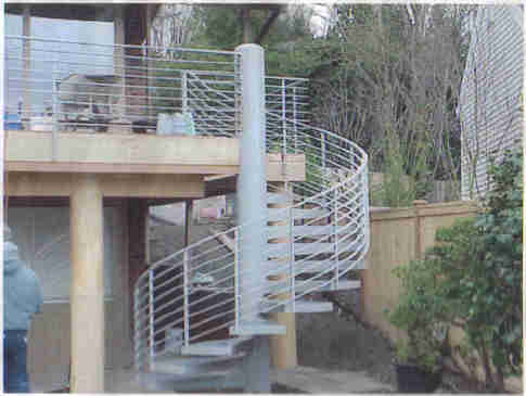

How many spiral stairs have you did?? Conventional and Center less, done that for 7 years, how about you?? :corn:
This one was fun to do, that's a 1"x2" top bar with 1/2"x 1 1/2" horizontals, 1" square bar posts, and a 12" center column with pan treads, all done be me, including the treads. I also measure and detailed this project too. :;
sorry for the hijack Ethan, now were are the latest pics of that rig. :awesomework:
