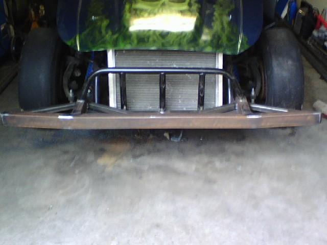

what a little to tight for you ? well the car needs a new f.bumper:haha:
