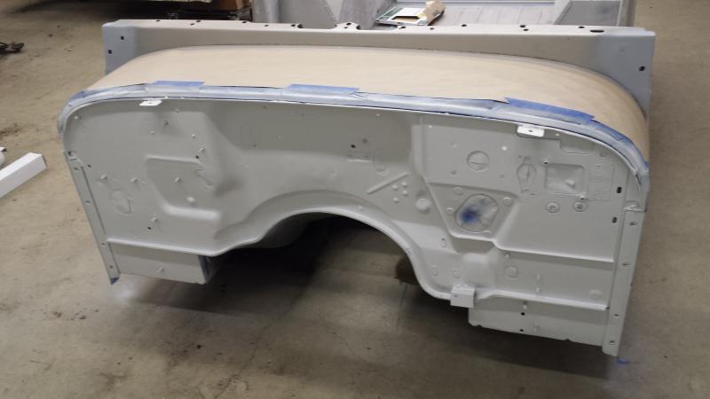

Ok so since the tub is done on the front I went ahead and painted the engine side of the firewall...
