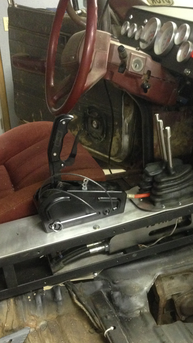

I have the magnum grip pro stealth. Haven't been able to use it yet but I think I'll like it. Standard shift pattern
http://www.billavista.com/Tech/Articles/Ultimate_Offroad_Auto_Shifter/index.html
Long read but good write up on the b&m shifter. Helped me make my decision for what I'll be using it for
