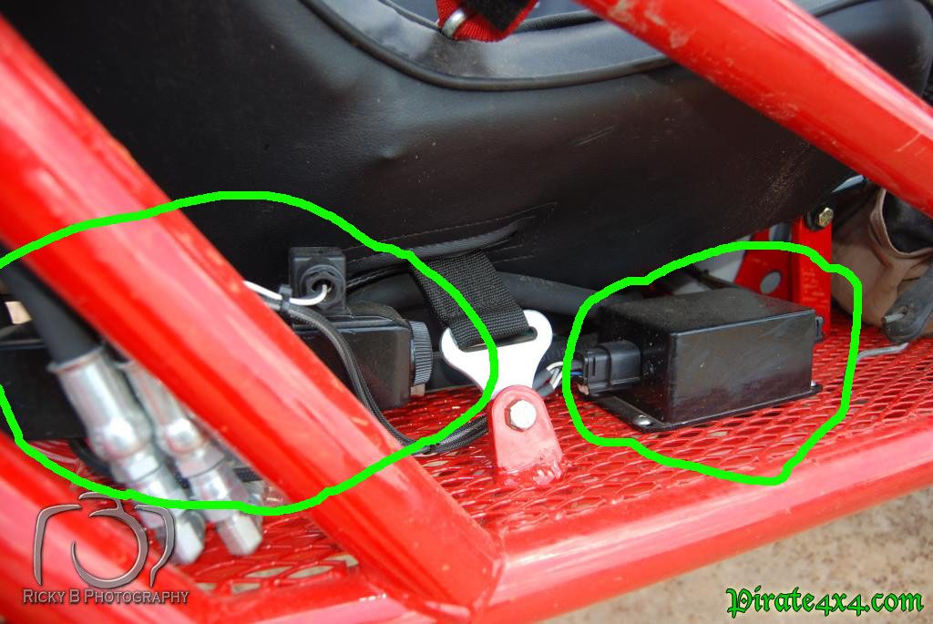

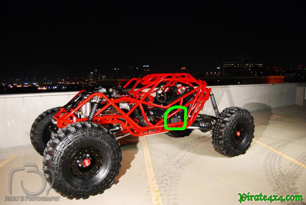

I got a couple of questions, can someone tell me what the box is on the drivers side on the floor next to the seat (looks like a shifter)?
Also, what are the two boxes on the passenger side one in the front with wires going into it and the one in the rear with the hydro going into it and what the knob is for?
Thanks

Retribution said:
Let me start with a couple shot outs, TC Bad Ass Buggy! Give it some hell. Ricky B & Busted Knuckle keep taking those great shots & videos!
Thanks
winch. Rearsteer valve an center control box

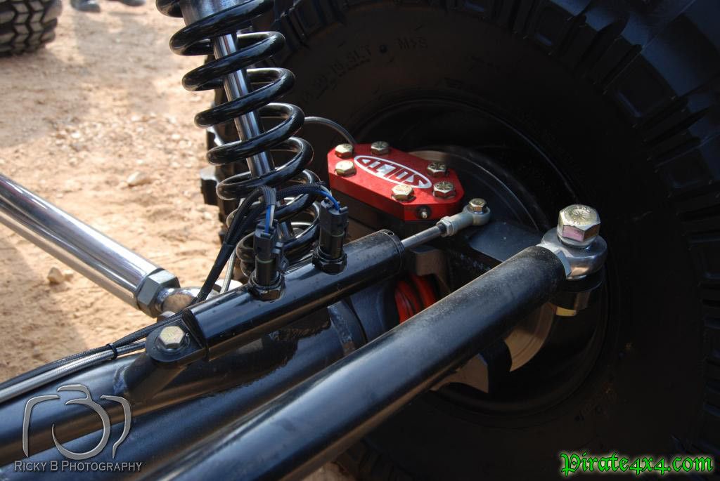

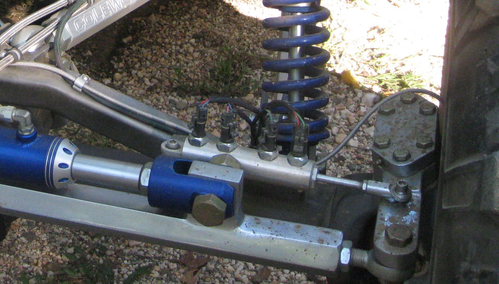

TC, can you tell me what the difference is between the self center units on Showtime (2 plug) & Jenny Craig (4 plug)? Are they the same manufacture? Who is the manufactures of each units? Really cool idea, I want to follow up with the manufacture to learn more.
Thanks

Mark had Bryan put that on Jenny. It has lights in dash that tell u which wayway axle is turned +self center. Mine Is jus self center .that has been wired to a switch so I can jus use it when I feel lazy. thumb.gif
Sorry to keep buggin ya but, who makes the self center (contact info)? One last question, are those 14" knuckles or after market?
Thanks again.
Thanks again.
Stazworks. For more specs and info check out the pirate article. Full spec sheet at the bottom.
