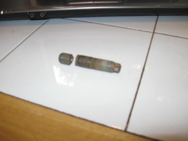

stupid thing is ,is trail gear sells the knuckle and arm for $250. or sells the arms alone for $250, so you would be kind retarded to not order the set together? 6 shooters are not bad ,but the trunnion pins suck, jeremy broke one and bent two others before going trnion elim kit.
