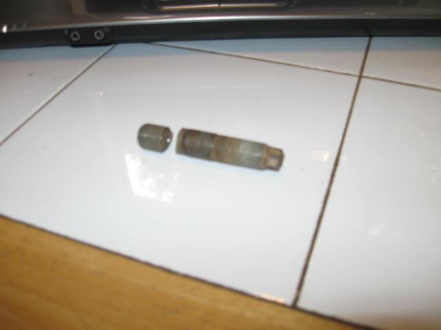

Oh yeah here it is, broken ARP. From a toy on 38x16 wide TSLs with a v6, exo, elocker front, yadda yadda.
