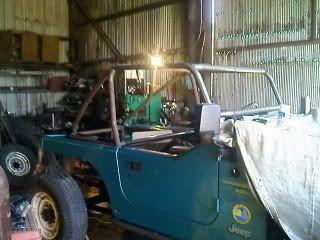

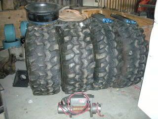

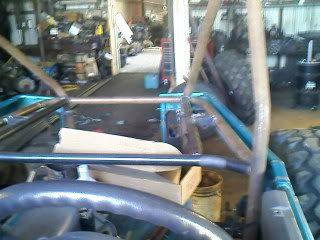

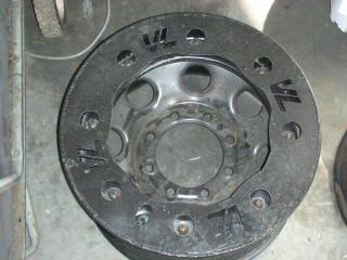

Just a few updates, the 4.3 Atlas came in and Parts Mike Hi-steer arms, Kelly has bent some tubing and the wheels and tires are mounted. They look great, and they hold air.. Next up is to get them cut, Kelly is workin on the rest of the cage and we should have mounted seats soon. The Guys from Rock&Roll offroad hooked me up with the Sweet Trucker Chic Drive flanges. :woot:

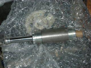

Here are some goodies:

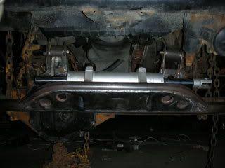

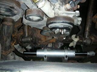

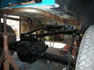

1st backhalf and coil setup:

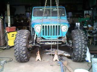

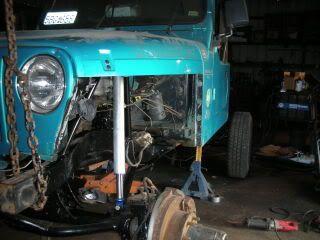

We had clearance issues with the Fox Airshocks, so then:

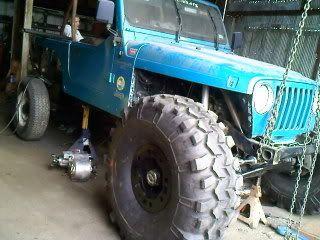

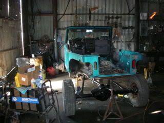

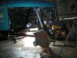

Here it is with the 44s mounted and about an inch above ride hieght there isn't any Nitrogen in the shocks so we use the hoist for setup:

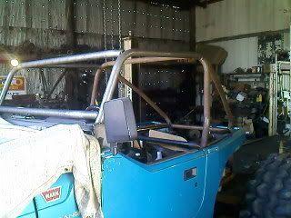

The hood will be cut at the bodyline and a filler will be made to hide the Yellow Tops, then a tube will run from the rear wheel opening at the rocker flowing forward to the grill hoop. That's what I have for now. More soon.... I hope you all like it
