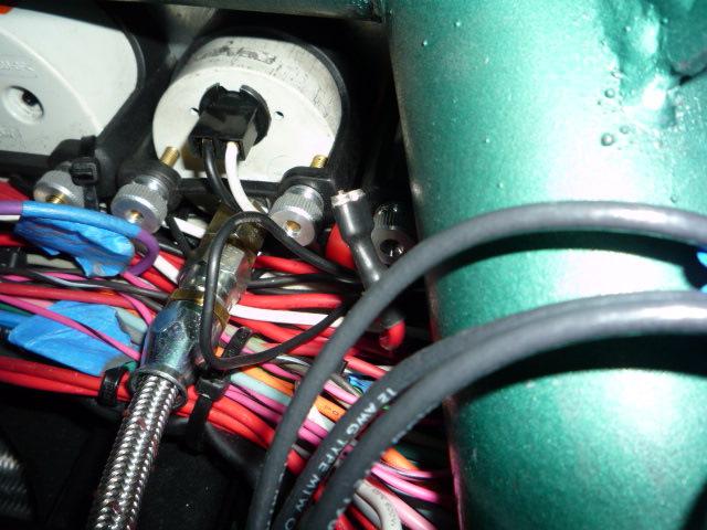

Started cleaning up the routing of the dash board wiring and re-mounting the fuse block. it was not happy where it was and i didnt have easy enough access to it.
Also the gauge wiring was being pressed into the dash frame so it needed to be moved around.

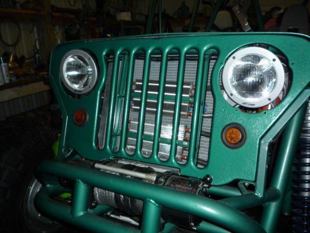

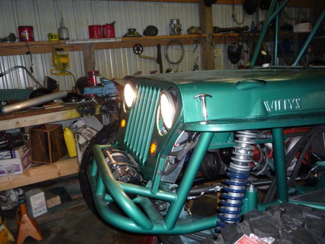

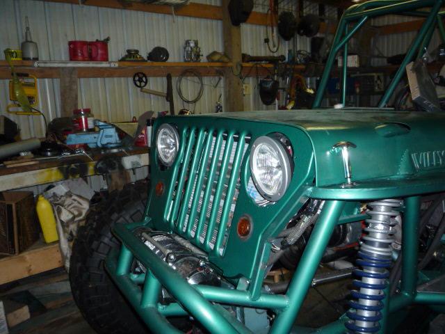

mounted my driving lights, and this allowed me to finally paint the grill. ive been wanting to get the painting done and now i can.:awesomework:
first is the new oil pressure line i made. and the reason i tore all the wiring out of the dash. it was not happy.

nice!! got the grill painted...
Looking' good Hip!!

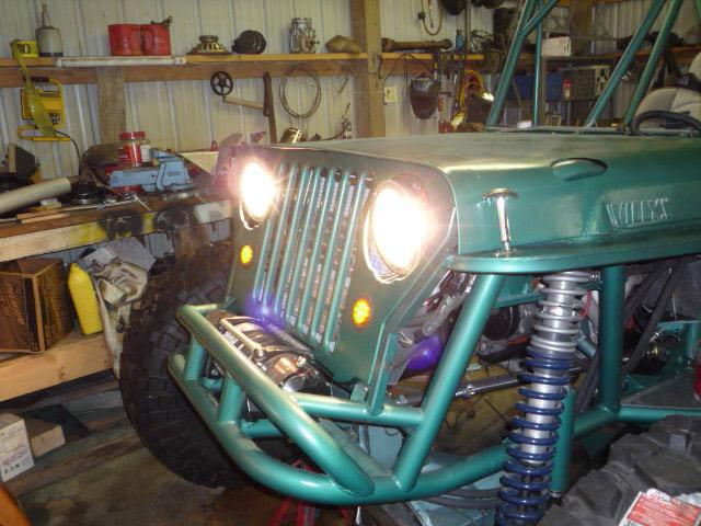

:D HEADLIGHTS sorry for yelling.
