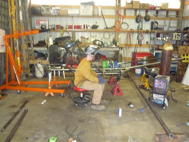

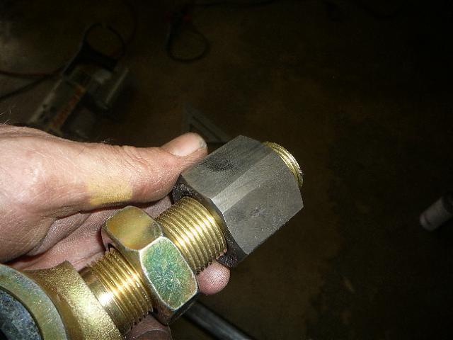

Sam cam by today and burned some wire for me. Did a great job with my shitty fitting abilities, made it all look easy. Had him buzz on a couple of rod ends for me first.

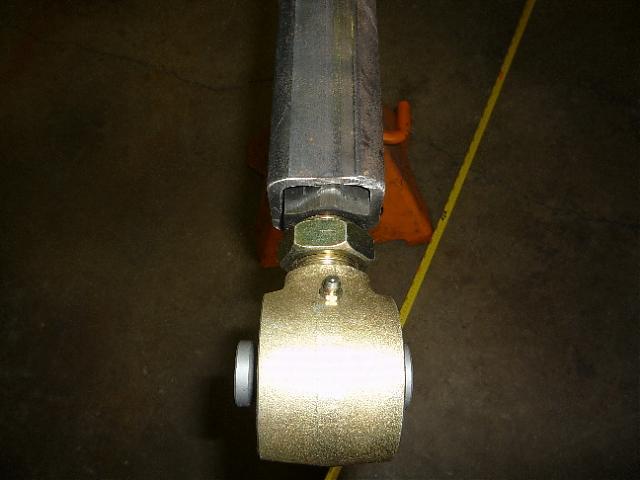

these are called tall nuts, $2.34 each. They just fit between the flats and with a touch of the grinder on the tip of two corners they fit snugly into the id of the Square tube, once i have them cut to length ill weld these into the tubes. maybe put a rosette groove in the sides.

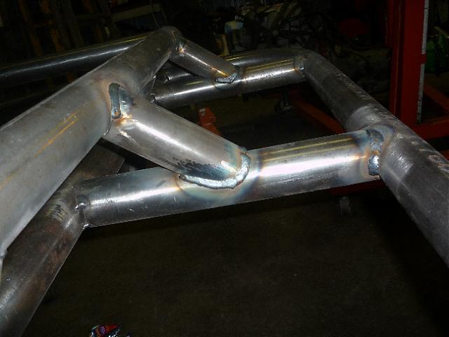

Couple of joints welded up.

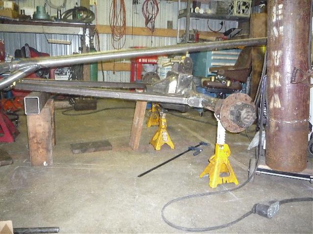

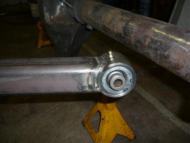

MAde the rest of the lower linc axel ends today, front axel is in place and tacked so is the rear. now im thinking i might want the front pushed out another two inches.:eeek:

I went square cause i plan on making my mistakes and its actually stronger than most round DOM tube for bending. Even Bernies .500 wall stuff got bent. Square is readily available and pretty cheap. You know me its all about cheap do it your self.

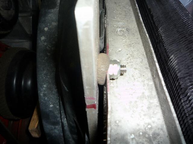

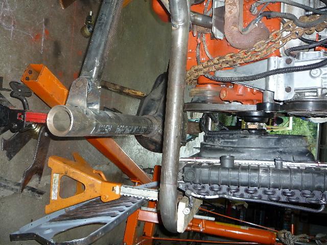

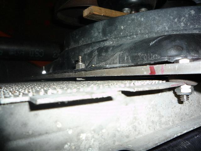

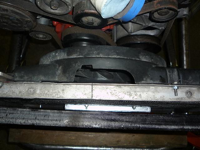

Decided I needed to know where the radiator assembly was gonna be so I could miss it with the upper front link brackets, so I went after that today.
Mounted the Taurus 2Sp to the radiator with a piece of 1/4 Aluminium strap. I need the other side as it was not long enough to make both sides.

The assembly consists of the radiator stock from the blazer with built in oil cooler, an aftermarket tranny cooler I figured for hydraulic steering, and a reciever that came on the original blazer I am gonna use as a tranny cooler.
I left a half inch for engine clearance.

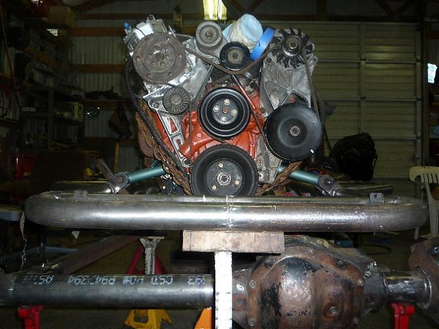

Pretty much have the lincs lowers all figured out, as to angles and where the ends are gonna land. Pretty much figured out i need to move the motor back to dead center on the frame as everything will actuall fit better. The upper lincs can tuck higher when the front pulley is centered.
Also the front drive shaft will actually be straighter, as will the rear.

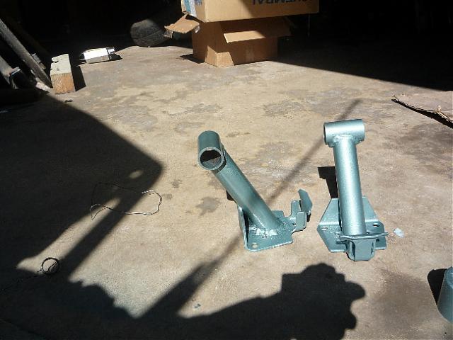

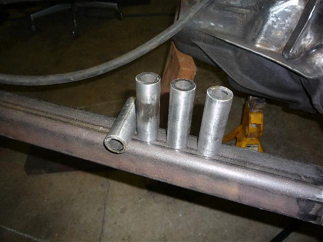

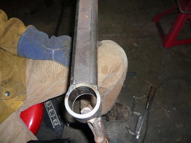

Guess what these little babys are for?

A little anti progress today. I moved the motor back to center in the frame. At least part way. I need to replace the blade on my porta ban saw so I can remove the old temp mounts from the plate I need to reuse.
So the rear is relocated and tacked the front is still on a jackstand but centered. Front upper links will have another inch now.:awesomework:
Bushings for something?:eeek:
Ahh, close sleeves to go thru the tube for mounts. also to make my winch mounts. 5/8" ID .250 wall.

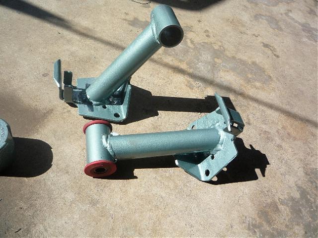

Ok recovery time the motor is now back centered, and the motor mounts are burned in and painted:D
I really like the two colors of green im gonna use, this is the lighter shade. Rustoleum hammered.
