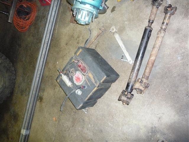

3 ea 2" and one ea 1 1/2"
antirock sway bar
fuel cell and pump
we gots some bending to do.

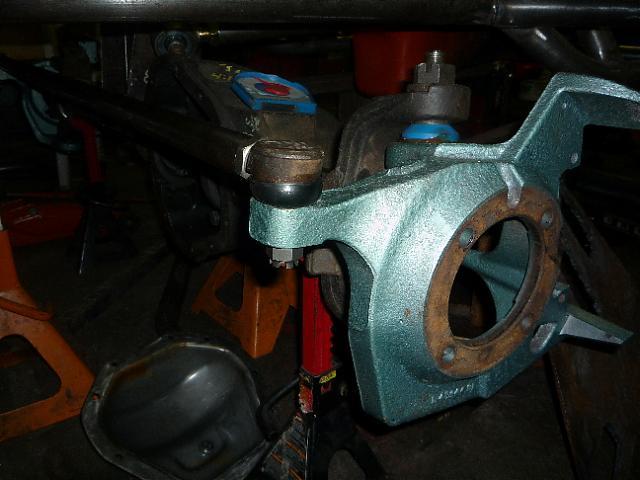

Tie rod is ready until hydraulic system is purchased.

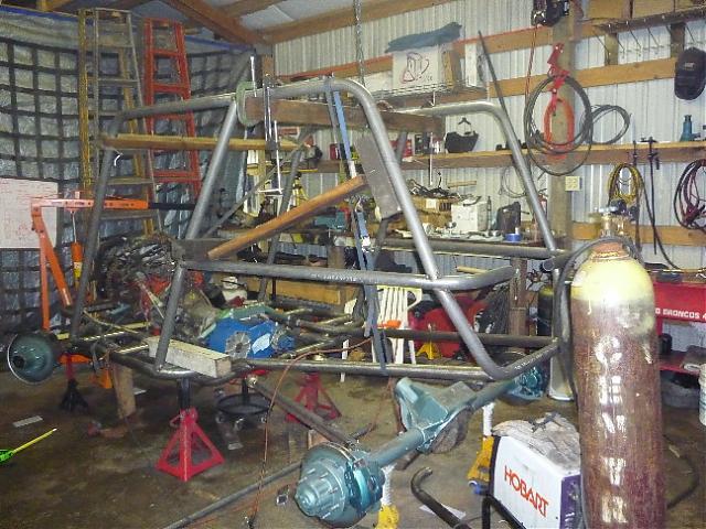

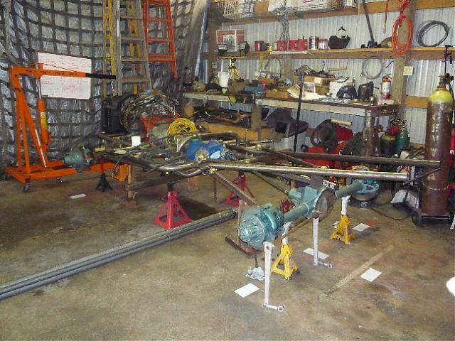

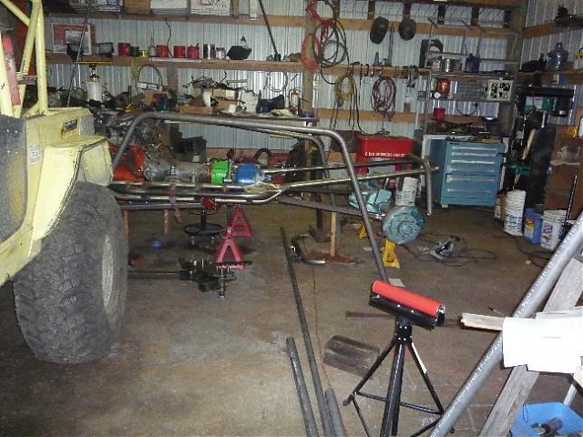

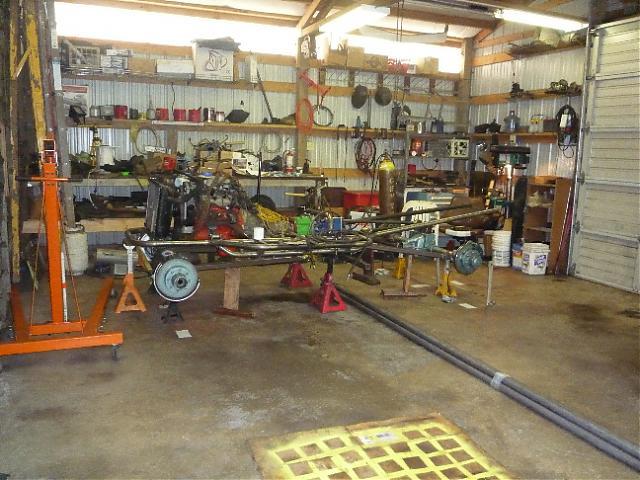

ok so im hoping to get a lot accomplished on my week off so here goes:

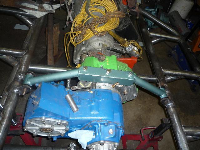

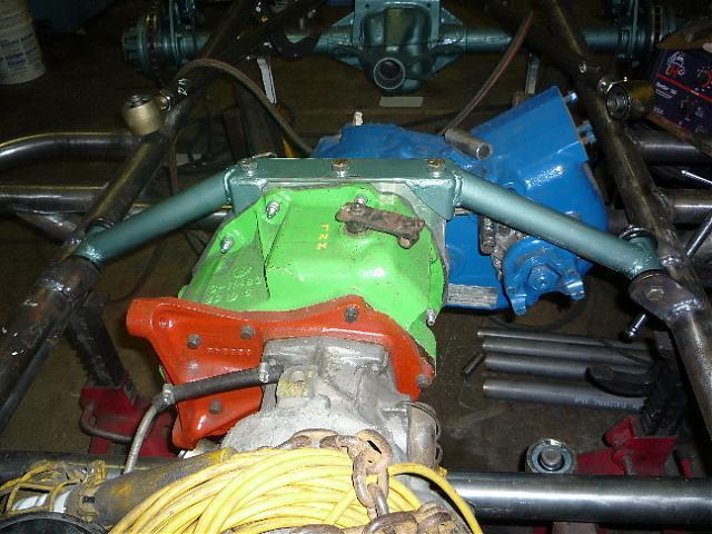

some before shots and the tranny mount we made today.

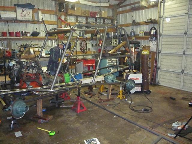

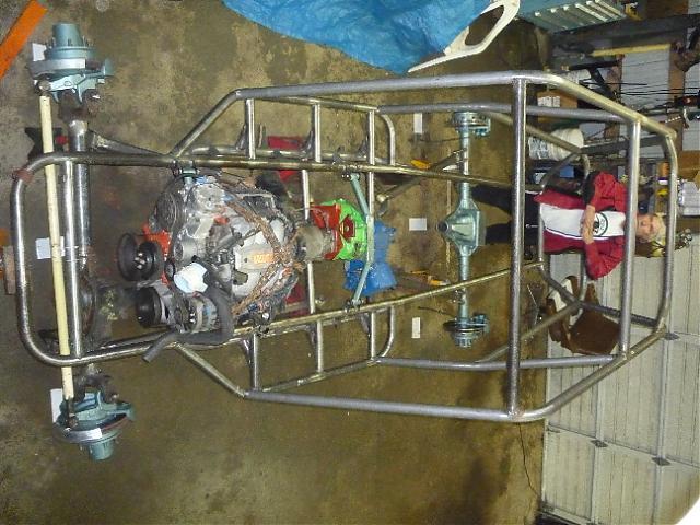

Ok so we made some progress today that we can actually show.

passenger side rear quarter shoulder bar. it drooped down a little towards the center of the vehicle and i didnt notice till yesterday. easy rotational fix by removing 6 tacks. you can actually see it in the front view picture above.
ohh and if you meant which bead the rear passenger inner.:fawkdancesmiley:

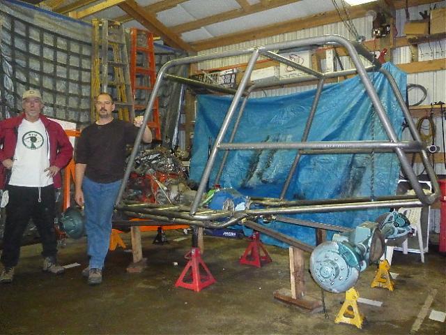

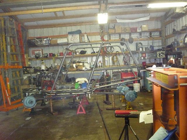

couple more shots...
Man that looks sweet. I like the pic from the top. That's what people are going to see when your in the Sluice Box...
