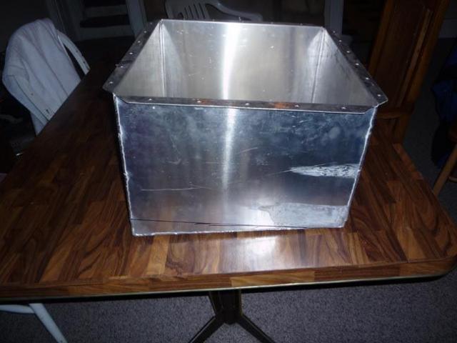

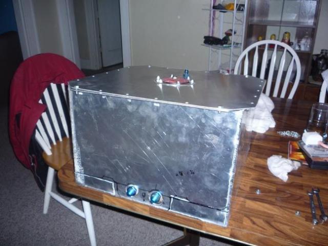

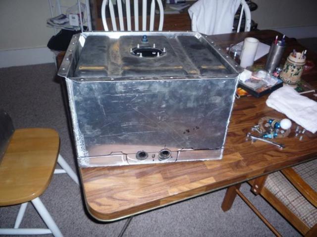

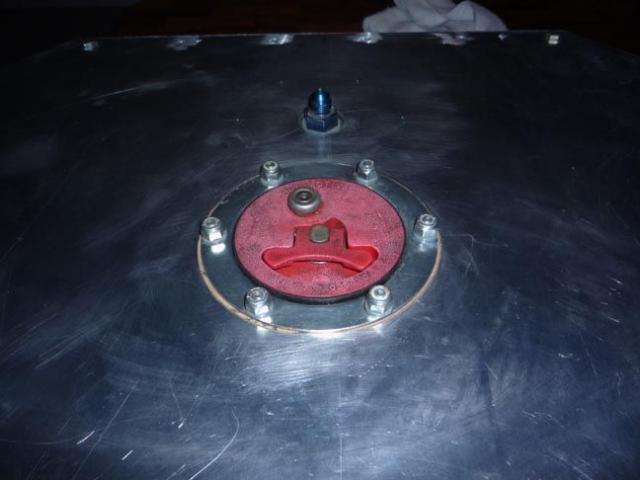

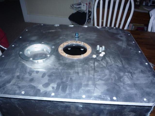

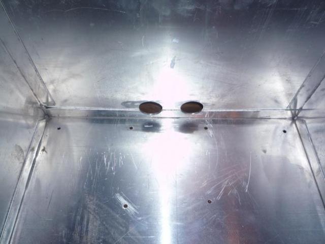

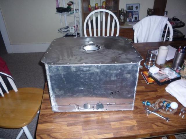

first off some shots of my fuel cell can.

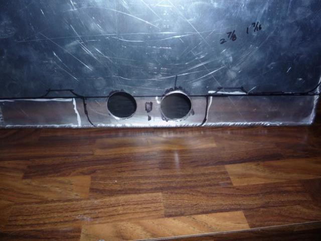

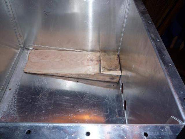

the guy made the bottom flat instaed of shaped for the dropped pickups. i was gonna cut it and reshape but i decided to take the redneck way out. i cut a couple of wood wedges to support the weight of the fuel on the larger flat areas of the cell.:redneck:
last fuel cell picture, i still need to weld some tabs for the mount oncew i get it set in place.

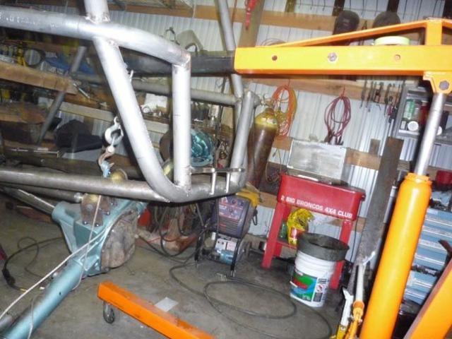

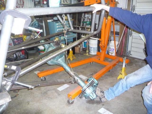

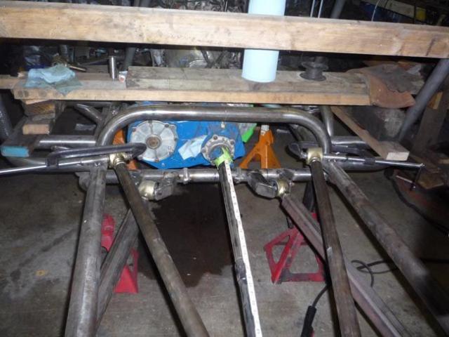

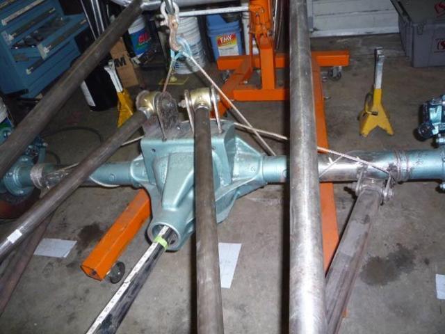

rear link brackets and flex shots
i tacked the rear brackets in place and flexed it out some to check for binding...:awesomework:

so on the rear pinon i get about a 1/2 inch swing from side to side and about 1 inch of driveshaft slip from full stuff to full droop. the pinon points pretty much directly at the output yoke on the transfer case during all movement.:cool:

Your upper control arm mounts on the rear axle...are they only attached to the cast center section?
yes and no, there is a section of steel welded to the nodular iron of the center section with nickel rod and was preheated to 600 deg and cooled slowly. then the brackets are tacked to the mild steel.
this way i can make mistakes and redo without going thru all the effort to preheat the nodular iron. that whole process was covered here a while back.
so what kinda pinon movement is acceptable?
will i have issues with the side to side movement of 1/2" total?
im not thinking the 1" travel in and out of the driveshaft will be an issue.

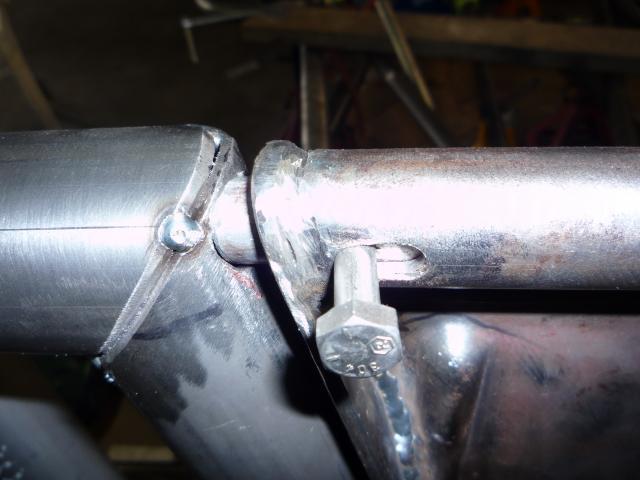

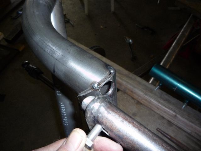

Thanks James for helping me on sunday. We bent three spreaders and i fit them about 99%.

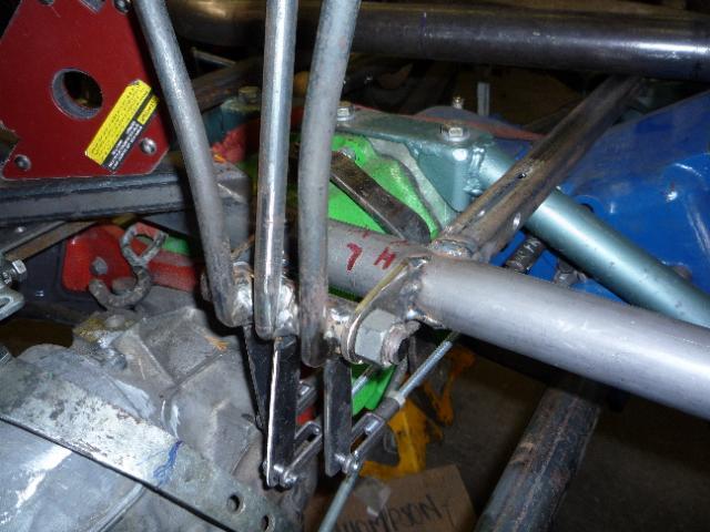

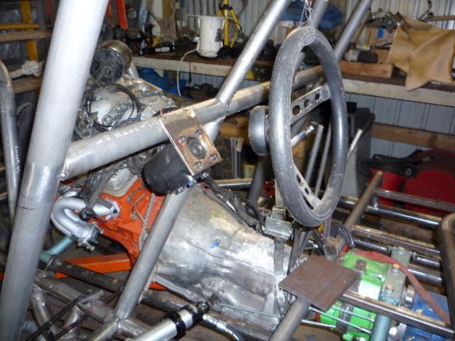

Finished off my triple stick shifter. i need to make the detent stronger for the range box. Im thinking that thing shifts too easy, might flop outa gear at the wrong time.

top spreaders

Triple stick shifter.

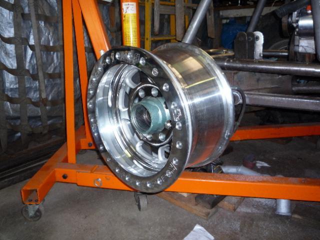

A set of 3 1/2" BS 17X8 TR beadlocks:D:masturbanana[1]:

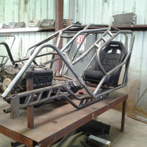

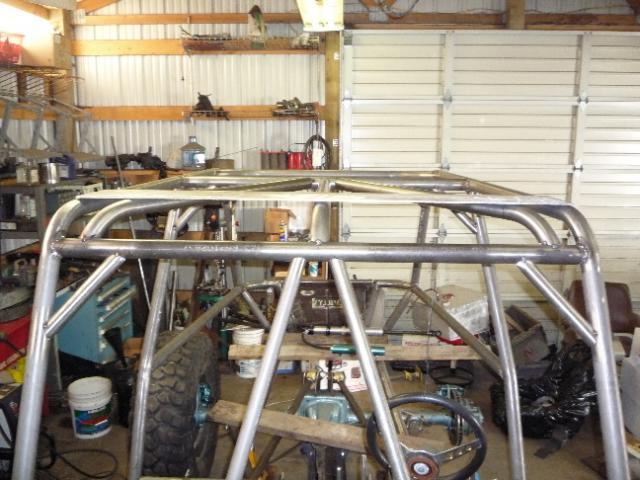

Stuck the seats in for a picture, they are covered to keep the dirt off.
