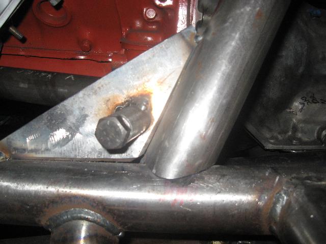

i made all the tabs to mount the shocks lower mounts.

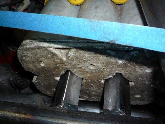

Decided i need to raise the front of the motor an inch:eeek:

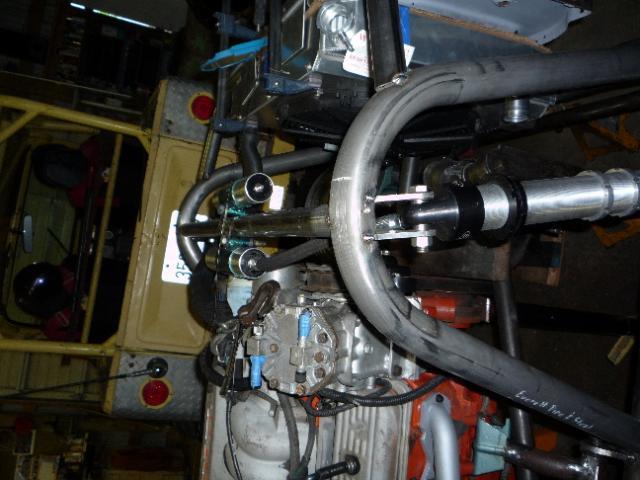

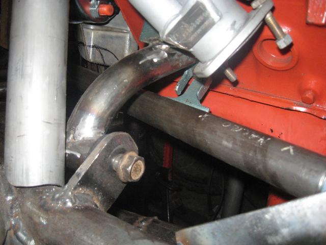

remade the motor mounts for the third time, the motor sits an inch higher in front and allows a lot more room for links..

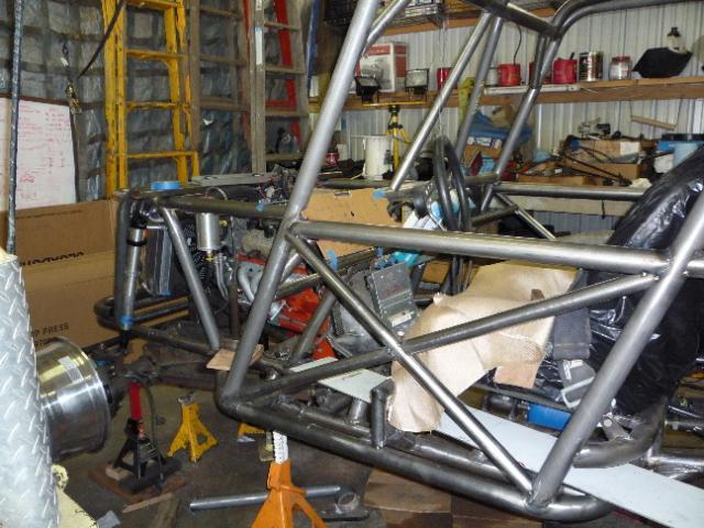

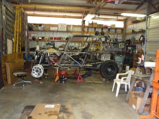

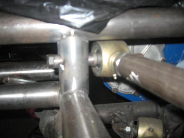

made a bunch more forward progress. remounted the seats and incorporated the rear seat bar into the upper link mounts for the rear.
moved the A pillar frame around the engine forward a few more inches so i have better feet room and incorporating it into the front upper link mount.

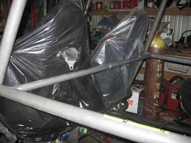

Added a bar behind the seats for attachment of harness's.

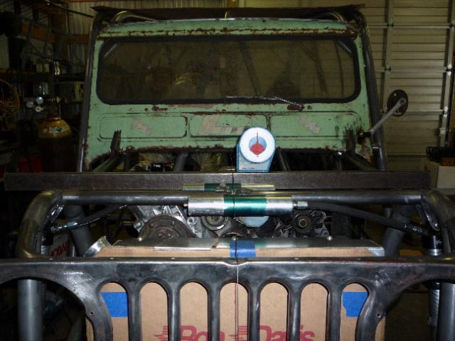

Dialed in the dimensions for the front end and rear end to be perfectly square to each other.
this weekend ill figure out the double shear mounts for the upper links.
i really need my tires to show up as im real close to having the weight on it so i can start messing with the springs.:awesomework:

right on hip,

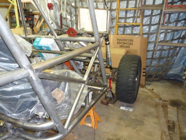

whats the word on the tires? and did you get your coil over issue resolved?
havent heard anything about tires yet, the coilovers issue is resolved. it appeared they put in a few too many ounces of oil. jason took the fitting off and we compressed the one all the way and put the fitting back on. compresses fully now.
S&N loaned me some coils that we think will be about the right rates. as soon as i have the coilovers mounted i will be able to weigh each corner and actually get the spring rate i need with out having to buy/trade more than one set.

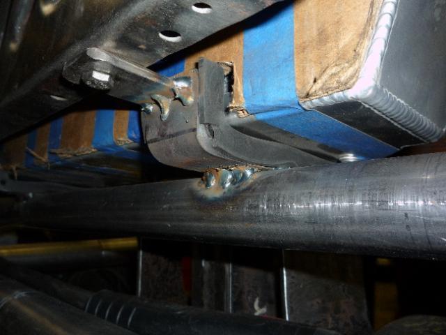

made some parts to mount radiator and grill.

i want to engrave a logo and all the original whilly info on a valance plate which will also hold the top of the grill and the radiator all in place. kinda like an oem plate only mine. ohh i got my camera back all fixed.

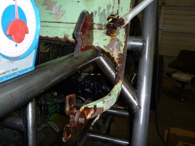

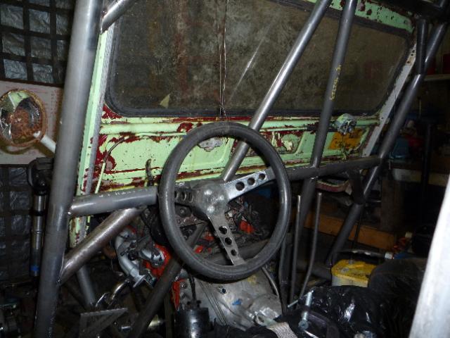

Set tne windshield frame in place. im gonna make an entire new one with a much bigger windshield but all the latches and attachments should resemble the willys style.:D

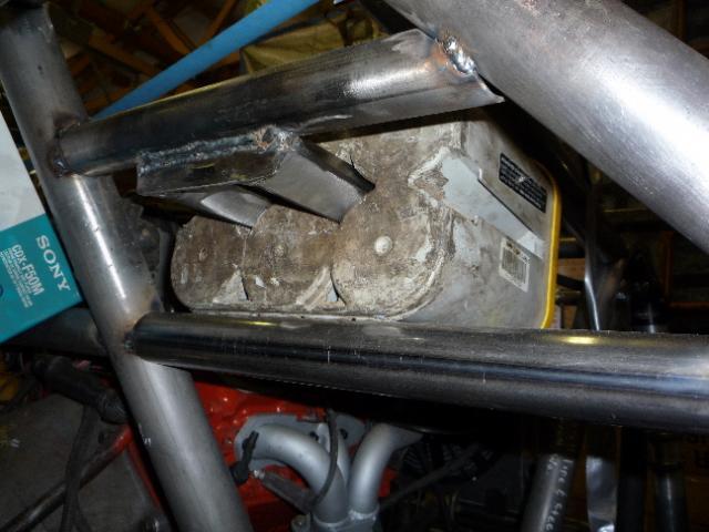

made a battery mount base, ill make the holder part later.

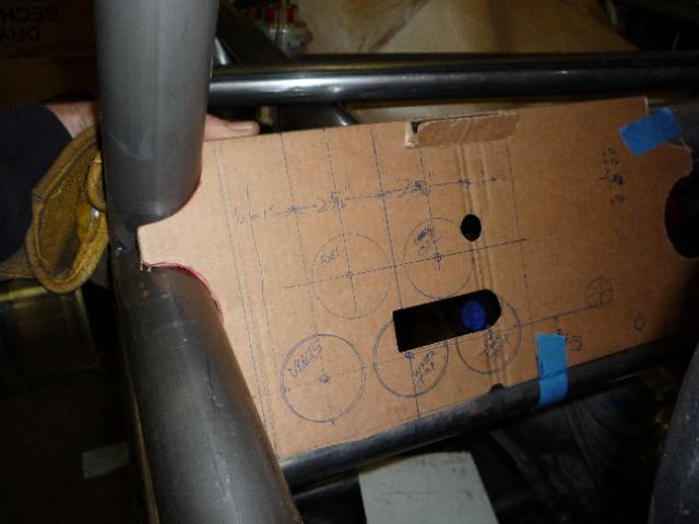

Template with some gauges drawn in.

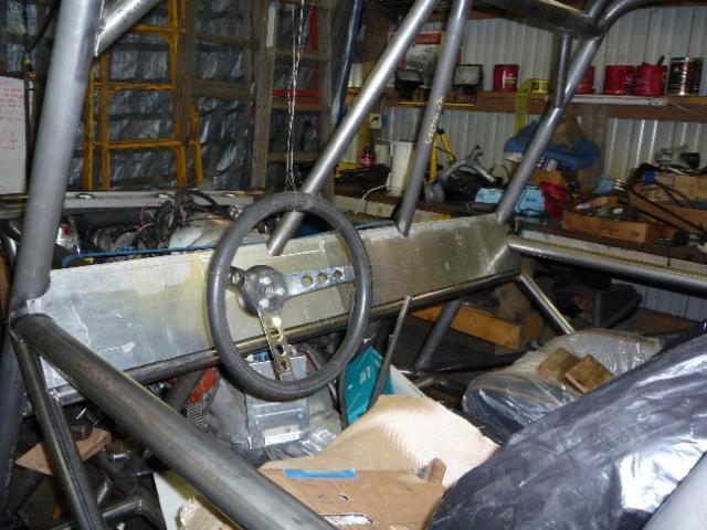

My plan is to have the dash where the orbit valve and pressure gauges are to be, sealed from the passenger comp. so if i ever have a leak i dont spray my legs with hot oil. The rest of the dash will be for electric crap and the marine CD player.
Dash in place.
