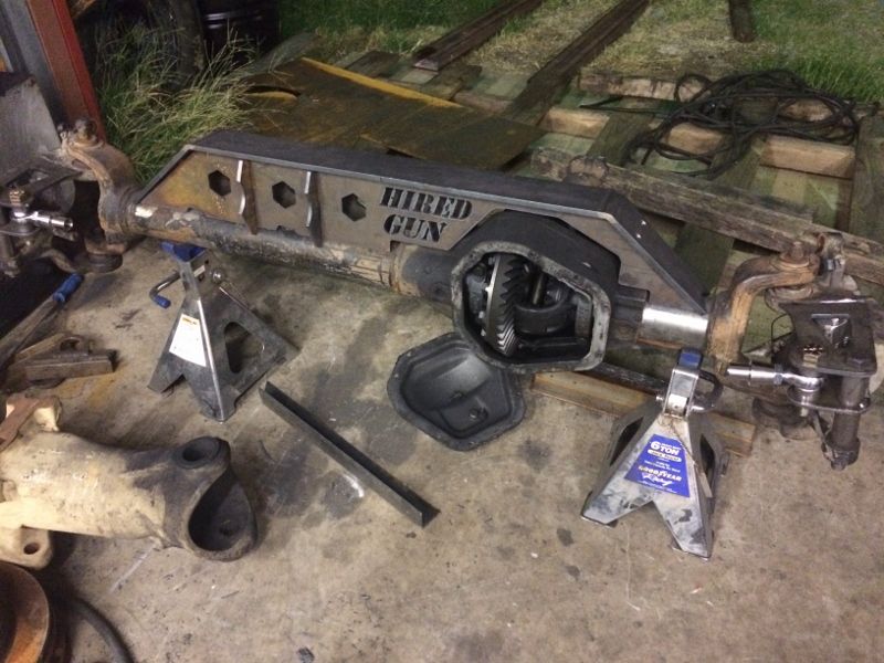

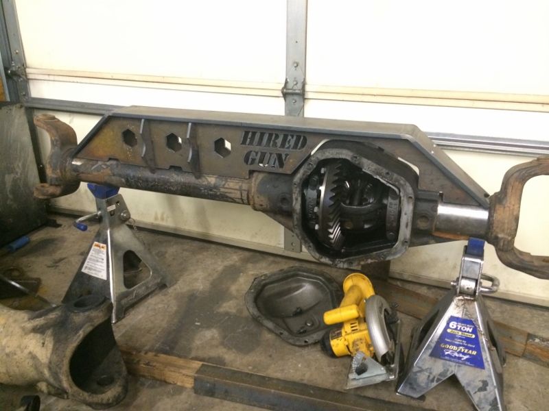

I built this for a guy

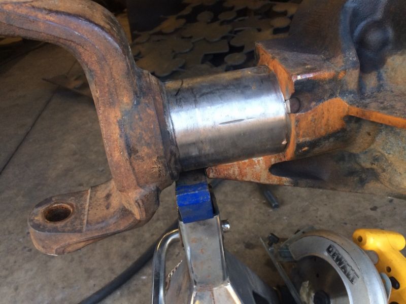

I guess it can be our secret haha. I would say the pain in the ass is cutting all the cast stuff off but other than that it's a no brainer over a old school 60.
