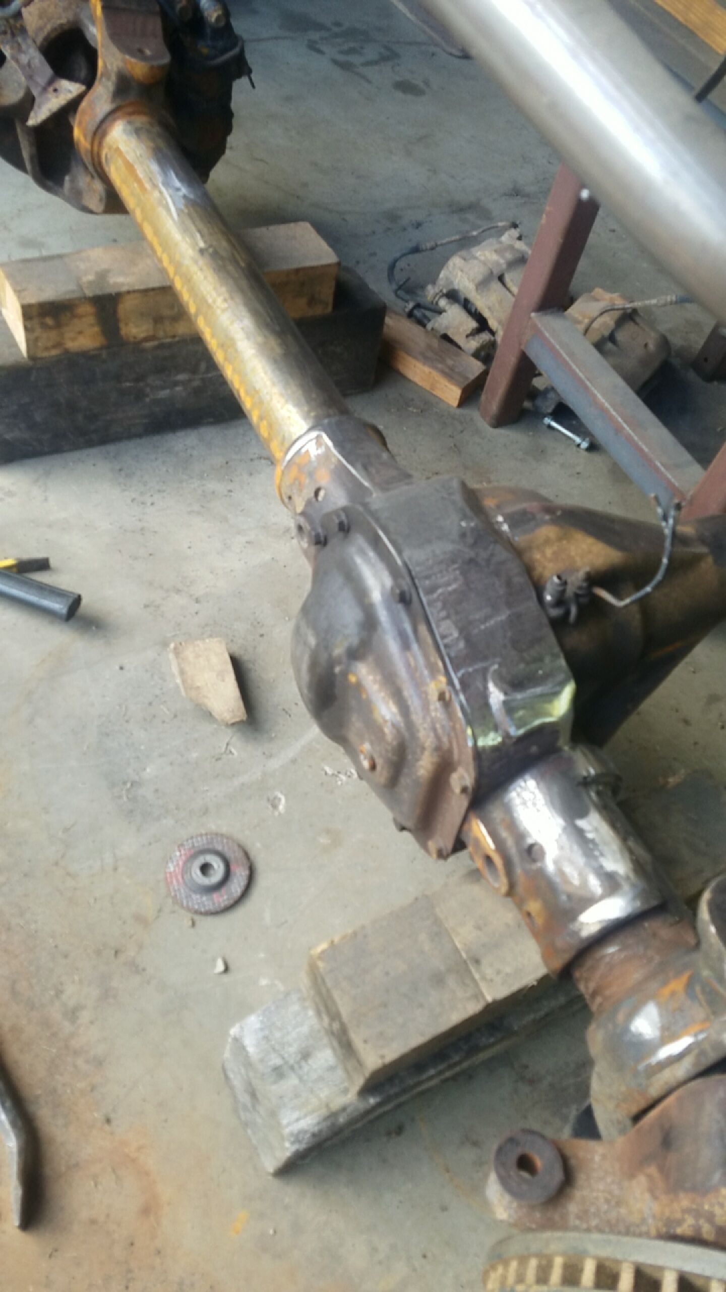

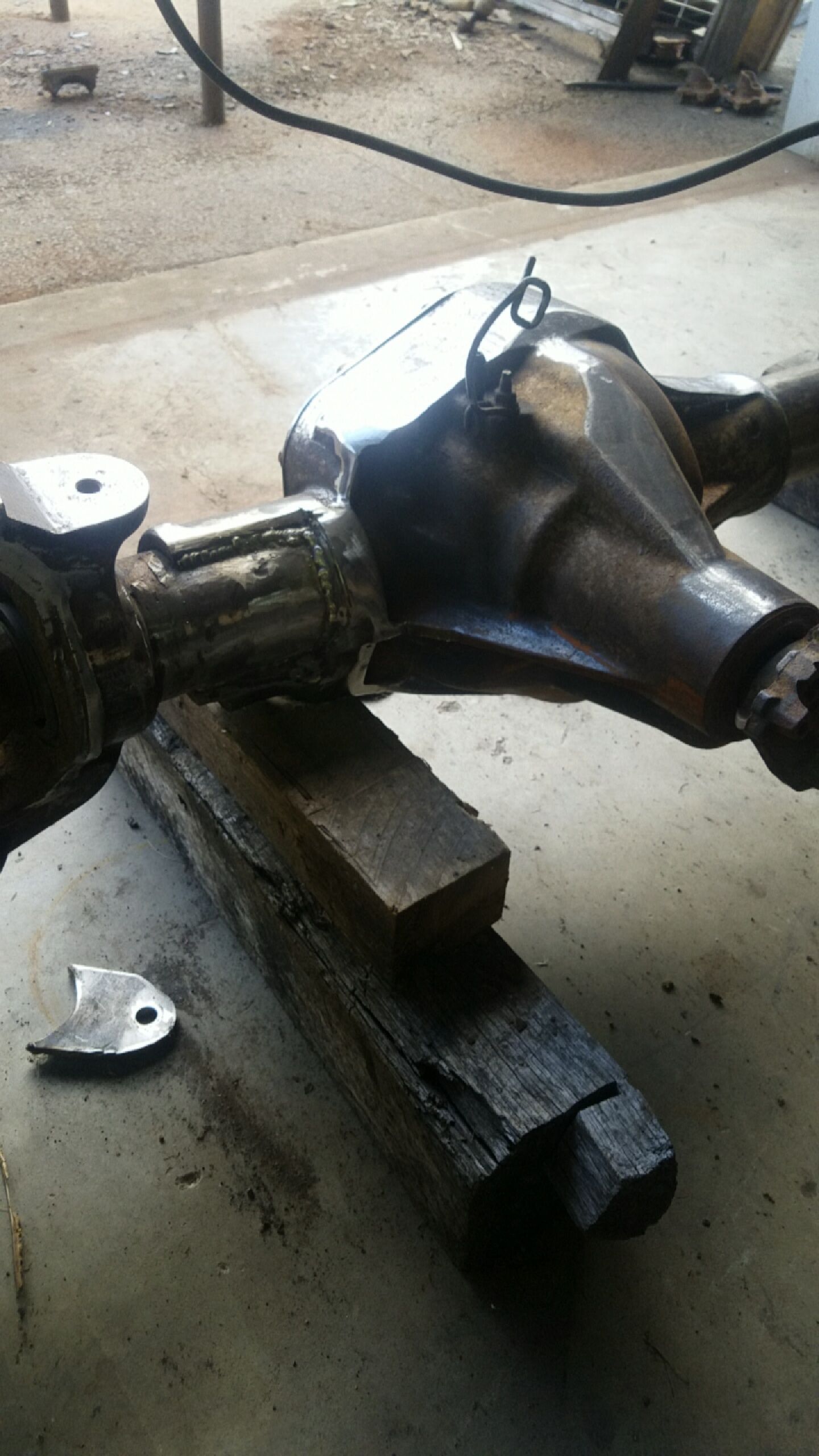

Finally got mine all cleaned up and ready to work with..

whiskeymakin said:
I guess it can be our secret haha. I would say the pain in the ass is cutting all the cast stuff off but other than that it's a no brainer over a old school 60.
You got that right. Fawk I hate cutting stuff off of them.

Back to the original quesrion lotus had as far as mounting the links, I did similarly to others with cutting the housing but kept it to a minimum. I then tied the link tabs back up to the truss. Tabs and bracing all 3/8".
Of course then I had to make the passenger side match.
