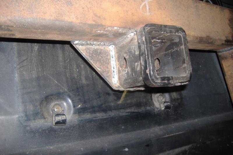

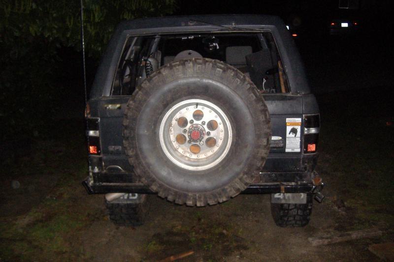

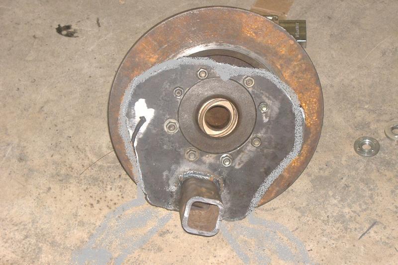

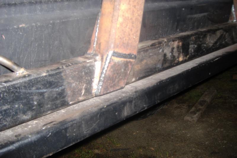

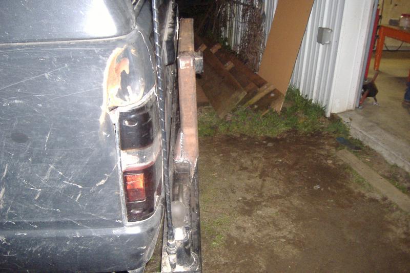

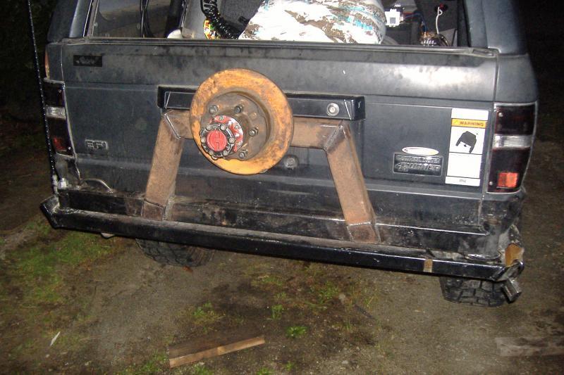

so this weekend i got some time so i went up to hips and got some work done on my spare tire carrier
it's still not 100% finished but it is ubber close:cool:

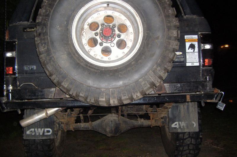

more:beer:

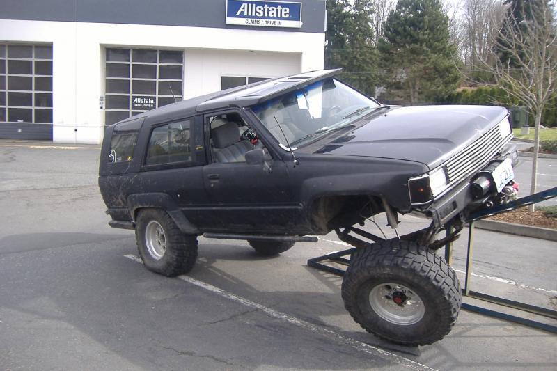

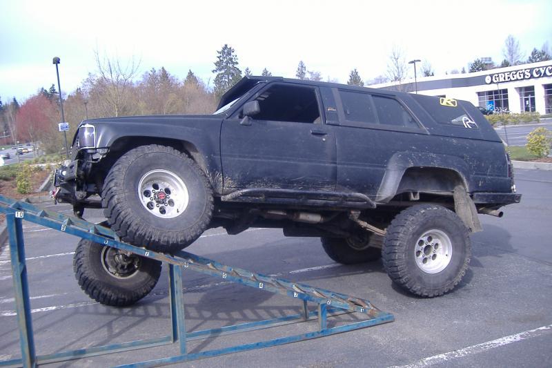

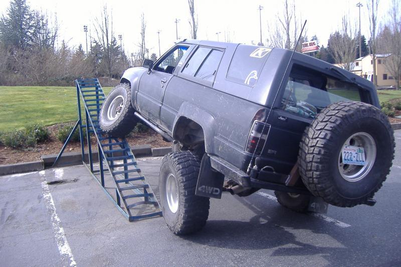

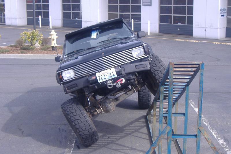

mall crawlin 4wp style:beer:

you betta throw some strongbacks on the plate between the 2x2 tube and the spindle mounting area. If not the weight and force of a spare will bend it in no time.
since i am not working at the moment the next thing on my list is to lose the down face front bumper:masturbanana[1]: or lack there of
:awesomework: deff going to do just that. the plate is 3/8s but i plan on welding some stiffeners on the back either some 1x square tube split in half or some angle which ever i can find enough of in the scrap pile.

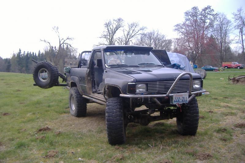

i am also going to mount my high lift behind the spare tire and i was thinking about making a support bar that goes from the highlift mount to the back of the 3/8s plate with pins

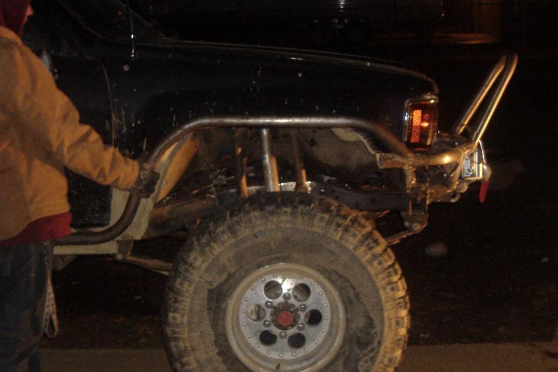

need to finish my front bumper and put my damn shocks in the rear before the weekend, saturday she's hittin the trail for the first time:masturbanana[1]:

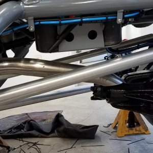

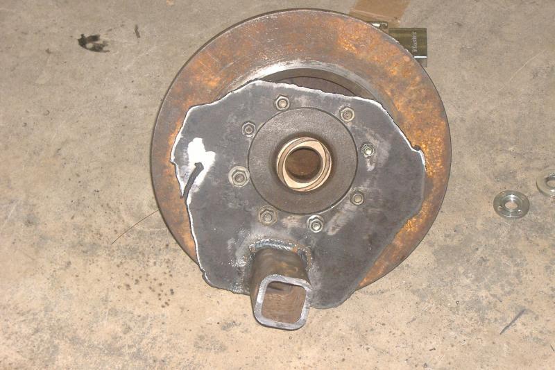

tube:stirpot: much much more to come:cool:

got some new rubber yesterday!!! got my old 37x13.5x17 interco SSM16's :cheer:
got a new spin tech muffler:cool:

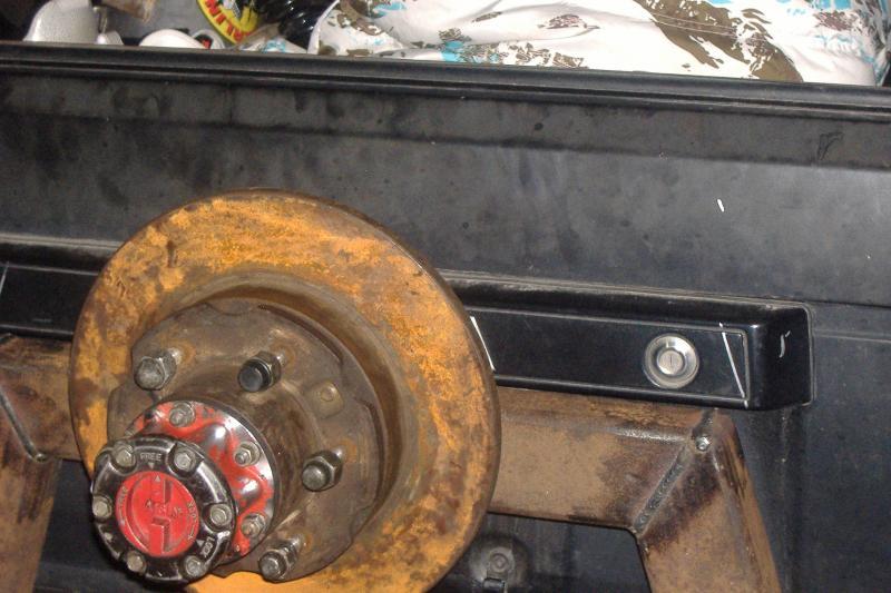

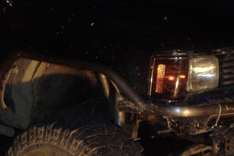

today i spent a few hours at the hipsters clearencing my fender wells
tomorrows plan is to finish welding the tin back together
fix/finish my trac bar mounts
couple other odds and ends
