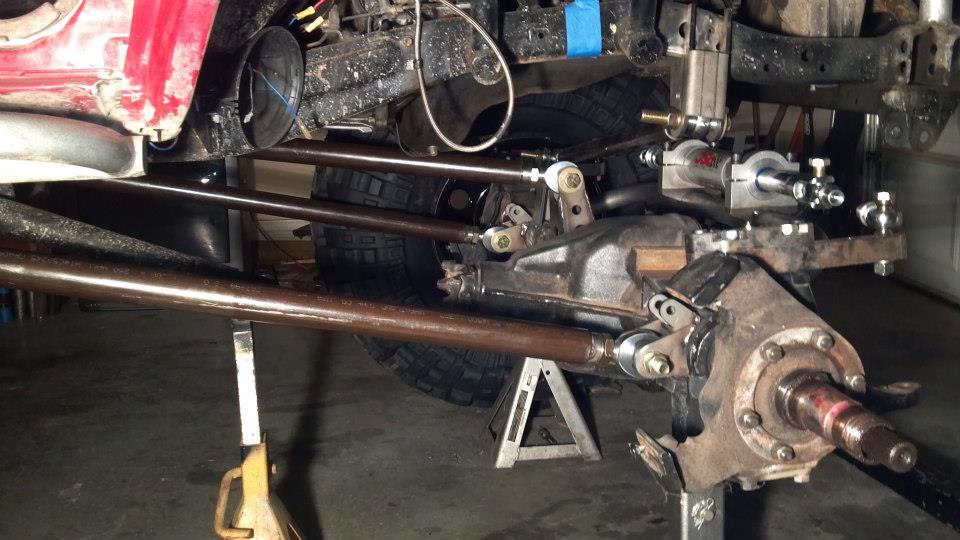

These pictures are from a long time ago but IMO for a crawler i loved my 3 link and had no problems with it. Just my $.02
