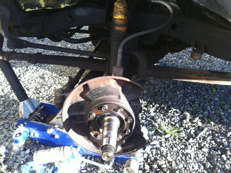

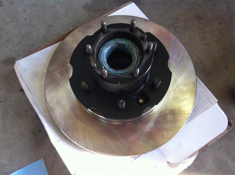

Ok, been fixing this thing up good the last few weeks, mostly cleaning and inspecting things and making sure all is good. After I got everything electical working good I moved on to the mechanical stuff. Started by draining all the fluids and replacing with fresh and now I am into the front axle and brakes. If I can find parts faster then I think I might do the power steering swap sooner rather then later but as of right now I dont mind driving it manual.

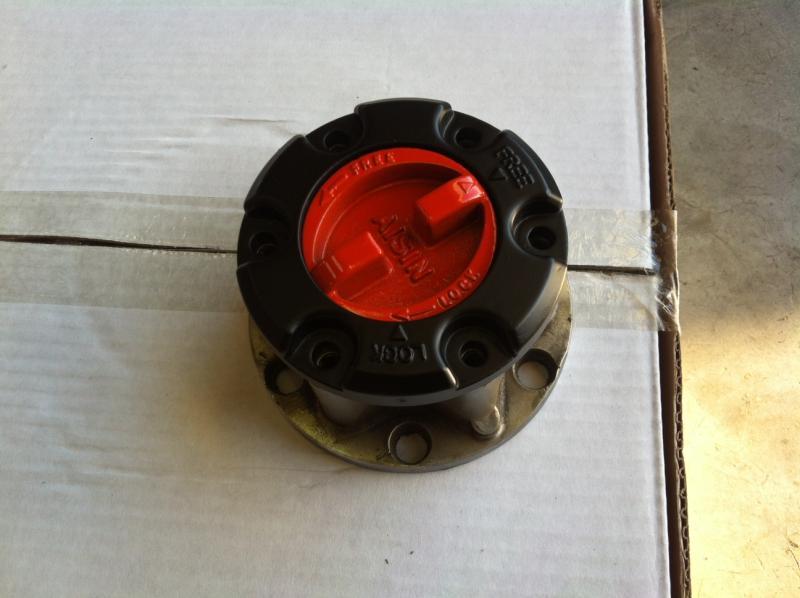

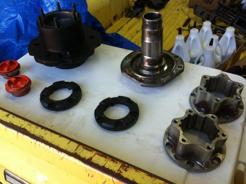

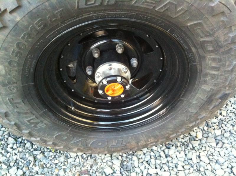

Thanks to Chop Shop for the tech info, I am swaping front brakes over to a vented FJ60 rotor and a newer 2nd gen 4cyl caliper. Taking the time to clean and paint things that are rusty and lube everything with new grease. I plan to pull the knuckles off and to inner axle seals and longfield wipers. I am also in the process of doing the wabfab hub refresh myself.
Oh and I am painting these nasty wheels all black! :awesomework:

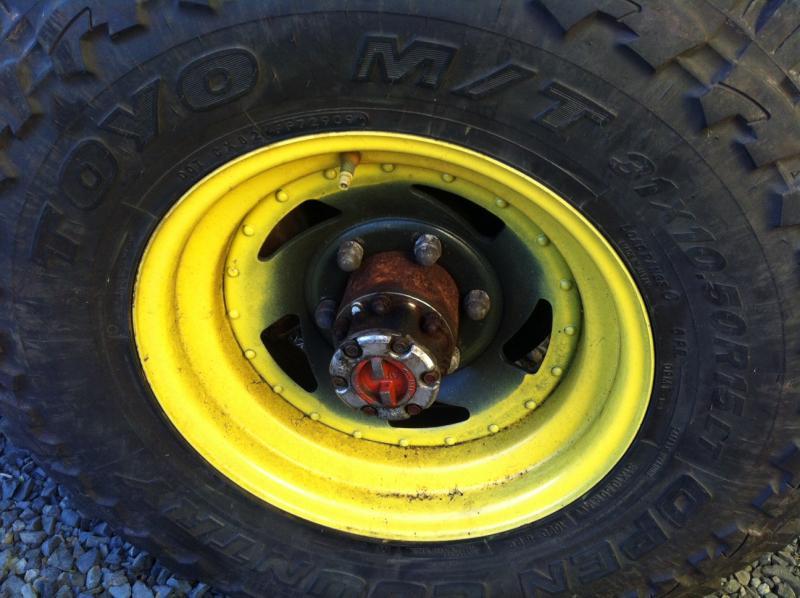

No no, Im doing them myself. Just kinda fallowing his steps. Not much too them at all, just cleaning and relubing everything. They had froze up on me in the FREE position. The O ring was all nasty and kinda acted like glue. I did order new O rings and sring and detents (I lost one, went shooting accorss the shop:mad:) from Marlin yesterday along with all the other stuff.
Also, what are the main hub bodies made of? Are they SS? I got a bit of rust on them and cant get a wire wheel in there to clean them up. THinking about sand blasting them then a quick coat of clear.

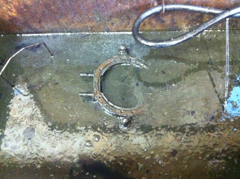

I got a leaky rear half moon on my head, kinda noticed it when I was under the rig doing fluid change on tranny. It drips when truck is running. Gonna have to look into that. Im assuming this can be done with relitive ease from under the hood? I already had the VC off to do a valve adjust. Not sure who rebuilt the motor but he was not a very good motor guy.
They come in the valve cover gasket kit. I usually apply a thin film of silicone to the half moon

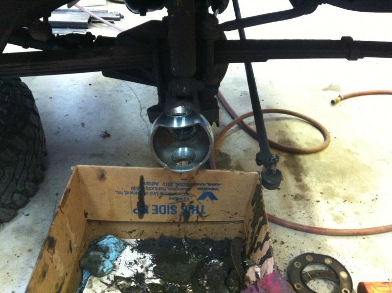

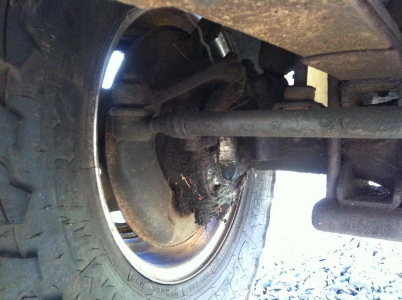

Got a little more dont last night, the cleaning really sucks thats for sure. Im not used to this barfield/closed knuckle crap! Im waiting on parts to show up so its a good time to clean everything up and do some painting I guess.

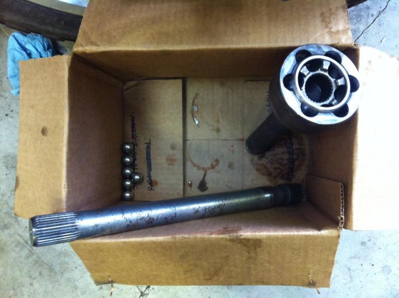

As for repacking the birfs and bearings im assuming any bearing/multi purpose grease will work. I dont want to start a Tranny Frank thread fight or anything just making sure I dont need anything speacial. Of course what was in the knuckle looked like someone ate at a taco truck and then **** through a screen into my knuckle. I have that blue marine grease I always use on bearings and stuff so I assume that is ok to use on the birf? Also, if anyone wants to take the time to teach me the right way to repack a knuckle/birf that would be cool too. I dont think the knuckle has to be packed full of grease does it? Just the birf and the trunion bearings?

Dont pack that knuckle FULL.
With Marlin seals and Bobs wipers, you wont want a knuckle full of goop.
JUst pack the bearings with your blue goop. The birfs like a MOLY grease.
Easiest way to pack,,,, trunions, by hand. The birfs, take a spring bushing that will press into the birf star and will fit a grease gun tip and pump it full.
If ya know someone with a broke inner axle shaft, you can take the broke stub end (or if its broke at the fat end cut off the other end about an inch long) and drill it and tap it for a zerk fitting. Then just press in the axle stub and grease the zerk till grease comes out all six ball grooves.

Hubs are NOT stainless, just normal steel. That rust wont clean up completely. Its from folks running those chrome hub ring/trim center caps.
