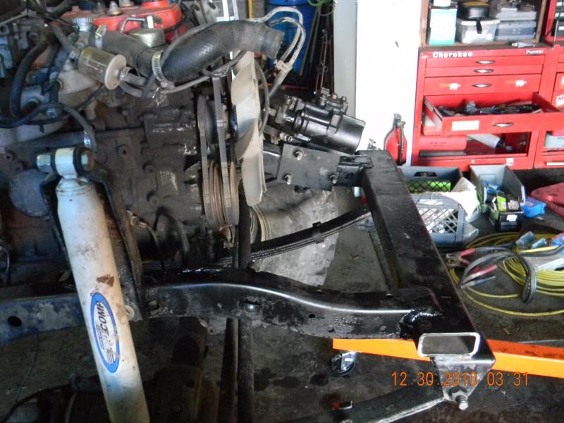

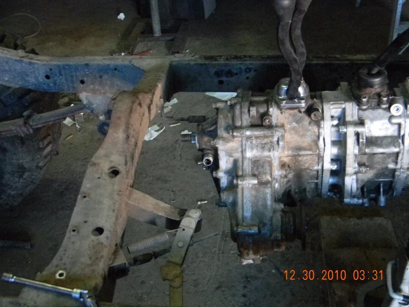

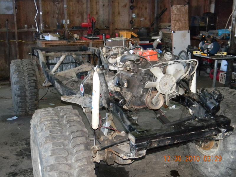

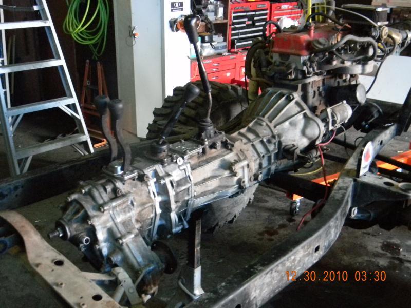

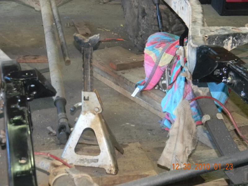

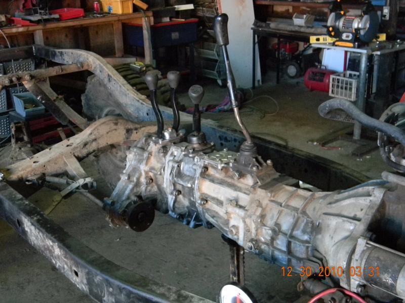

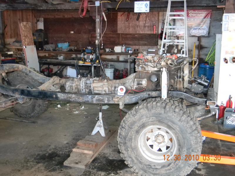

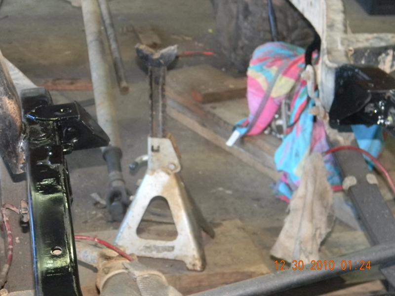

i installed the new motor mounts and got the engine back in and moved back 8 inches to make more room for the winch and radiator...also got the dual cases connected to the transmission now... next will be the crossmember and i can start laying to floor bracing....here are some pics of the progress

Lemme get this correct... you moved the engine back & dual transfer-case'd it?
You are going to have a LOOOOONNNNGGGG front driveline.
Nice....its lookin good.
I can't remember if I moved mine 8 or 10 but it definitly helped.:awesomework:
no i am going to have 2 front driveshafts... a flat one along the case and part of the trans with a carrier bearing then the second shaft drop down from there to the front axle.
if you don't know what i am talking about look at most of the f-toy builds on pirate4x4

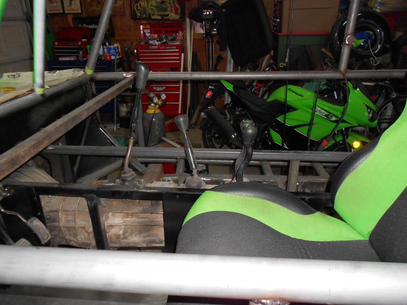

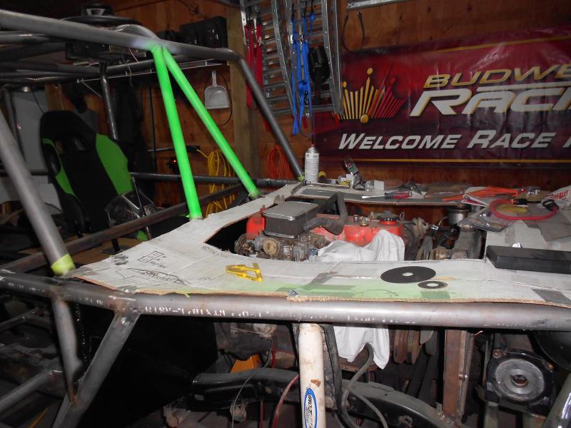

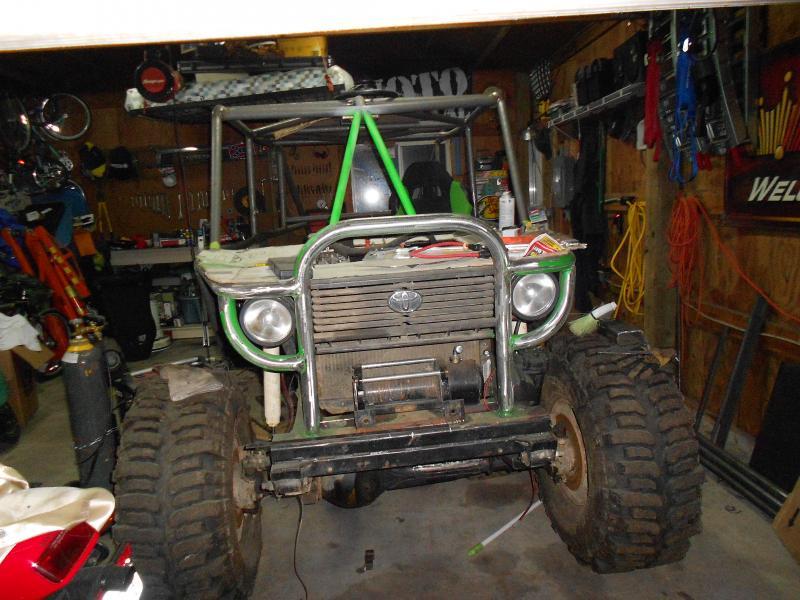

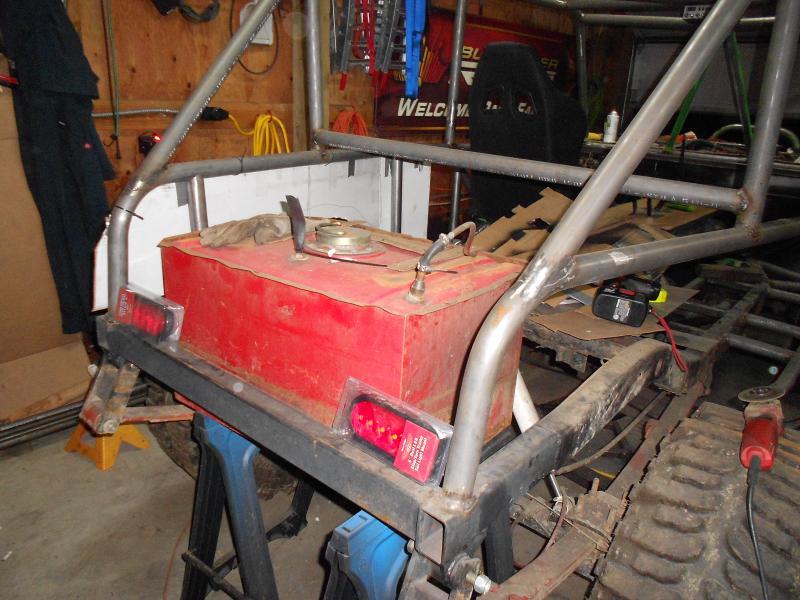

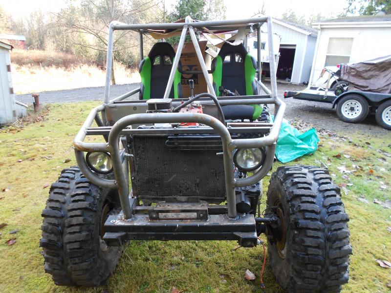

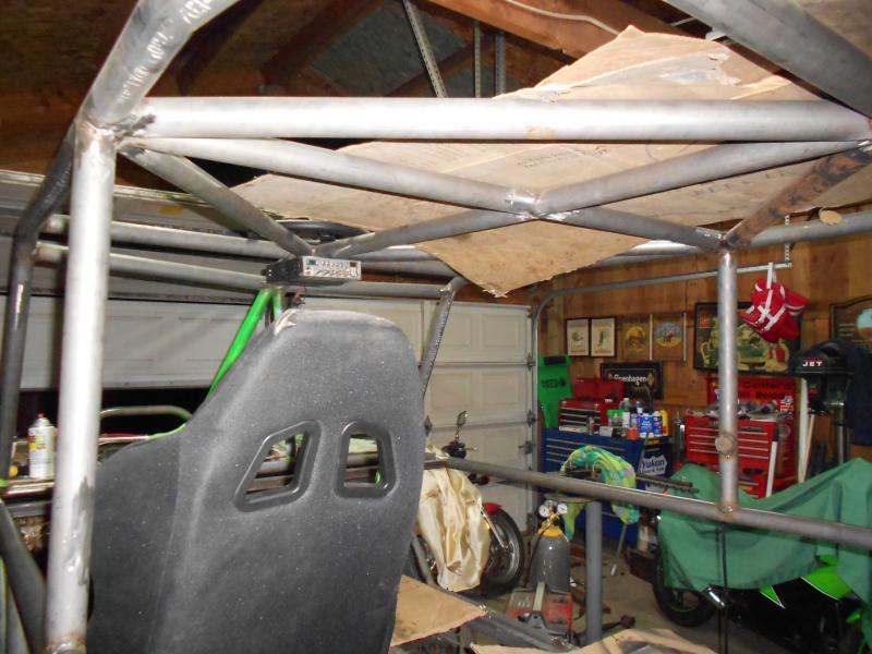

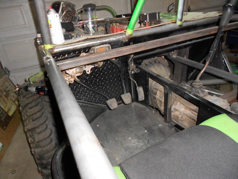

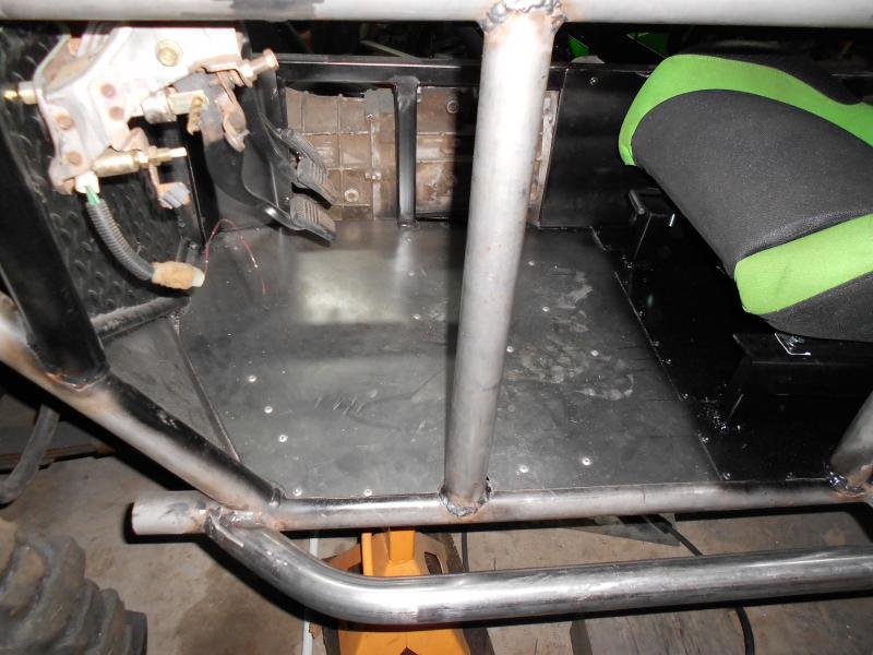

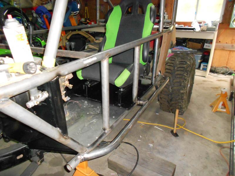

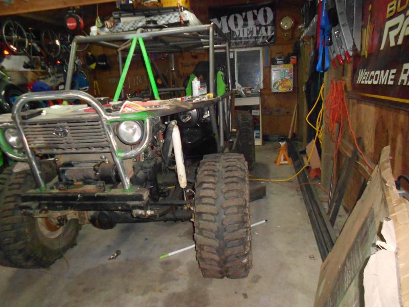

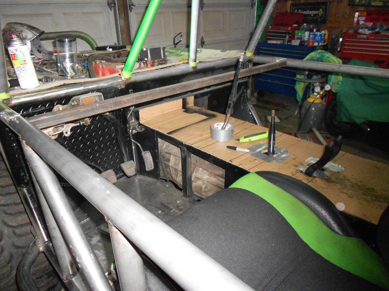

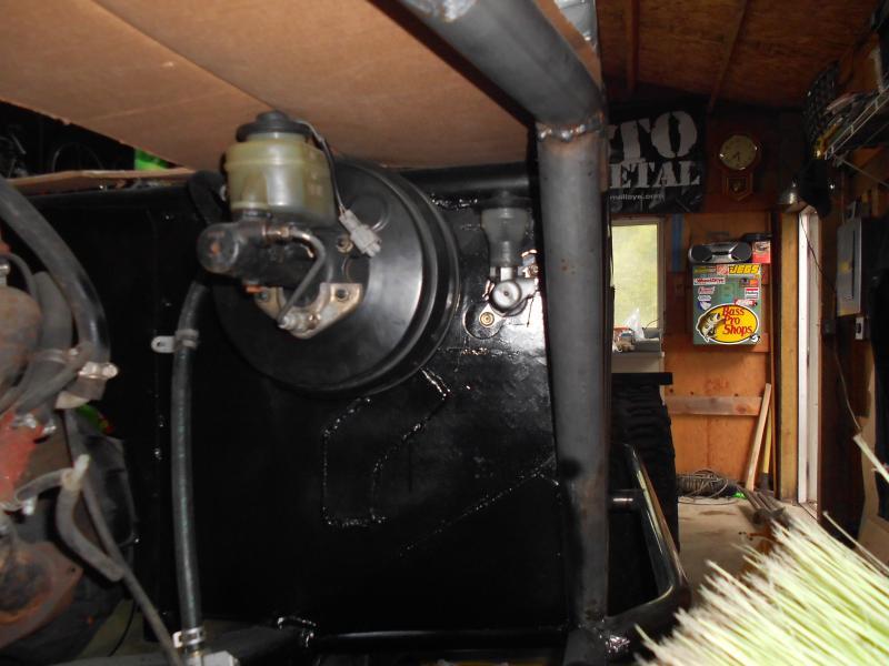

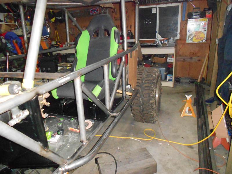

Man time has just rolled right by. I have moved shops and at some point i stopped taking pics so here is a jump to current
Pics in a minute

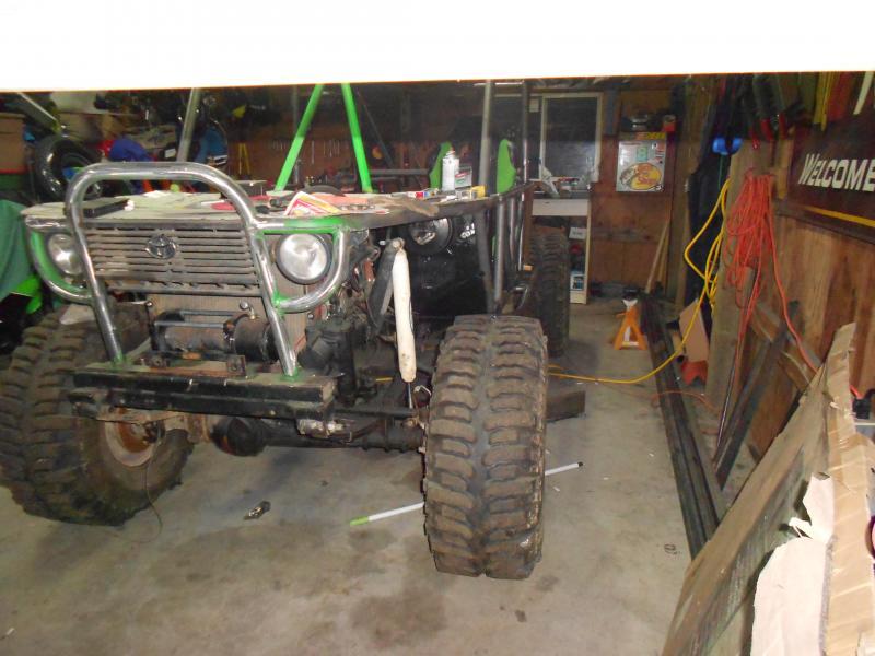

the front is only as wide as the stock grille

:thud: hot dam.... I wondered how this project was going.... that thing looks like a tank!!!!
Keep it up you will be wheeling in know time....:awesomework:
