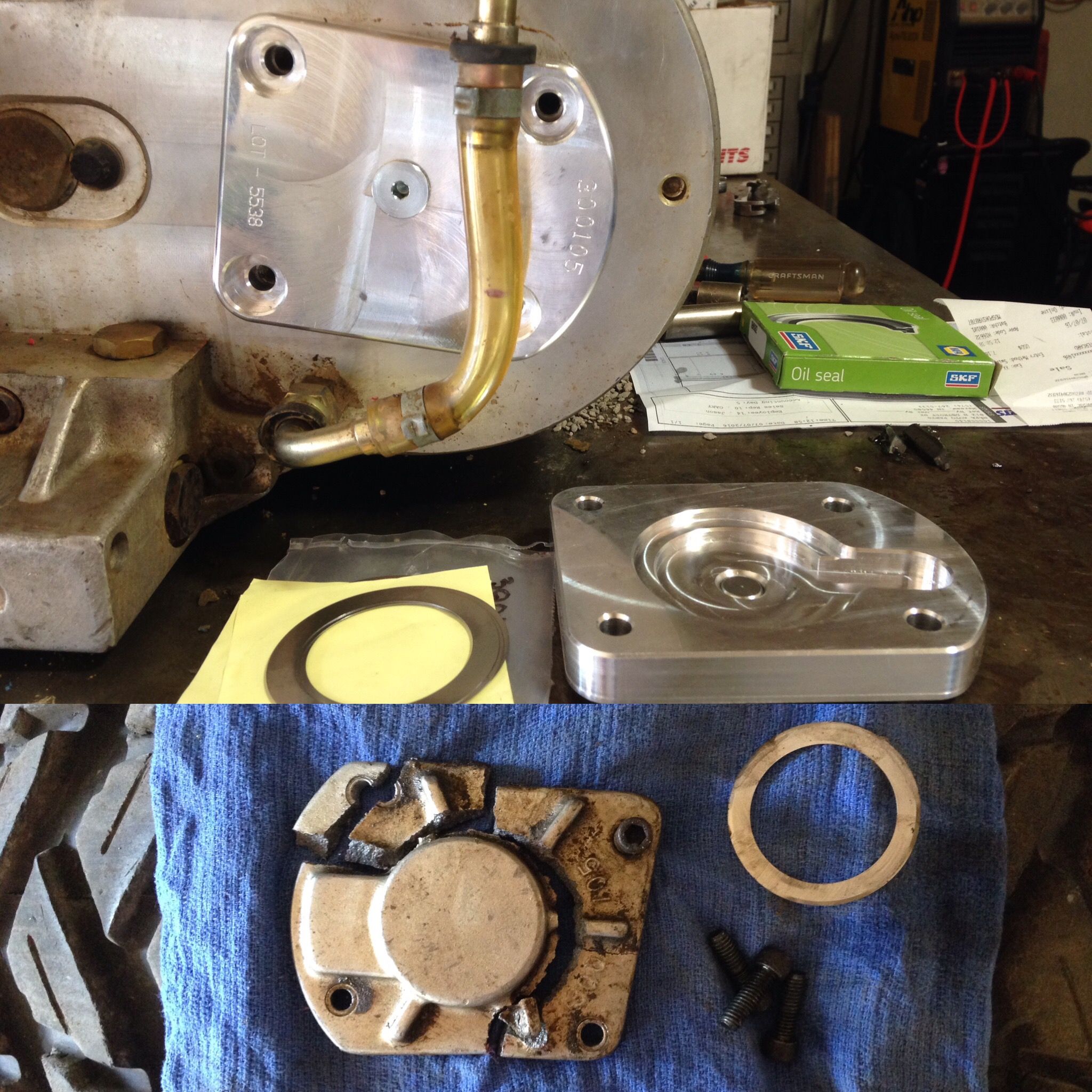

The axle is fixed now. Knocked it out wearing my fancy hat. Ain't you got some corn dogs to cook?

NWF also offers an ECO box starting just under $800. Builder sources a 231 or 241 for the ring gear and planetary. Install those into the supplied NWF billet housing and add you favorite 205. I have a buddy running one it's a nice unit. I have a pattern to make a doubler plate using a 231/241 case half. The main shaft that everyone tosses when dong a slip yoke eliminator can be turned and resplined. I had Hudlowe Axle do it for me then hardened. I wish I had the resources to make multiples.

I stinkin love mine. I'm glad I chose to go the route I did. 7.42:1 is the bomb along with my brakes being able to hold that ratio at idle
