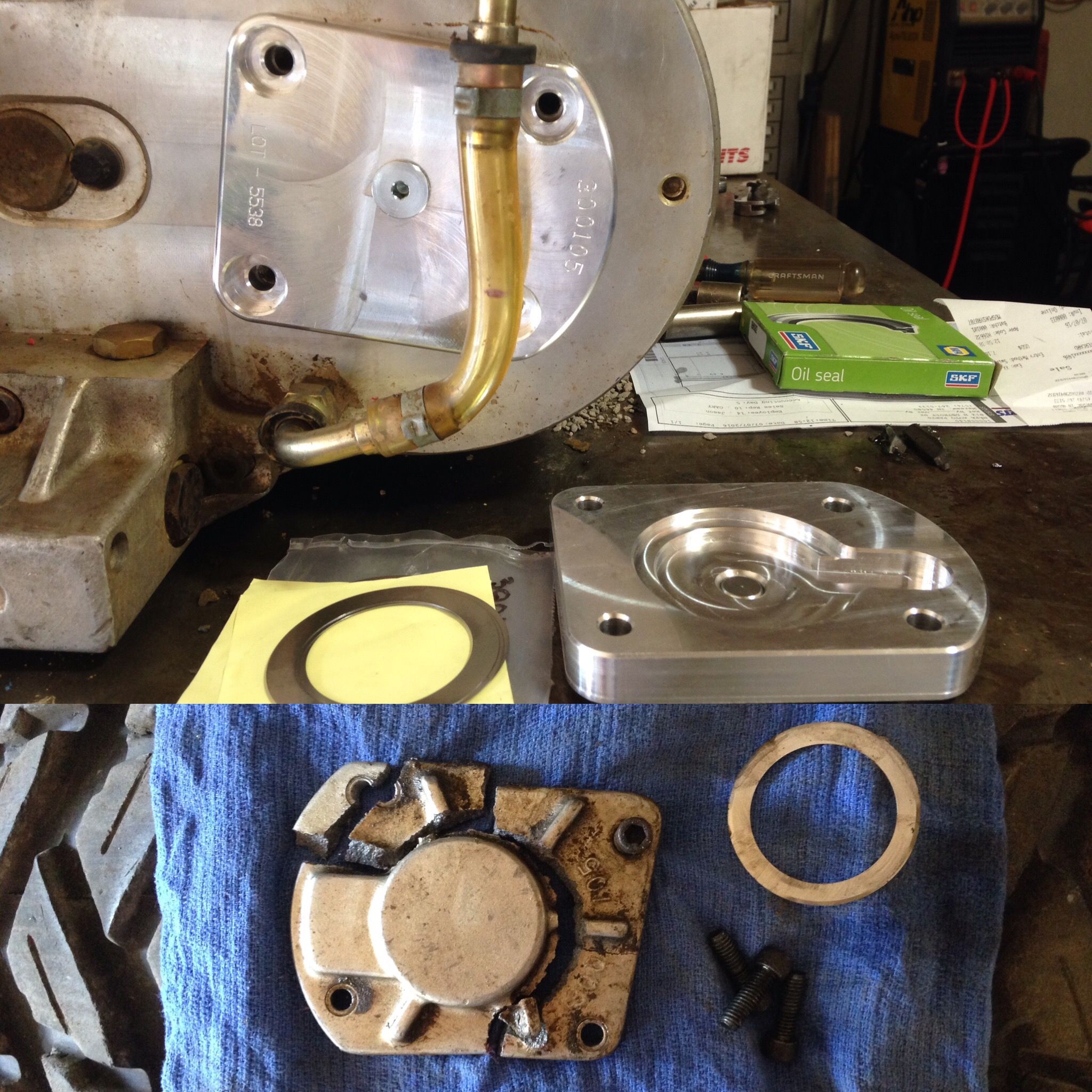

Landed on the gas last year and punched out the crappy cast bearing support and took out the gears last year. Watched Stan Haynes that owns Branik take out the gears in his landing on the gas at the last RBOR race a few weeks back.
Spend $40 and get the billet cover from AA if you have that crappy cast one.

good to know, thanks I'll have to check mine
