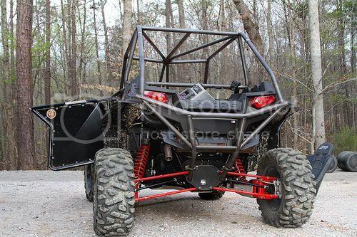

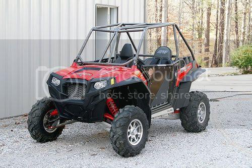

I think im going to base my cage off this one, Its the best looking one ive seen imo
We are noticing a huge movement to the Side By Side market, and after playing some on these thing they are really cool pieces of machinery. So, we decided to dabble in building a few products for them.
Pictured above is the cage we proto typed for Brit Mansell of Octane Racing. The cage pictured there is 1.5x .095 wall 4130 Chromoly tubing. We chose to go with this to save a little weight but it just looks so much better. I'm glad you guys dig the look of it. We offer it in a few different versions of how we build it here. http://www.wideopendesign.com/Product/207/Polaris-RZR-XP-Cage.aspx
We are also building the 4 rear suspension links for the 900 XP out of 7075 1.25 aluminum with 5/8 rod ends. They looks supper clean on the rear and on test vehicles they are holding up great.
We also have a set of A arms that Brit is testing for us on his XP now and they should be released soon.
Any thing else you guys would be a hit on the market let me know. I've had a blast playing with building this new stuff for them.

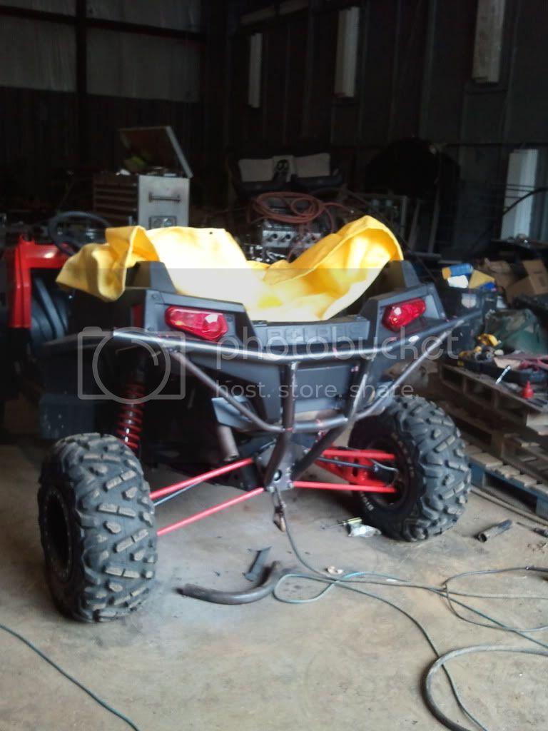

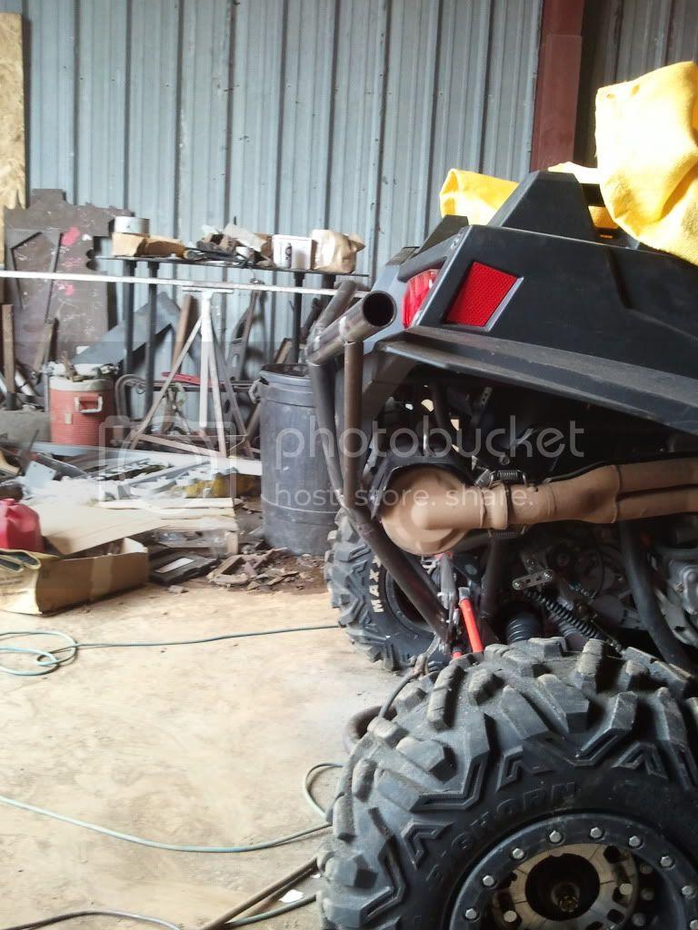

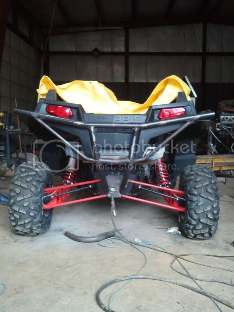

Got the bumper built. Hopefully my bungs will come in so I can do the cage this week
