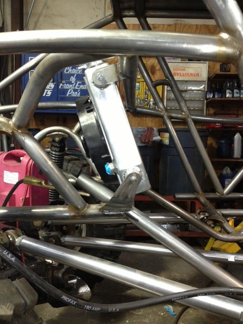

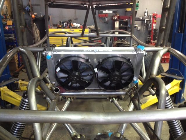

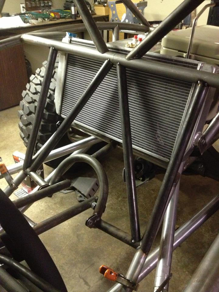

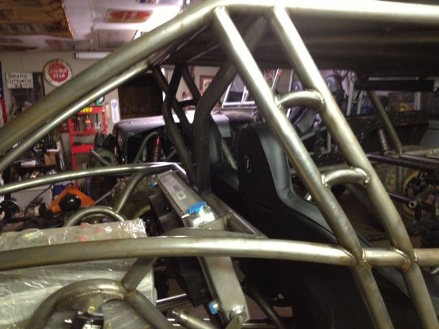

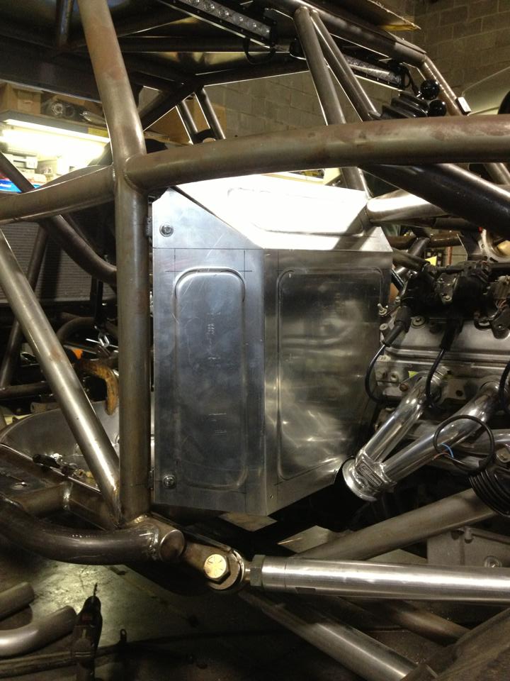

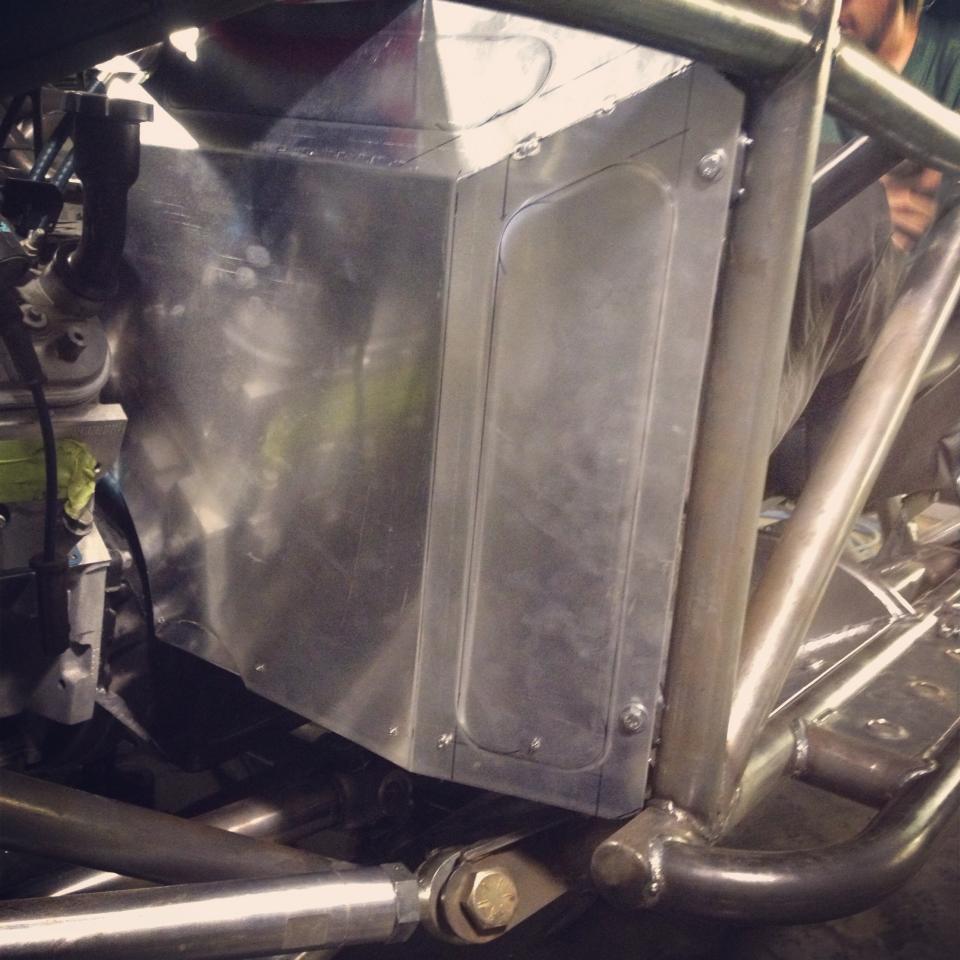

radiator mounted

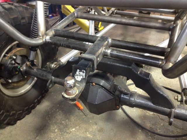

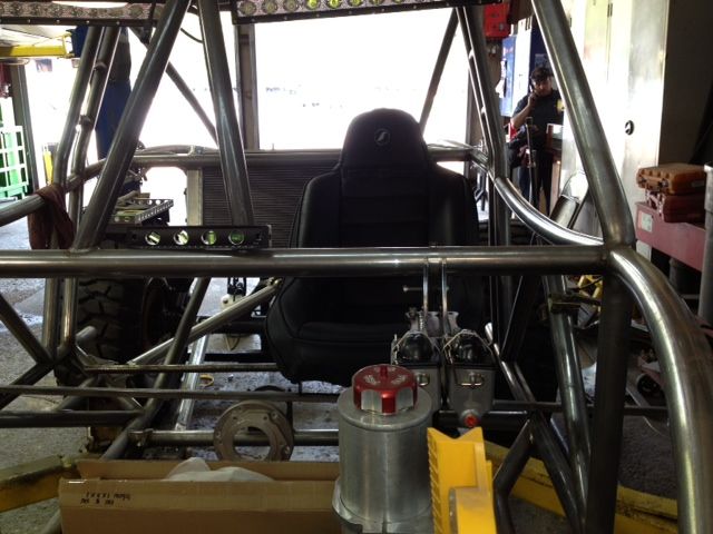

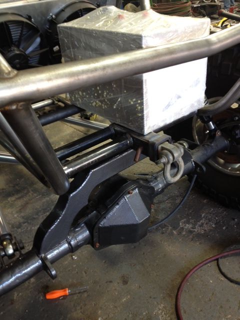

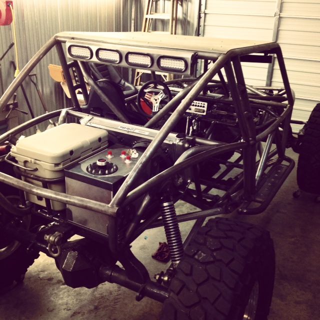

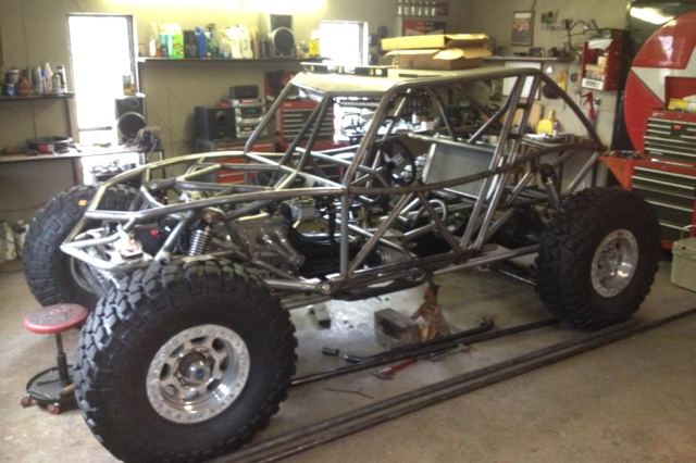

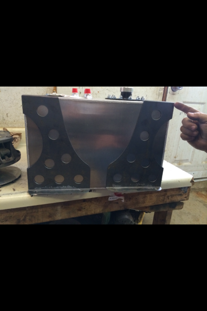

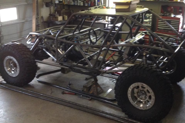

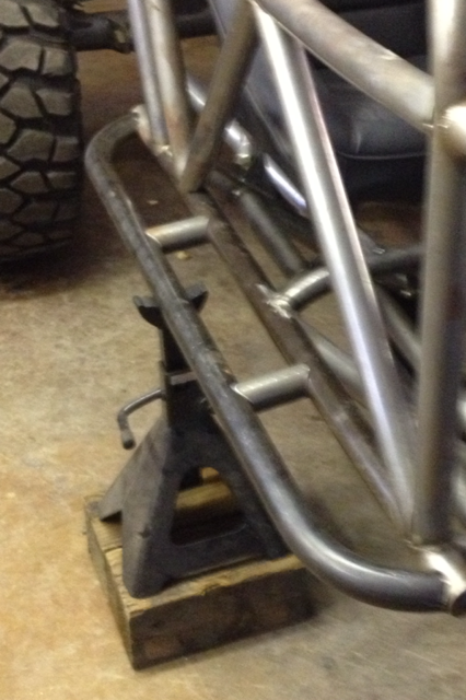

Worked on the rear a little yesterday. Run some .250 between the rails for support and to hold the fuel cell/tool box. Went ahead and put in a receiver for a recovery point or to hold a basket if I need to haul some camping gear.

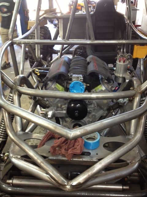

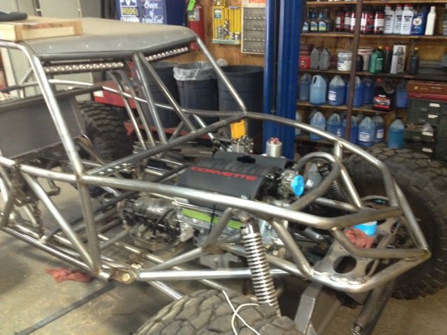

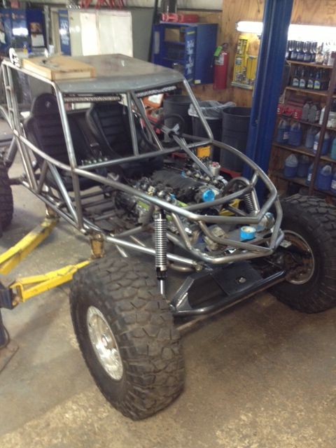

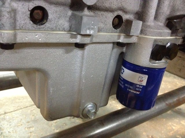

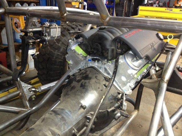

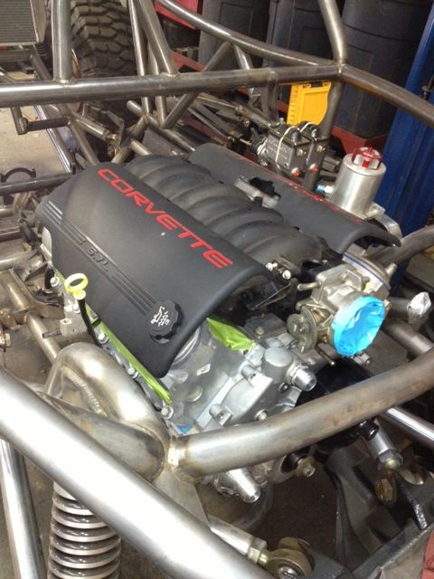

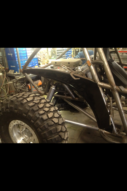

Ive done a little work on her. Been very busy at shop but hired another hand so things are slowing down a bit for me. The motor is back from builder and sitting in chassis so I can mock everything else up. The Mast Motorsports pan fits awesome, real tight and close to skid/tubing. The front of motor will look clean and simple with the WOD AN thermostat housing, real easy to plumb to chassis. Still looking into headers, cant decide.

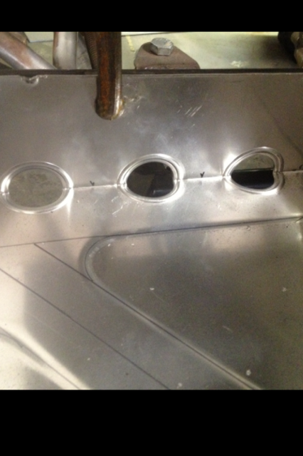

I really like the fact that with this pan and the way Woodlee built the engine skid you wont have to remove the skid to change oil and filter. Nice to not have to run a remote filter either....

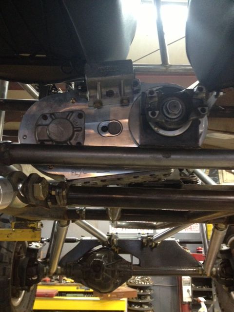

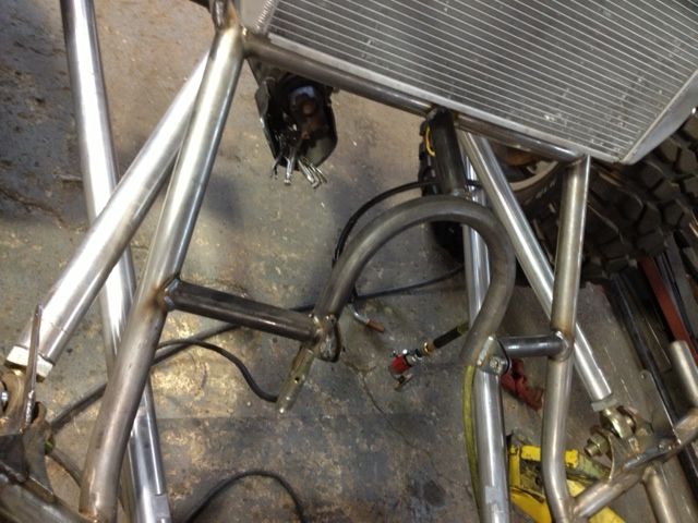

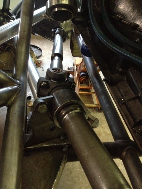

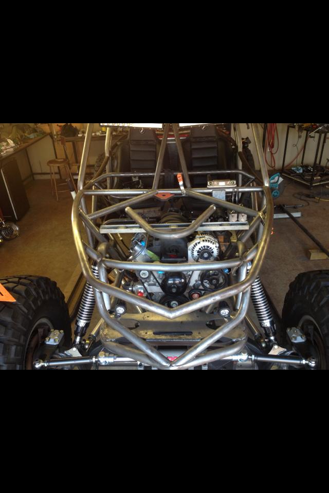

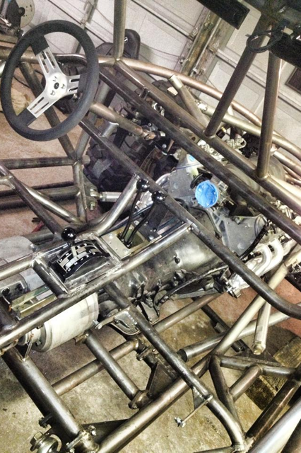

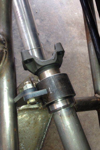

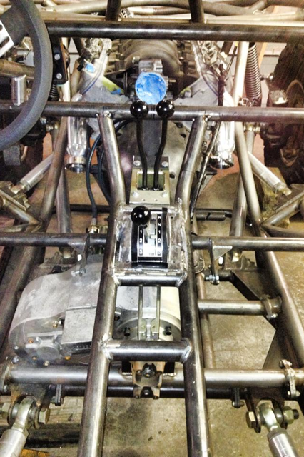

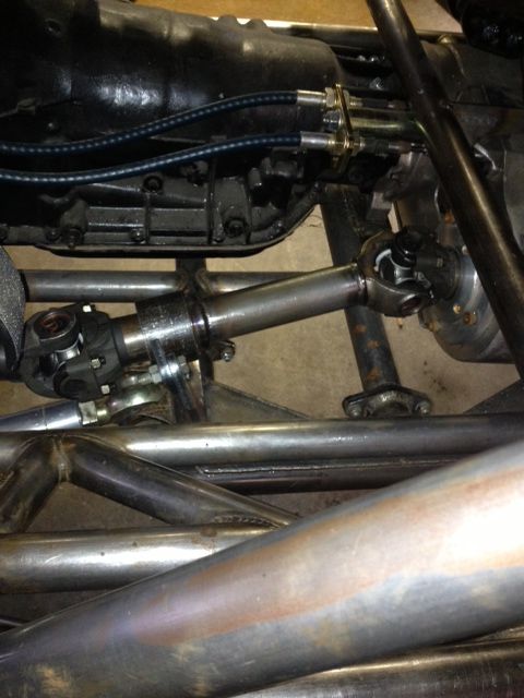

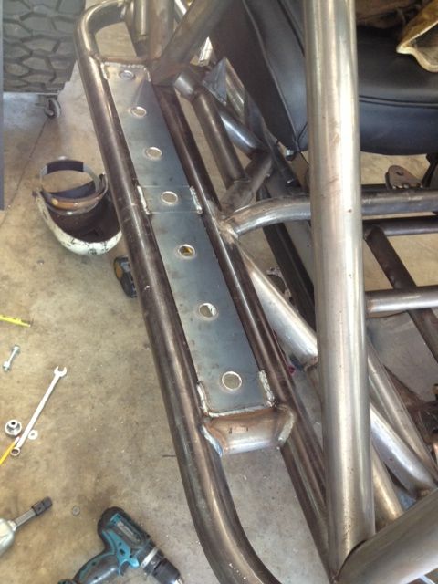

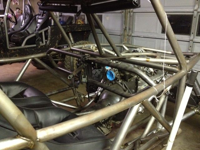

Tied chassis together and incorporated driveshaft hoop. Added a double shear tab to mount corner of seats. Thought it worked out pretty good. Driveshaft cant kill me now and seats sure as hell aint going anywhere.

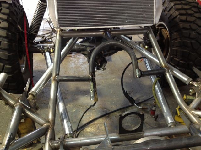

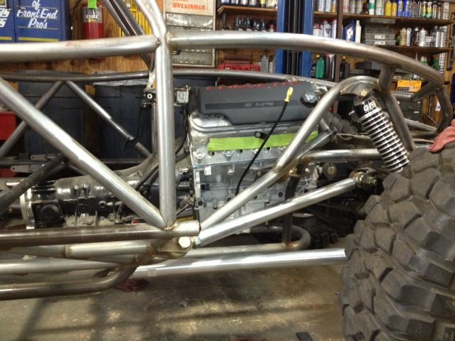

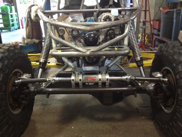

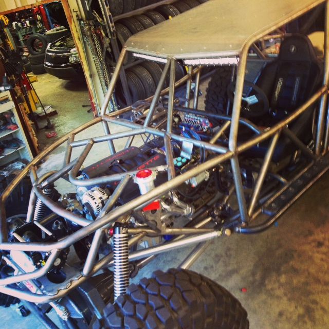

Well baby is here and new house is bought and moved in! Been awhile since I updated but I'm still plugging away slowly. A lot of parts have came in, Mostly from Wide Open Design. Atlas is mounted, steering done. You can also see the Lazar Star headlights mounted.

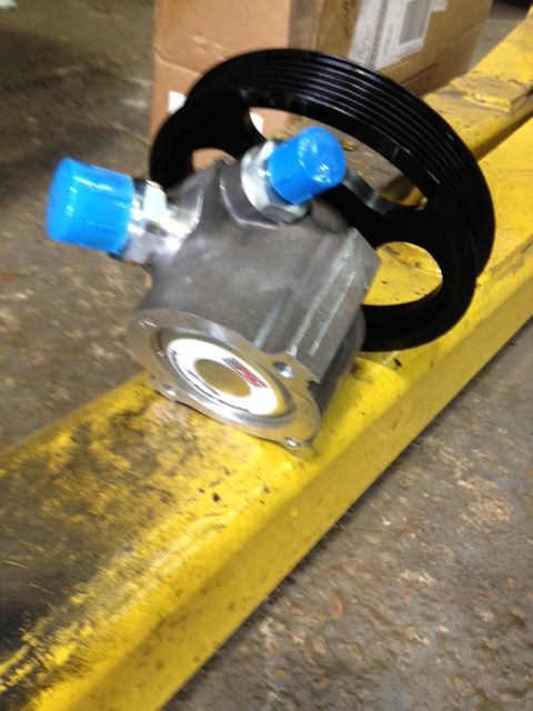

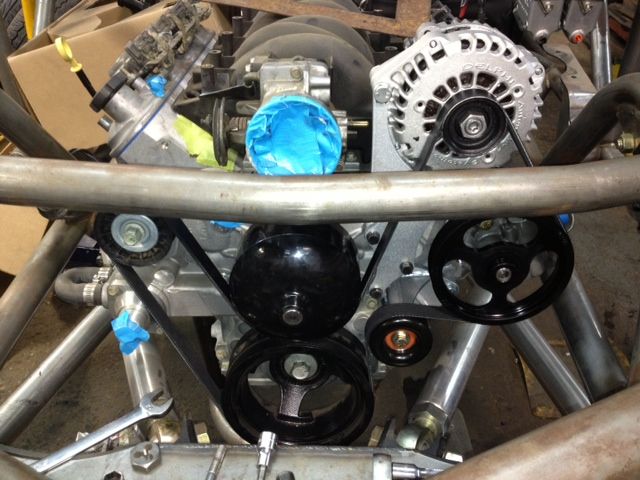

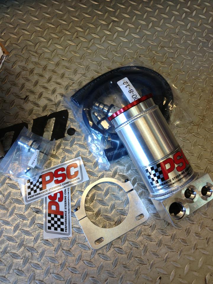

I bought the WOD alternator/power steering pump relocation kit along with the PSC CBR pump. Really fits good and looks amazing.

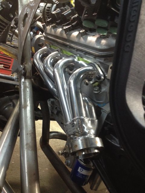

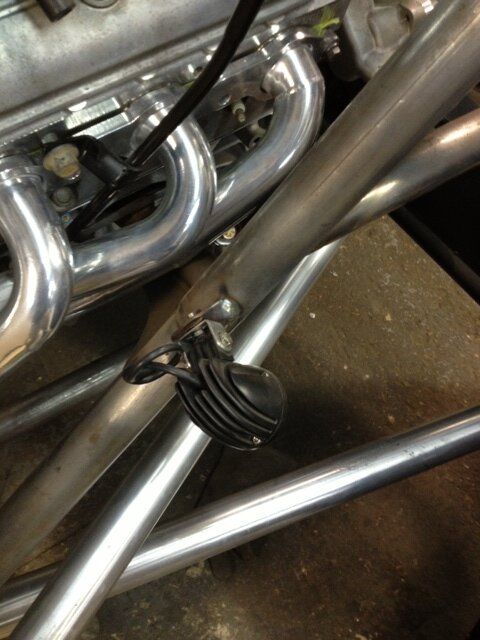

Had a problem getting different headers to fit with the engine being slightly off center due to the HP front axle so I bought a pair of bare Sandersons and had one tube modified. Had a buddy tig some V-bands on them and then coated. Turned out awesome and wont have to lift engine to remove headers. Went ahead and welded in some tabs to mount rocklights I got from pirate.
