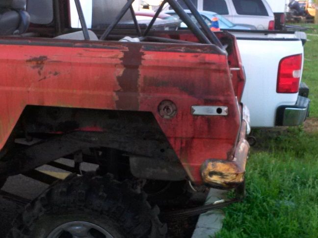

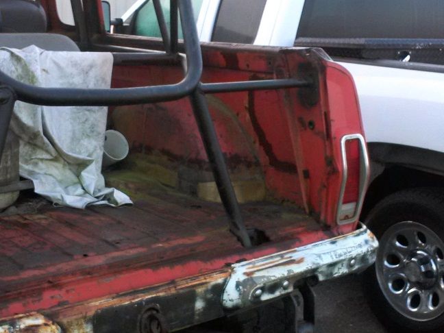

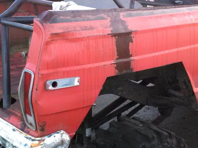

I missed the pics of the rear stretch you did or was not paying attention to the ones that showed it. We cut the frame and hung the rear shackle off the new crossmember that we built at the rear of the frame. We then covered the new crossmember with the old bumper. It looks good and with the six point cage it turned out to be a pretty stiff chassis. On the interior of the body we modified the two removable panels for the bob and left the original fenderwells inside alone.
