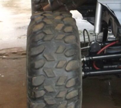

If this would have happened to me I still would be in the garage throwing things and cussing. I don't know why I find it funny but I may do one of my tires like this just to see what smartass points it out.
What kills me is, that it manages to show up in every picture I take of it molaugh I'll get the video uploaded tonight, along with some FL wheeling pics/vids from today thumb.gif
