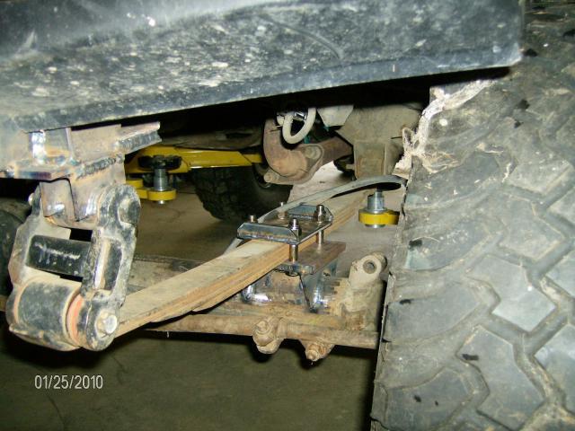

Dang...I forgot!!! But also didn't go down to the shop either---when to town for a bit...I will be out in the shop tomorrow night, and will take a couple shots for ya...actually here's a teaser for unclestripey (his rig is at my place at the moment, mountin' yota's under it!!!:D Note, the shackle mount has been moved forward approx 1.5".... He's got rears up front... He used to have revolver shackles, and I took 'em apart and used the actual shackle part of them for his normal shackkle, which these measure at 4.5" hole to hole...More pics of his rig to come at a later date!!! That's all you get fer now Unc!!!:fawkdancesmiley::D
Yer killin me!!:awesomework::beer:
