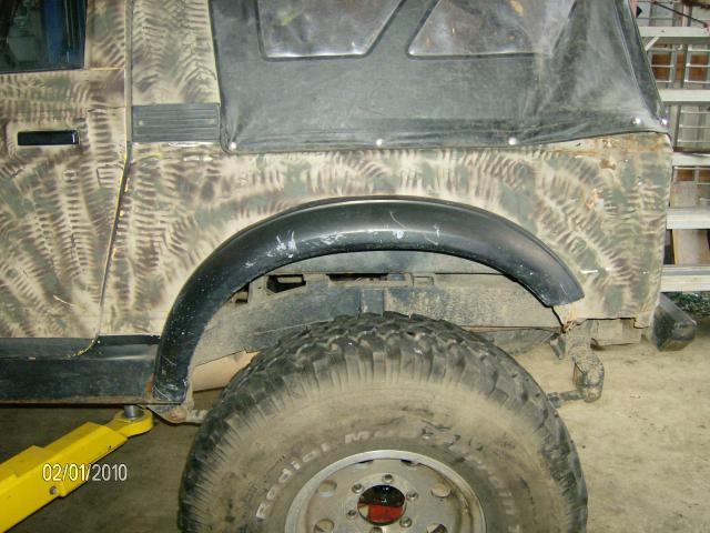

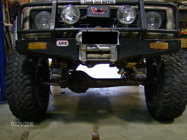

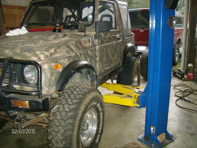

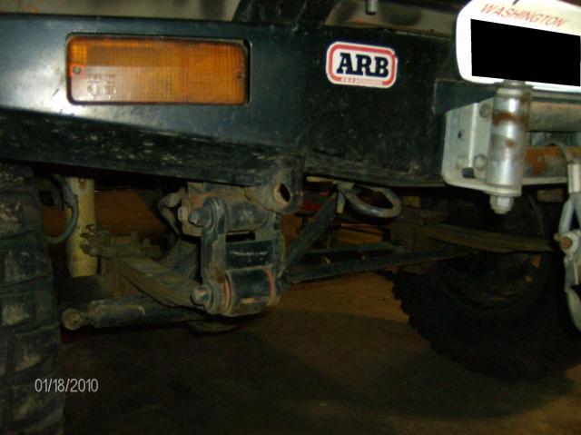

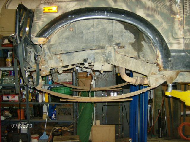

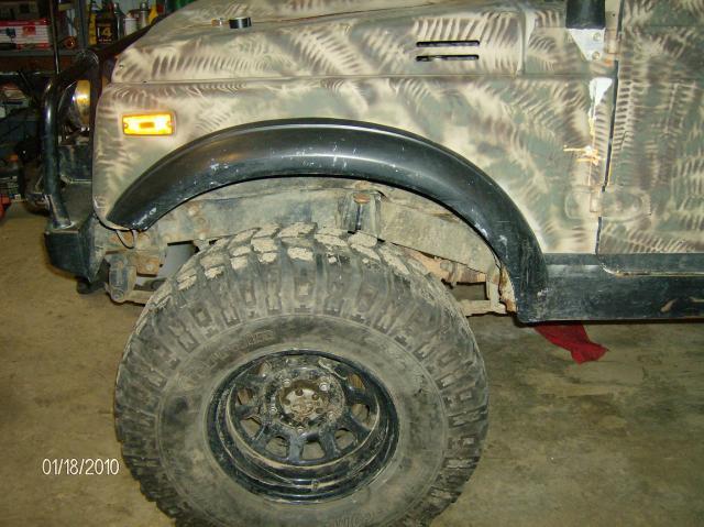

Ok these first pics are from the day it came in the shop...note the dropout shackles...those are going away! (well, part of 'em!):cheer: Also getting upgraded is the steering!:yikes:
First thing---remove the old axle...

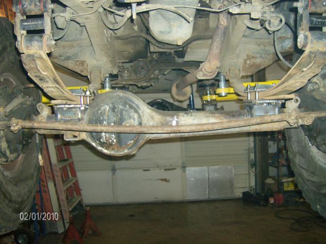

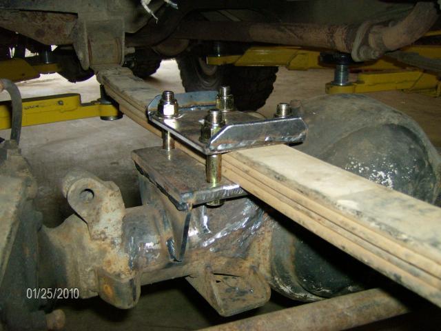

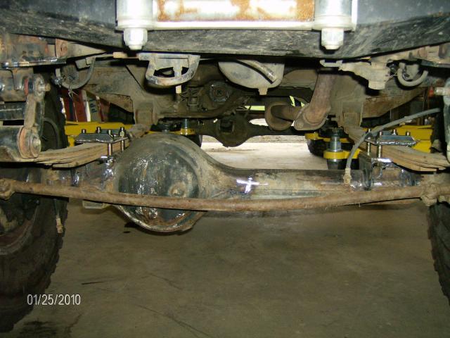

Next series...getting the front shackle mounts redone (moved forward 1.5" to compensate for the rears up front without the dropout shackles!), and axle ready for install using the sandwich plate mounting setup similar to mine...it's worked for me very well...still some cleanup/bracing to do to the plates (pics coming later on that.), but the axle's in there!!!:cheer: Last couple pics are of its new front stance with the 35's on it!!!:cool: Don't worry, we'll be straightening the TR, and bracing it with angle iron!:redneck:
J/K!!!:haha:

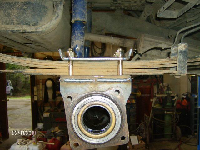

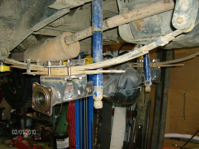

This series...getting the old rear axle out. Prepping the replacement for install, again using the sandwich plate setup...and getting it in...again/cleanup/bracing on the perches need done......:awesomework:

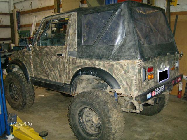

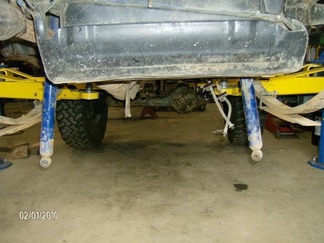

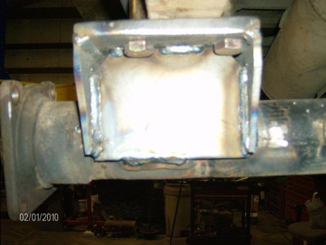

Last is a couple mockup shots of what overall stance should look like...and the perch bracing:awesomework::cool:

Like those front shocks do ya?:haha::haha::haha::haha:
