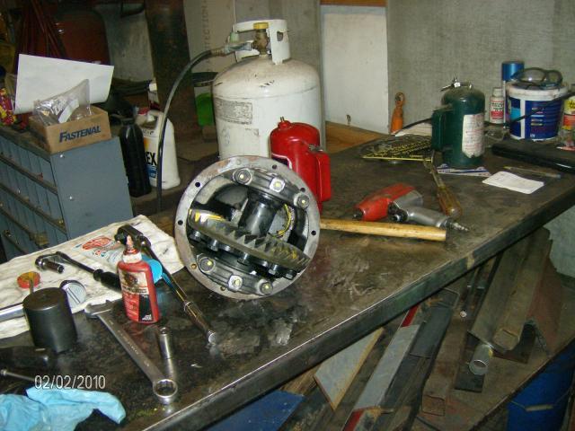

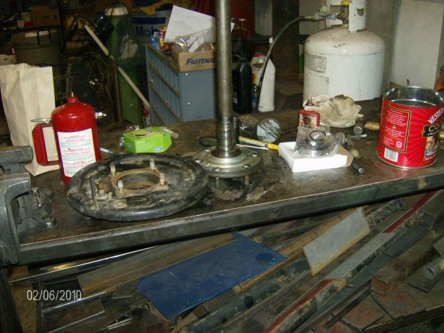

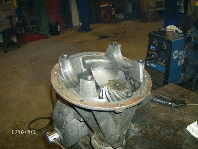

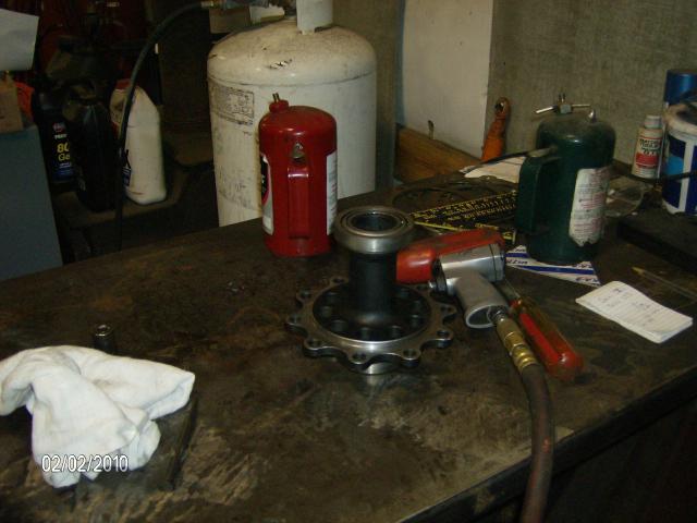

This 3rd I got was nice!!!(Thanks again redneck hippy!!:beer:) :awesomework: Pinion bearings have good preload, and backlash was .009":awesomework:; took the carrier out, cleaned up the spool abit (which also had really nice bearings by the way!), cleaned and installed the ring gear, set the backlash to .007"...patterned out beautiful (hard to tell in the pic, but it is nice!)...just gotta clean up the housing and install tomorrow nite!!!:beer::beer: Also, may have to pick up one rear axle bearing tomorrow cuz I'm having a hard time finding an axle that already has a good one...:eeek:

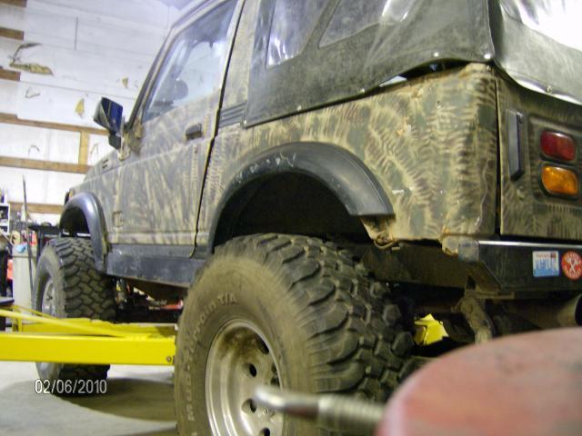

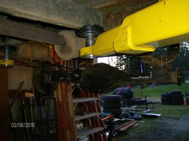

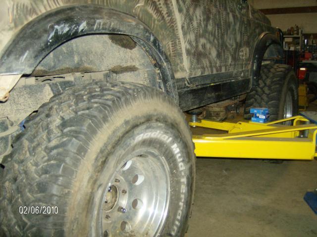

So, got the wheel brng and outer seal today, and assembled. Put the axles in and got it sitting on all fours!!! Sits right where I mathed it out...:cool:
