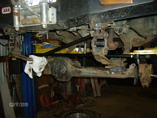

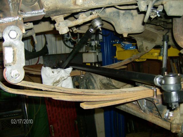

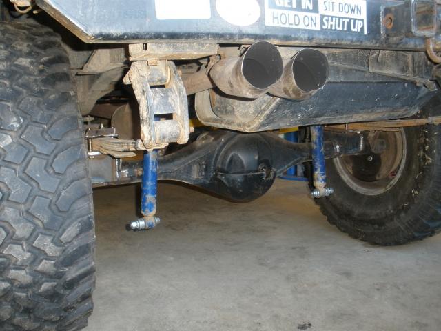

OK, got a couple trunions from a buddy up here!! (Thanks to all that offered!)...got the knuckles cleaned up and installed along with Breeze's arms...one small issue though...the Napa TRE's have the zerk fitting drilled in the wrong spot, and it hits the other rod end!!!:mad: Gonna have to get a Moog rod end, as it has the zerk in the right spot!!!:D Here's a few pics for ya Unc (I know, FINALLY!!:haha::haha::haha:)...

Well, got Moog tie rod, and it was drilled in the same spot as the napa unit! (manufacturers must have moved the hole since I did mine):mad: Sooo, I carefully tacked the hole closed, and drilled the top of the rod end to accept a zerk...ground the boss down a tad, and it's tight, but it clears!!!:cool: Sorry, no pics yet...will catch up on those soon! Front end's all together save for calipers/hoses....still have to figure out the shocks.

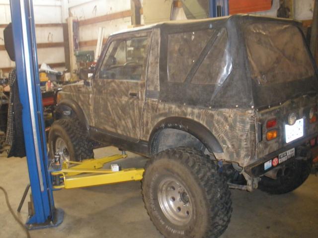

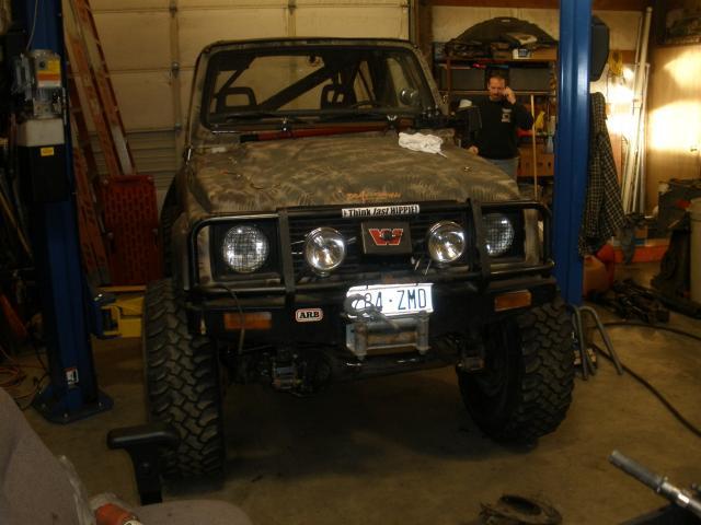

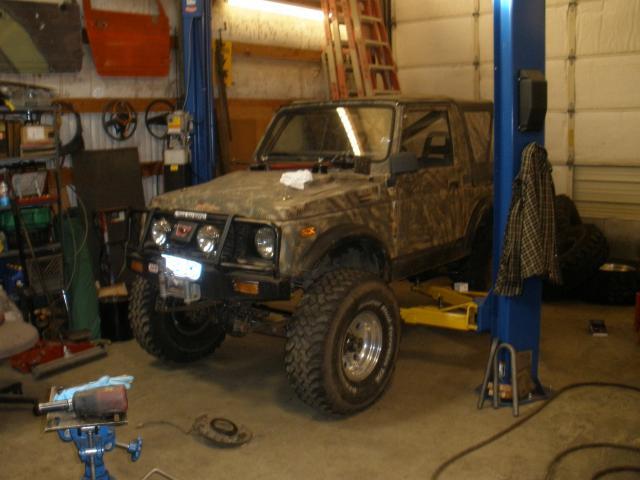

Saw 'er in person today....NICE WORK Kevin!!!:awesomework::beer: It's oh so close to bein' back on the trail.:nana1: I can't wait...
