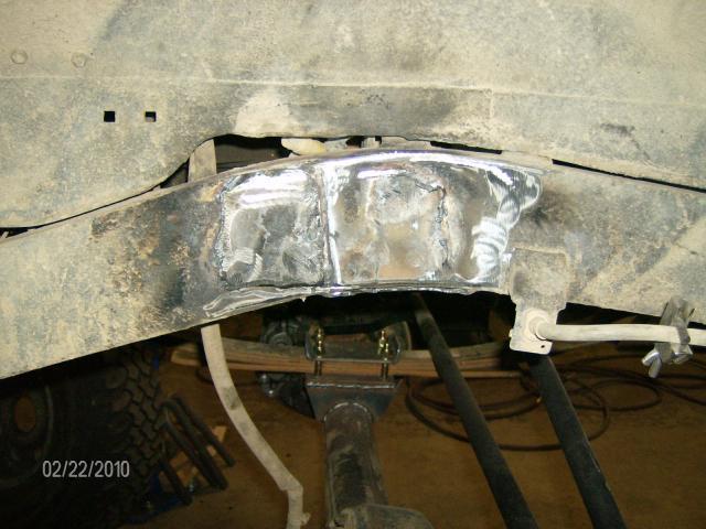

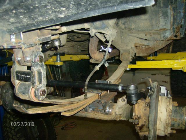

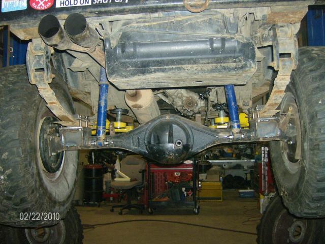

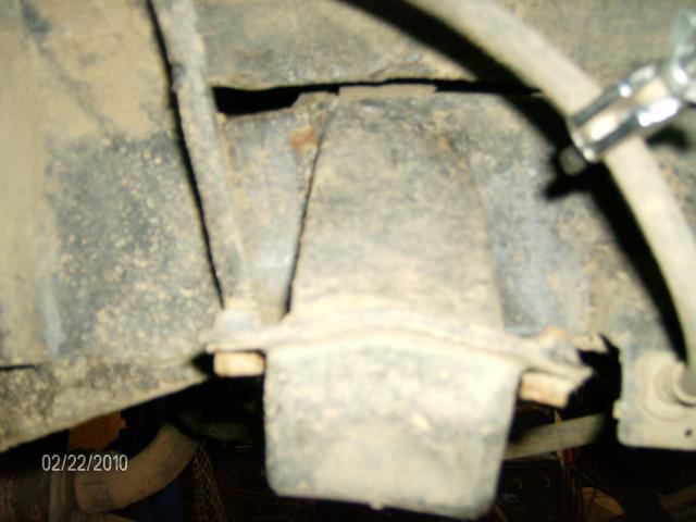

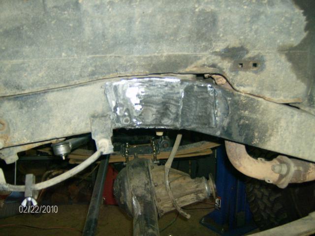

Naw, but we did threaten to all day!!! I was fresh outta paint though since painting your axles!!!:haha: here's a few pics of today's progress...
Got the rear shock mounts welded on; new front spring bolts and calipers/pads...etc... During the front axle install, I noticed the factory bump stop was tweaked pretty good!!! Hard to tell in the pics, but the frame was pushed in approx 3/8" where the bracket was welded onto the frame!!!:yikes: Kinda works out as the shock mounts needed relocating on the frame---so off came all the old crap!!! gonna plate the frame to prep for new shock mounts....

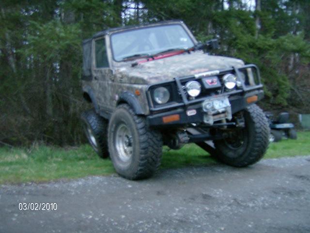

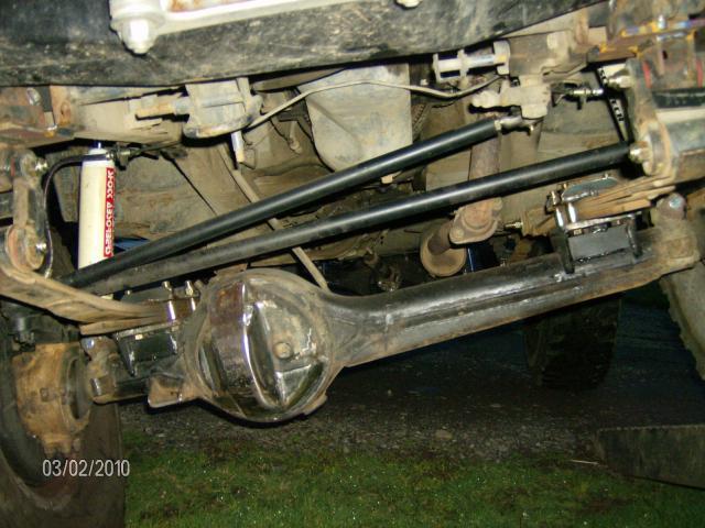

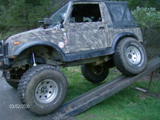

Few shots of the rig...and the front diff armor; still waiting to get some driveline adapters, oh and some more 12x1.5 lug nuts!!!:haha:....but otherwise she's dun!!!:redneck:

that turned out really good props:awesomework:
Side not. . . where did he get the camo wrap?? that is really cool looking:cool:
It's just paint....Went to the hardware store, bought "camo" colors. They're "ultra flat", three cans khaki, one green, one brown. Painted the whole thing khaki, grabbed a fern and some cedar bows, just misted over them with the brown and green. Dirt cheap stupid easy stencil for camo.
Sweet!! Looks like she still twists up pretty good!:cheer: They're still claiming they'll be delivered tomorow, were in Portland as of 2:00 this afternoon.:eeek: We'll have to mark out the "trimming" with a sharpie since ya got that handy dandy ramp. Can't thank you enough for all your hard work, it's finally the kind of rig I wanted it to be......you know, one that spends more time one the trail than gettin fixed in the driveway.:haha: :beer::awesomework:
