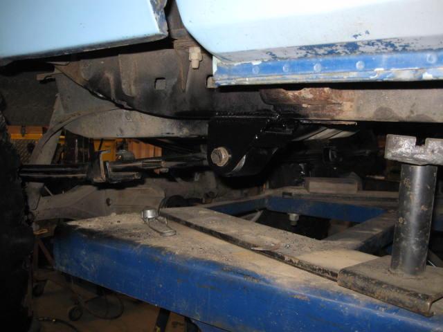

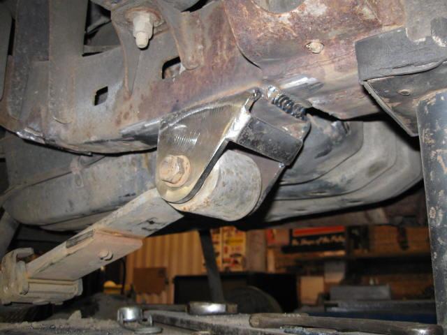

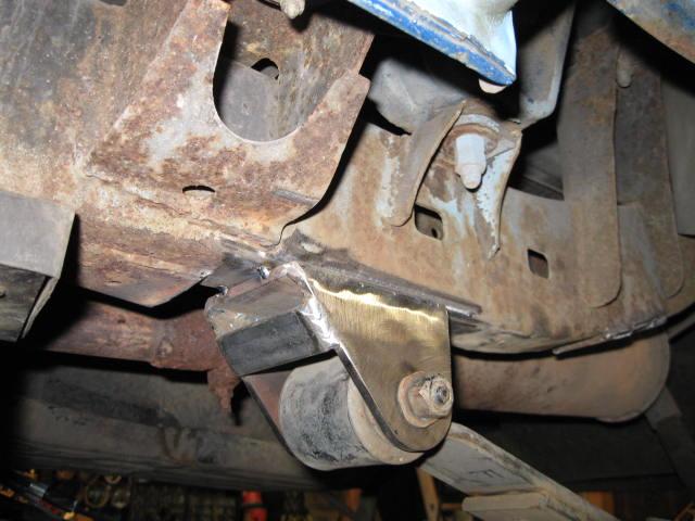

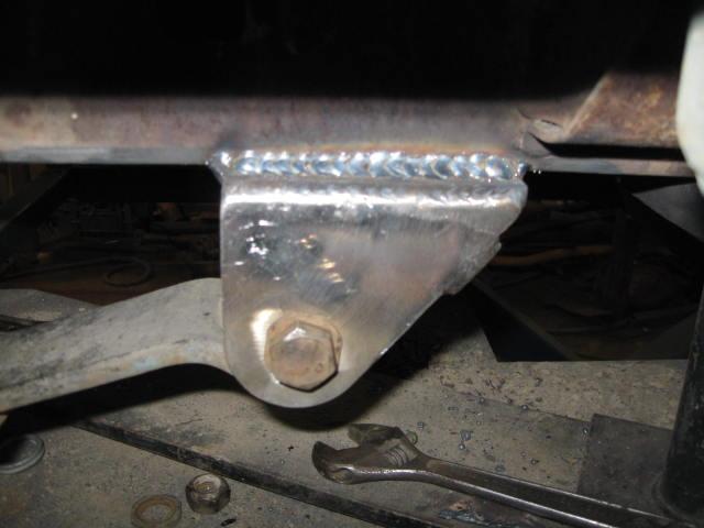

Got the hangers tacked on, then welded, then painted.:cool:

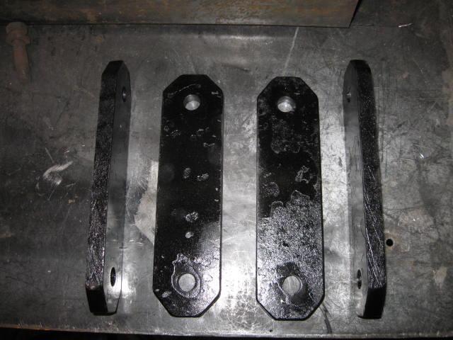

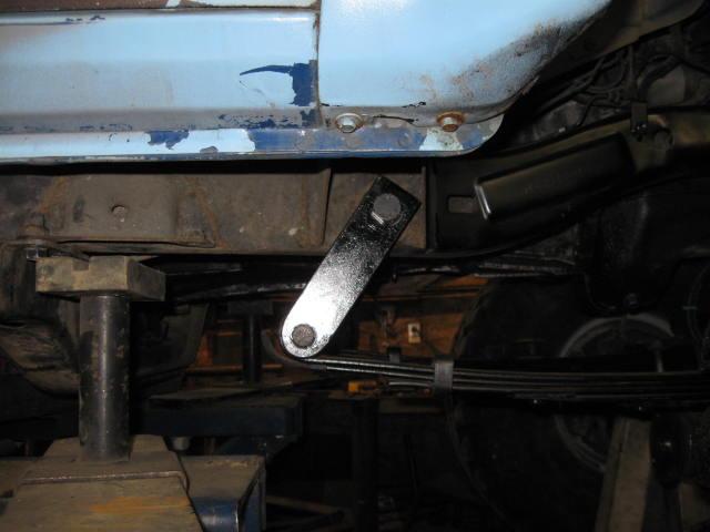

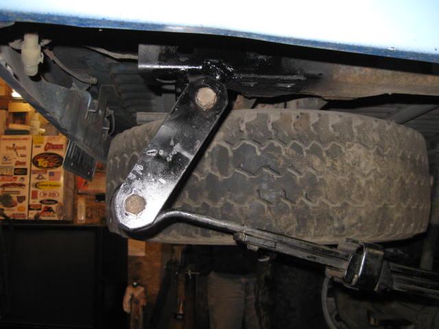

Cut, ground, and drilled some 1/2 wall X 2 inch flatbar for rear shackles.
The last two are pictures of the rear and front shackle angles with all of the trucks weight on the axles at ride height.:awesomework:

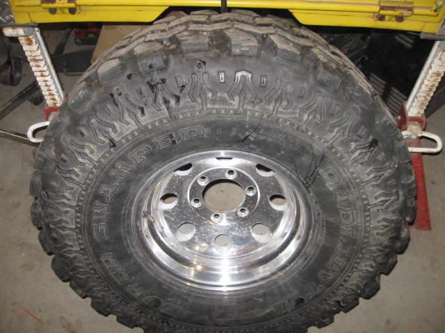

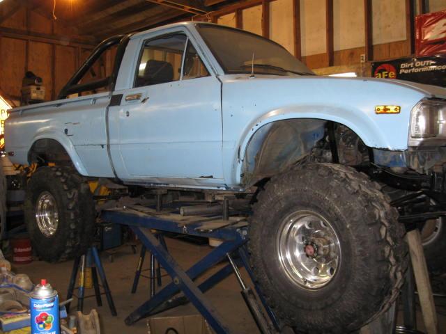

Got some rubber from the House of Steel in the form of 36x12.5 swampers on pretty wheels.

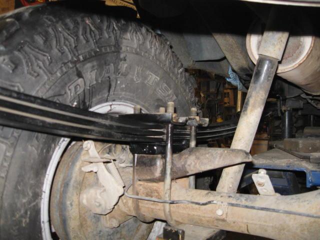

Put a Ubolt flip in the rear to match the front. Used a 2 inch block to make it level with the front.

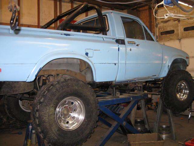

Here is ride height. Not much taller than it was before. Just will work much better.:cool:

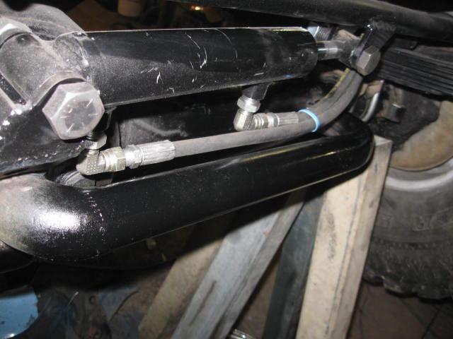

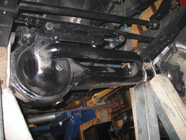

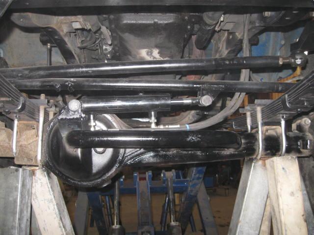

Started making a bumper for the hydro ram.:D Got it all fit up and tacked and then ran out of wire!:mad: Looks like Ill have to get shocks and wire tomorow.:beer:

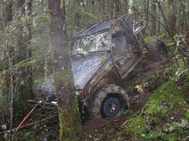

Then I went playing and got a little "pickled".:haha: Had to push the truck sideways with the hilift till the tree let go! There was another tree against my passenger rocker bar too. Made for a good cut.:cool:

Did you use a weldable 90 on the tight short bend on the diff side of the ram gaurd?
