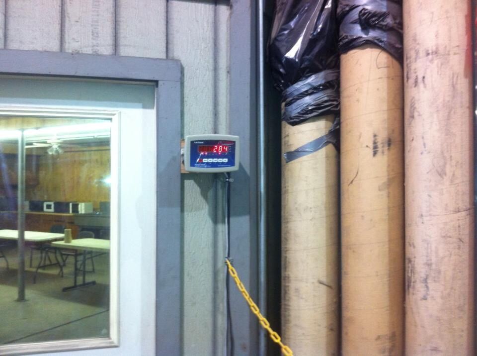

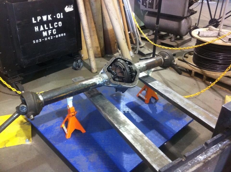

Not complete but, a lot of the heavy parts are there
14b driver drop, stock rock shafts, knuckles, inner c's , spindle, super8 hubs or stick rock hubs for that matter.
