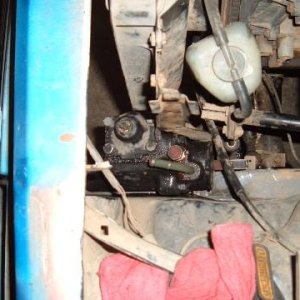

Driver's side is out. I want to keep my windshield washers for winter wheeling, so I will have to find a way to relocate that. Jonathan, what did you do with the ECU?
I made a rubber shield that zip tied over the mounts to keep mud and water off of it. I have since removed that and have been wheeling without it.

I think I'm going to re-locate mine right inside the tub, looks like there's room to mount it approximately the same location inside as it is mounted outside... since I have no e-brake assembly junk to deal with. As long as the clutch doesn't hit it. Might have to extend the wires a few inches, we'll see.

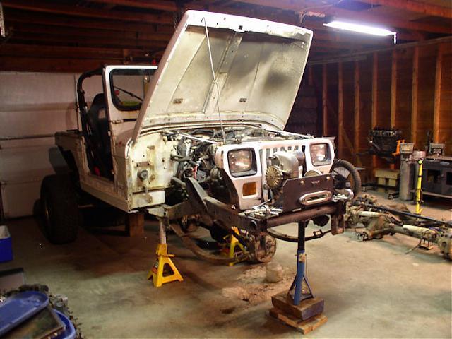

Oh yeah... try this idea on for size... a 4-link out back. Can I still be cool if I only run leafs up front? :D
No. :booo: :booo: :booo:
Damnit.
I think it will be more work than I want to put into a YJ frame anyway, since I don't have the balls and dollars to hack the frame off behind the seats and buy coilovers.

You certainly do. I've been busy the last couple nights, and will be busy for quite a while with the grinder and sawzall. Bunch of stuff still needs to come off. The winch has to come off, then the master cylinder and all the brake lines. Steering box will come out, then the leaf springs will get unbolted and the stock mounts will get hacked off, then I've got to buy a bunch of flap wheels and grinder discs and get the front section of the frame clean... then I need to get a new bottle for the welder, and we'll be, quite literally, cooking with gas. :redneck:
Actually, first I need to start tearing the front axle down so I can get the long side shaft out and sent out to Jantz for some shortening. Hopefully it will work out properly like that, since my 60 is out of a '90 and it shouldn't be the neck-down style shafts.
