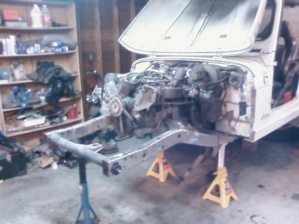

No tech really, just a picture of what I spent this evening doing. My snot is black.
Still trying to decide whether to go shackle forward or shackle reverse... and whether to ditch the RE 1444's for waggy springs up front... maybe.

I think he should stay shackle forward, and keep the rear mounts(plate them up) and run waggy springs, That should work awesome, then I could test out his old yj springs on my mj, although mine work pretty damn good. moving his axle forward abit he will beable to keep the front driveline also. room for nice big tires, and longer WB, should be sweet, I want him to get to the hydro steering, I'm just going assist.
Plus matt, if you go shackle reversal it would be pointless to notch to frame for the rear frame side leaf mounts, right now, the leaf mount is up higher than it would be if you went shackle rear.
is there room to redrill the leaf bolt higher up on that rear mount, and then you could grind off about an inch, i would think....
I don't really want to re-use/reinforce the factory spring mounts. :(
I'd rather take the time and build my own.
Anyone have a measurement eye to eye for waggy springs... off the top of their head?
Oh yeah, and it will be full hydro Scott... just no bling coilovers (yet). :D
