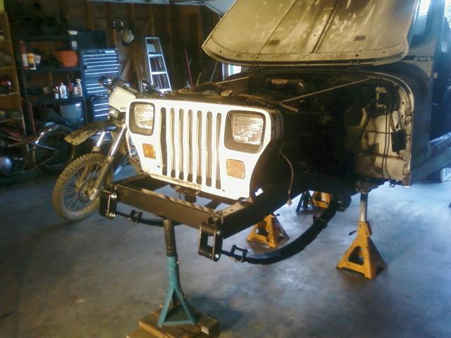

It's sitting just about how the last pic shows... except I moved it to the other side of the garage. I just haven't had the time/money/motivation to work on it lately. I got side-tracked with a 4runner project that I think I am going to sell now, and concentrate on this.

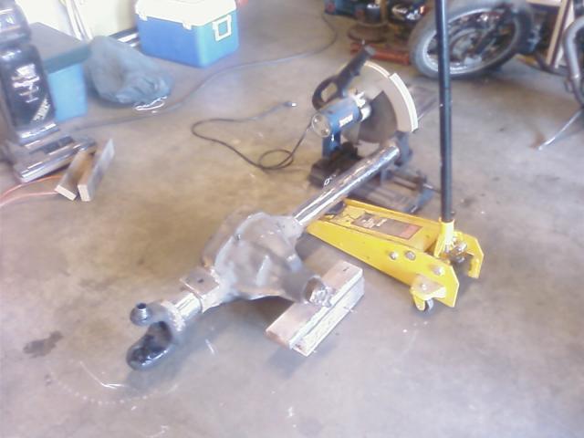

Today I will grow some nuts and slice into the passenger side tube on my 60 housing. :eeek:

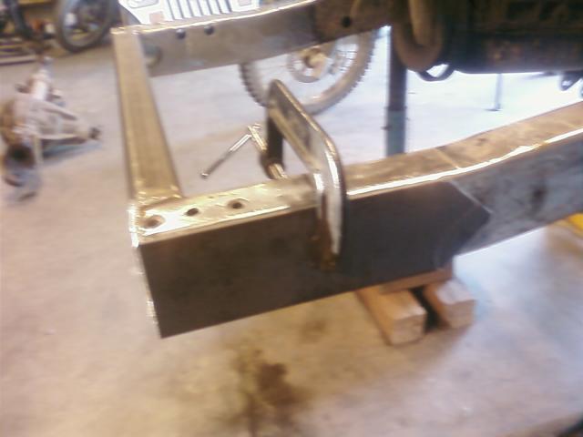

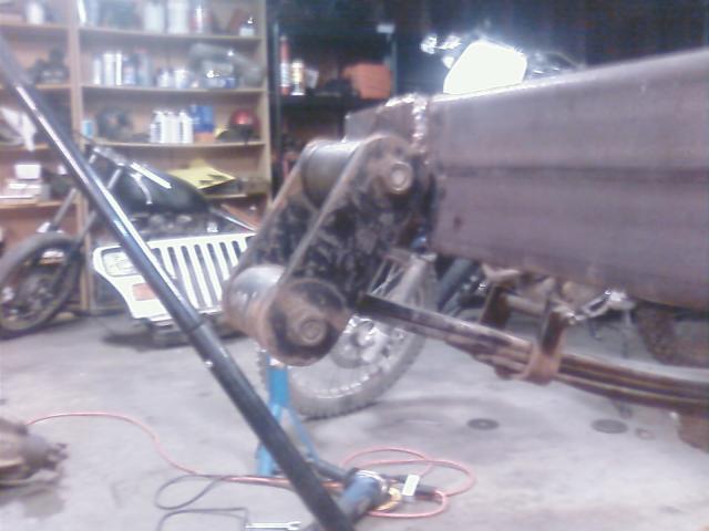

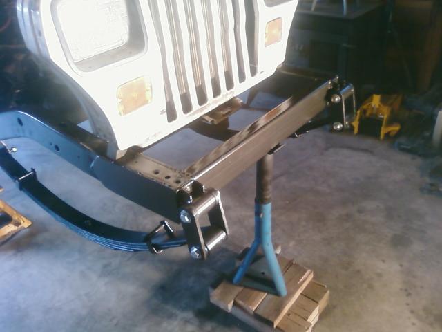

Front suspension is done. Need to make a grill mount, and some shock hoops. Still haven't sliced into the housing... maybe drink another Pabst Blue Ribbon or two tonight and get it on. :redneck:
