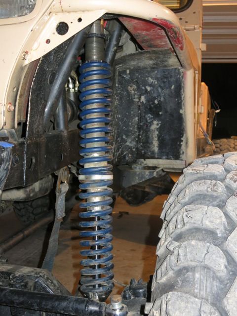

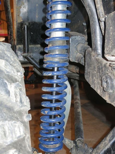

Would some pics help you guys out any? I can get pics tonight. Anything specific you need to see?
Here is 2 that I have on my computer already.
In the pic of the front, the springs are just laying there. NO preload at all and probably 4-5 inches away from the preload nuts.
In the pic of the rear, there is still tension on the springs. I am pretty much at full flex, so they SHOULD be OK set up like they are.
