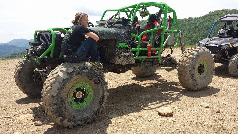

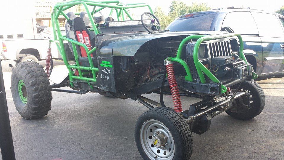

here is my set up. SBC V8, turbo 350, np203/300 14" coilovers front, 16" rear front spring rates 100/150 rear spring rates 100/125
How much shaft showing front and rear and what is your belly height? I need something to compare to if you don't mind
