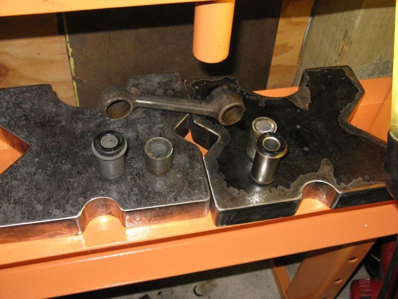

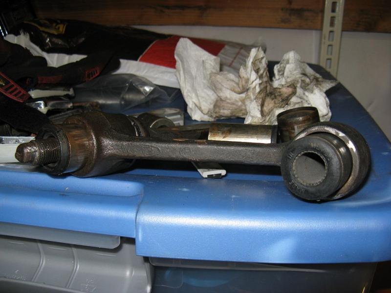

Wasted a couple hours trying to rebuild the idler arm tonight, only to have one of the bushings be incorrect.. :shaking::rolleyes:

Got the steering box out. Off to Red Head Steering in Seattle tomorrow. Also have an idler arm on the way from West Coast Classic Cougar. Got the correct bushing for the original, since it was cheap. Will finish it and keep it around.
Got my new steering gear from Red Head in Seattle. Put my factory tag on it. It's just over 3 turns lock to lock, like the original. Also cleaned up the original rag joint. Still has some of the factory paint markings on it. Pulled the power steering pump and started cleaning the bracket up. Also finished the original idler arm in case the one I ordered doesn't work out.

Cleaned and painted the center link. I used the same "cast iron" paint I tried on the PS pump brackets. Also got the new repro idler arm from west coast classic cougars in.
