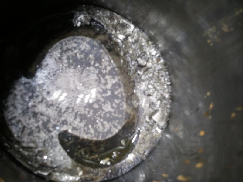

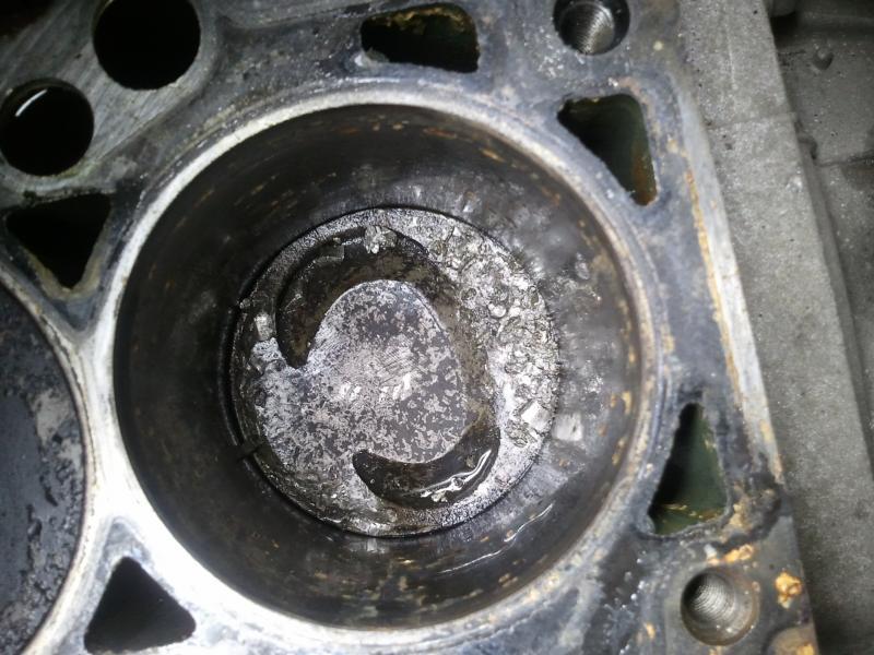

I got pictures!
Kevin, Joop.
I can forward them to you. I just need your email addresses!
According to the shop the valve seat came loose. Dropped into the cylinder and thats why the engine went TU.
Pictures are really cool. can't wait for you all to see the damage from one little piece of metal in a cylinder.
Kevin, Joop.
Damn!!!:yikes: Haven't seen that cool of carnage in some time!!!! And the valve seat thing does make sense---have actually heard of this happening, but not on a ford yet....
Wait until you see the rest of the pictures.... C'mon Joop. post the rest!
The other set shows why there was coolant in the cylinder. And how the end of the plug got busted off as well.
New song variation of 'Have you driven a Ford... Lately?' to 'Have you pounded a Ford...OMG!'
