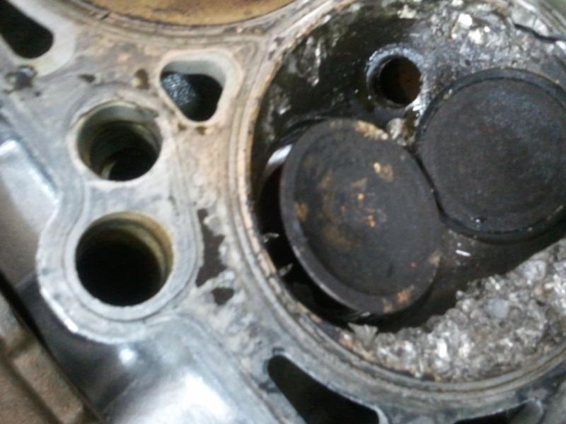

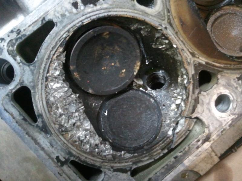

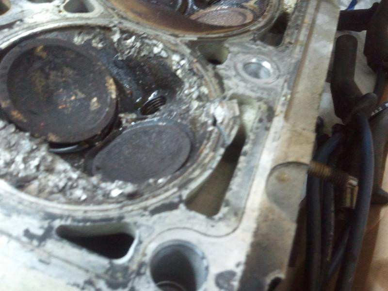

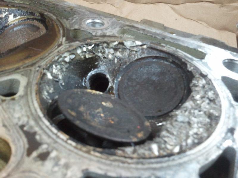

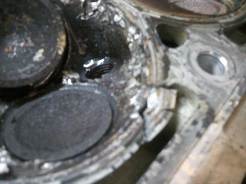

Remember, this happened rather fast. This isn't over a long period of time.
It wasn't just a *thunk*, then the engine quit. Even at 2000rpm, that probably went on for at least 30 seconds.

Now THAT is impressive....broke the cylinder wall....:cool:
I Digress...:booo: That's actually the cylinder head, not the wall (can't believe you didn't correct me on that JOOP!!!:redneck:)..... regardless, still impressive! :D

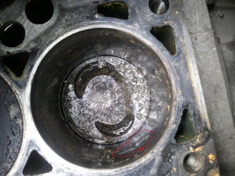

Didn't really pay attention because the second picture I posted kinda looks like a crack in the cylinder wall.
Soo...
I don't suppose the block is thick enough around the cylinder to bore it, sleeve it, and slap a new head on?
I know there are what feels like holes in the wall, but where do you see the crack?
I would think that, if it wasn't for the block maybe having a crack, buying a sealed engine is faster and a better deal. If we didn't have to return it for the core, Wayne wanted to tear it apart to rebuild it just to see if he could.

Wow! I thought ive seen it bad with a thrown rod but this.... just wow... thanks for the pics though :awesomework:... from the looks of it though you might be better of with a used engine... but i could be wrong.
Here's what caught my attention. Might just be a reflection but kinda looks like a crack

From the shop:
It is just a reflection. The inside wall is scratched (as I mentioned) and so the only way to fix that is to completely tear it all apart and machine it. And rebuild it.
The replacement engine is cheaper...
