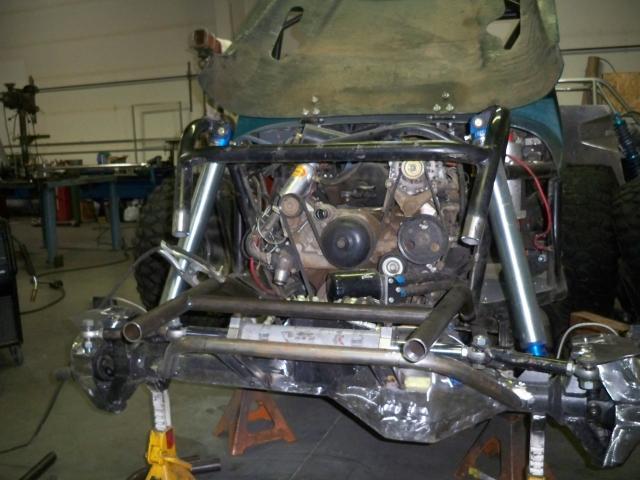

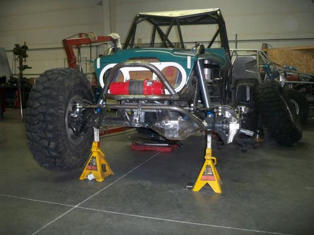

Were you having problems with the ram behind the axle or the double ended steering arm?
how come you wanted to raise the steering? Looks good as always.

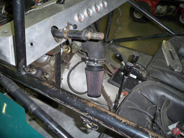

Raised the steering to gain clearance in front of the axle. Flipped my intake backwards and move the rad back and up. To make my approach better.
My 9'' single end ram set up was good on my last car that had close to 40deg of steering. My new car has 50deg of steering fr and rr and the 9'' rams did not have enough power from time to time. So i switched to 10'' double ended
rams and lengthed my steering arms. I have been very happy with the current setup.
