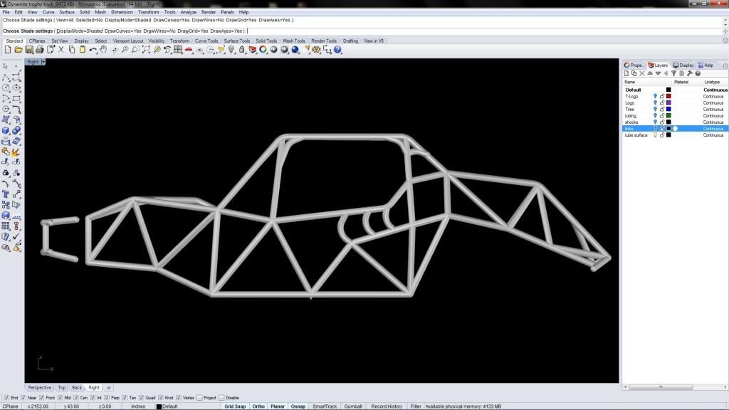

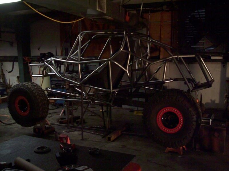

The chassis does not look very much like the drawings on page one. There were a lot of straight tubes and triangulation in the drawings. I actually liked the look of the drawings.
The chassis as it set had a bunch more bends in it. It is hard to tell by the pics but the front of the chassis from the dash forward looks unsupported.
I have to finish mount the shocks close to perpendicular with the trailing arms @ static ride height , and inside at the chassis.
The top of the buggy is 74 inches, with 18 - 19 inch ground clearance. with 37's
The caster has been set at 10.5 in mock up, but now that I have found the pinion angle, I need to break the tacks and turn them before I weld them on.
The seats are very tall with deep buckets. My head doesn't reach the top of the seat. Although they are not welded in, I will make sure they are mounted correctly with plenty of room.
I leaned the seats back 8 degree's, so the knee's can bend closer to 90, more like sitting in an office chair. This will keep the feet low and / while using a gas pedal with a bottom side fulcrum for comfort. Also allowing the headers to wrap up, and out to an exhaust pipe.
I agree!
