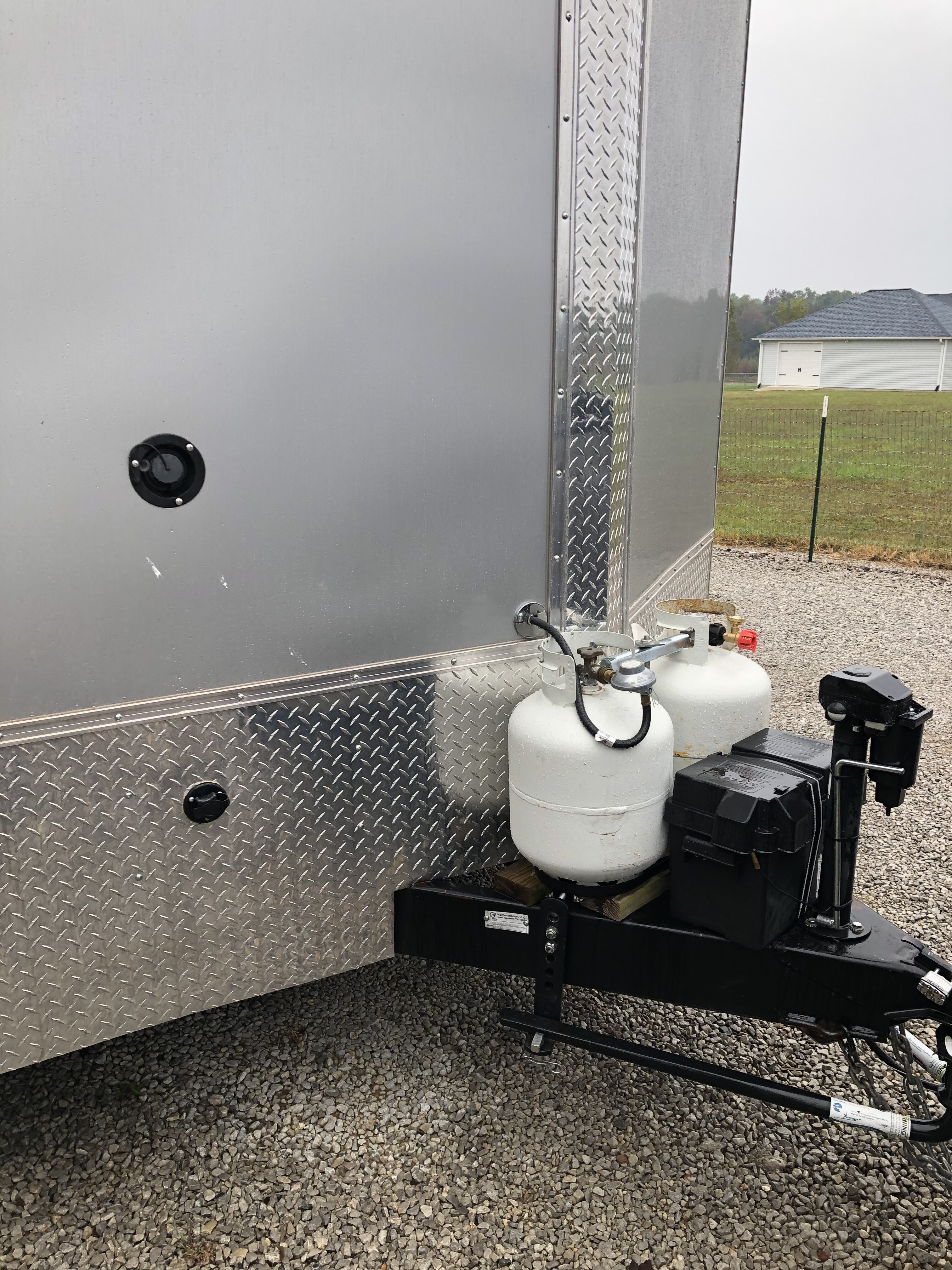

Propane tanks, battery, electric jack on tongue. Tank and city water hookups in V

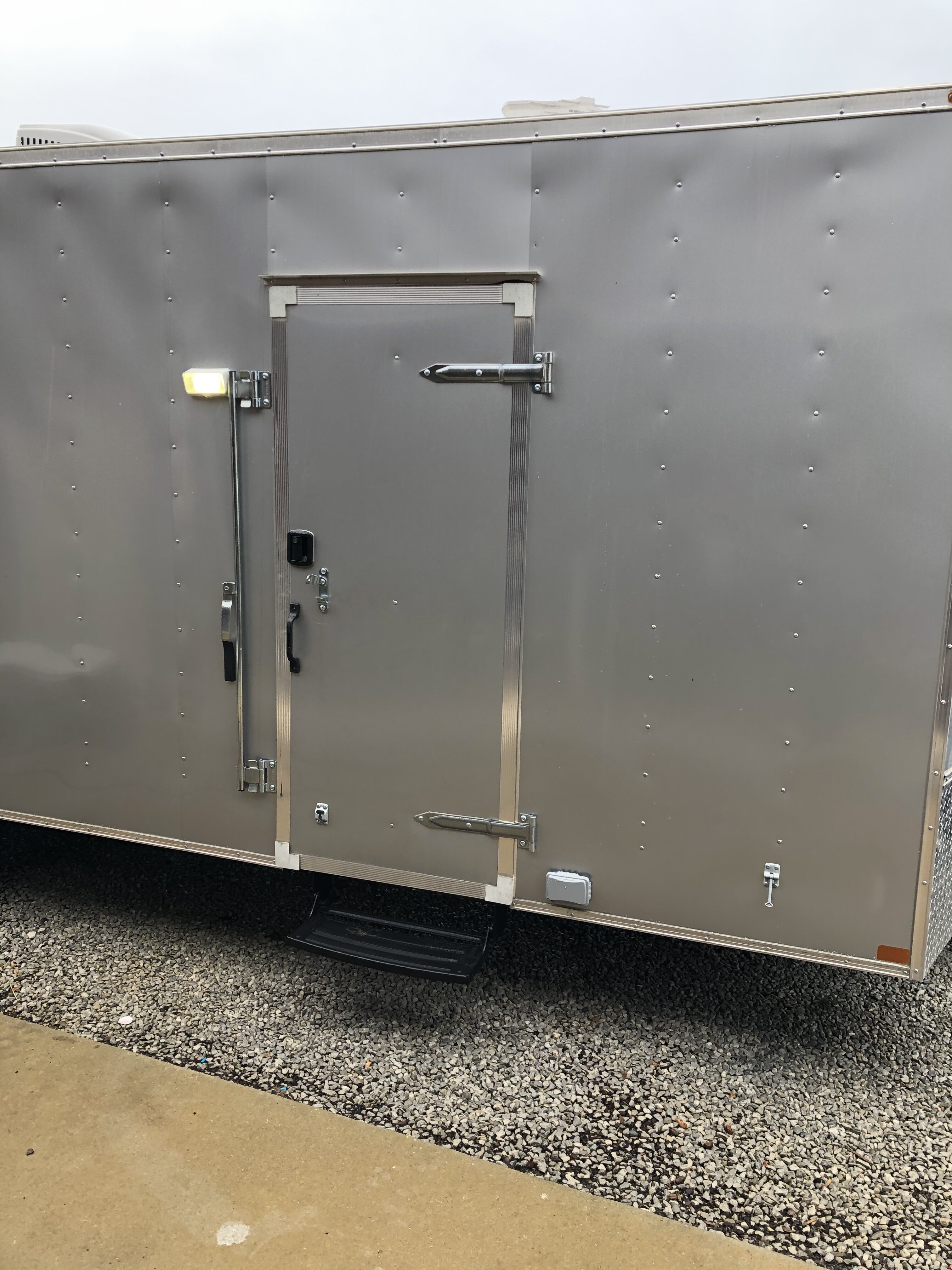

RV style side door and step. Added a porch light and outdoor 110v receptacle also

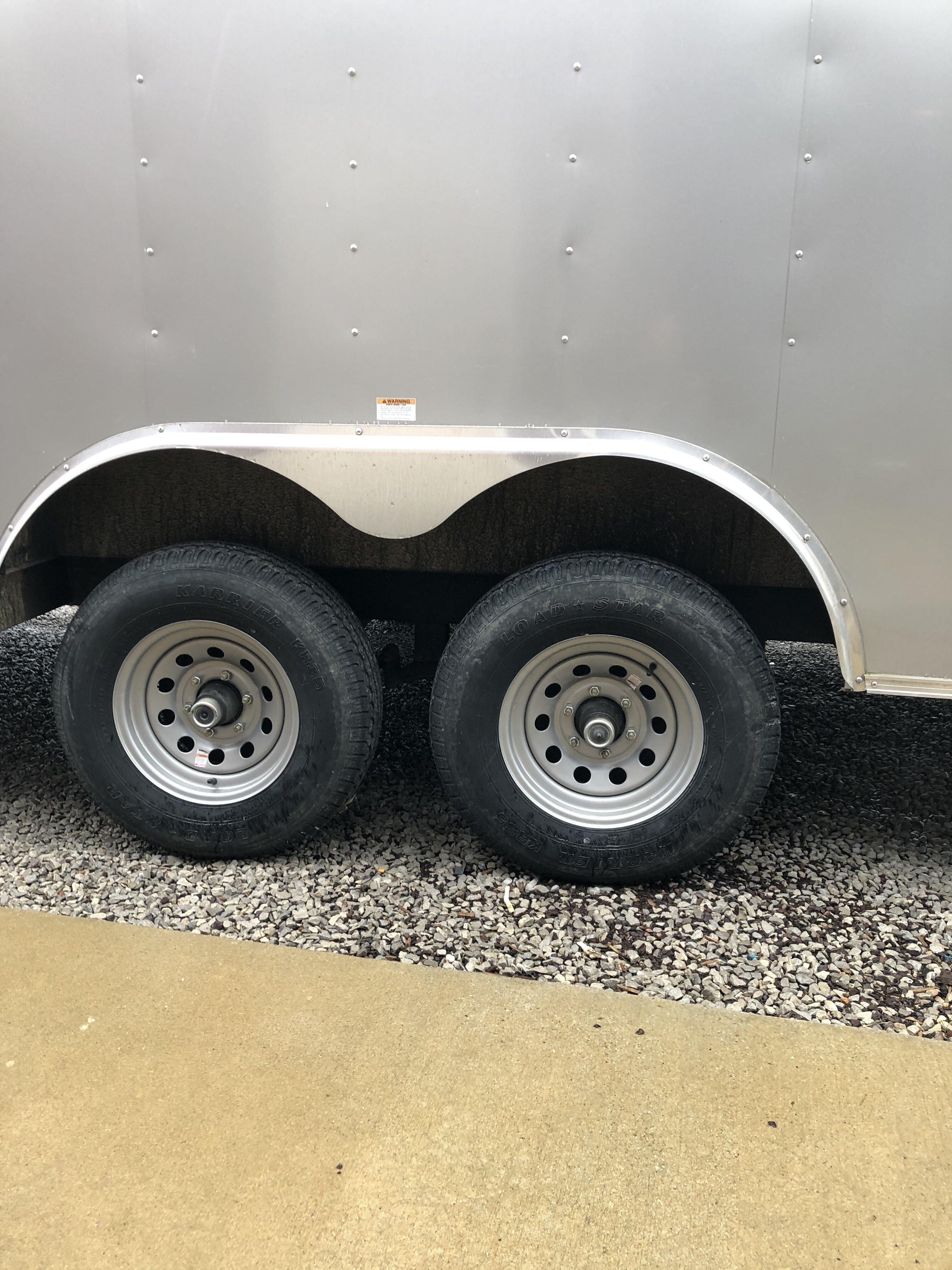

Flipped the spring perched to add height. It dragged a couple of places getting into parks before.

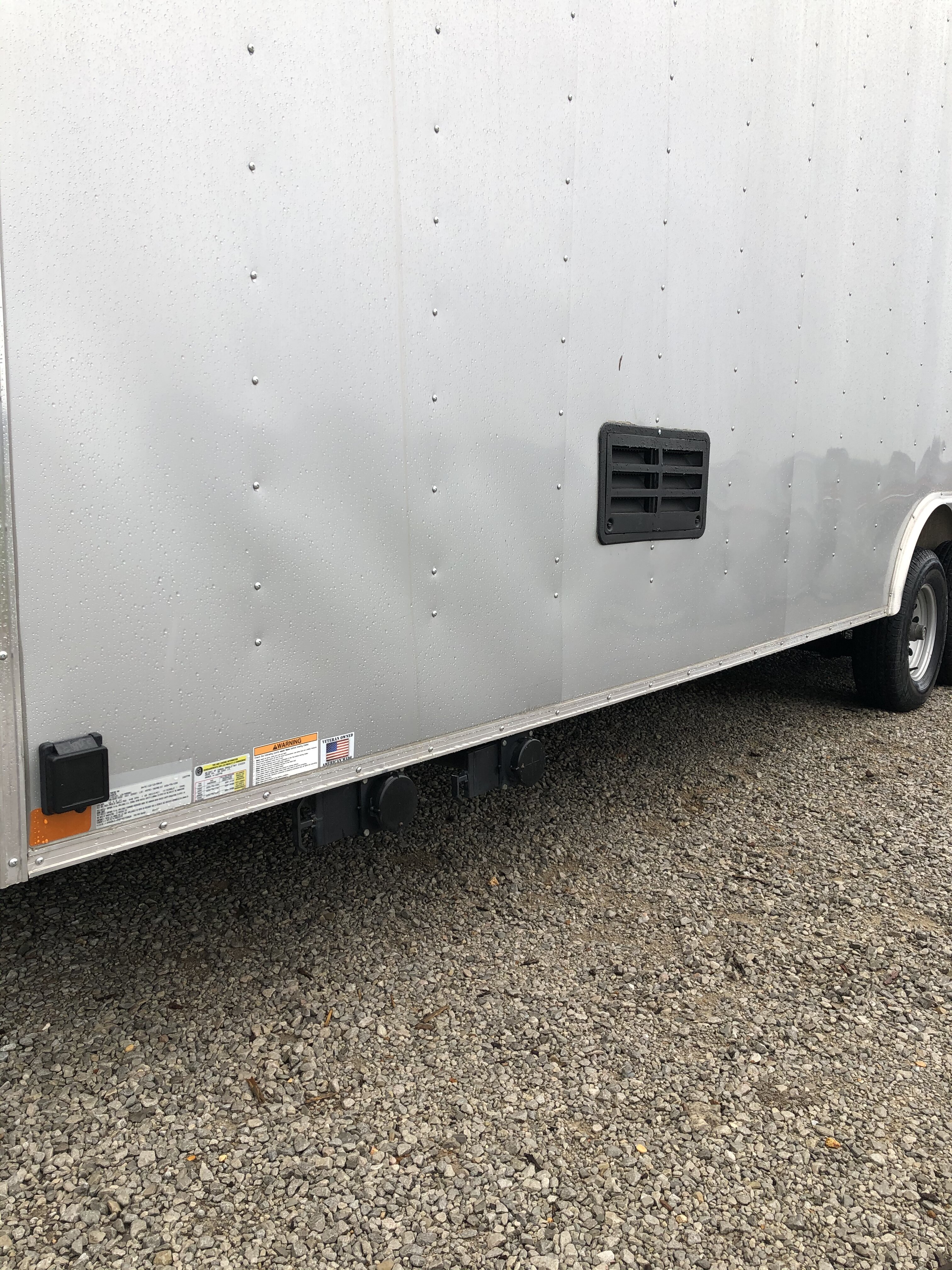

Fridge vent, electric hookup, and tank dump valves on driver side

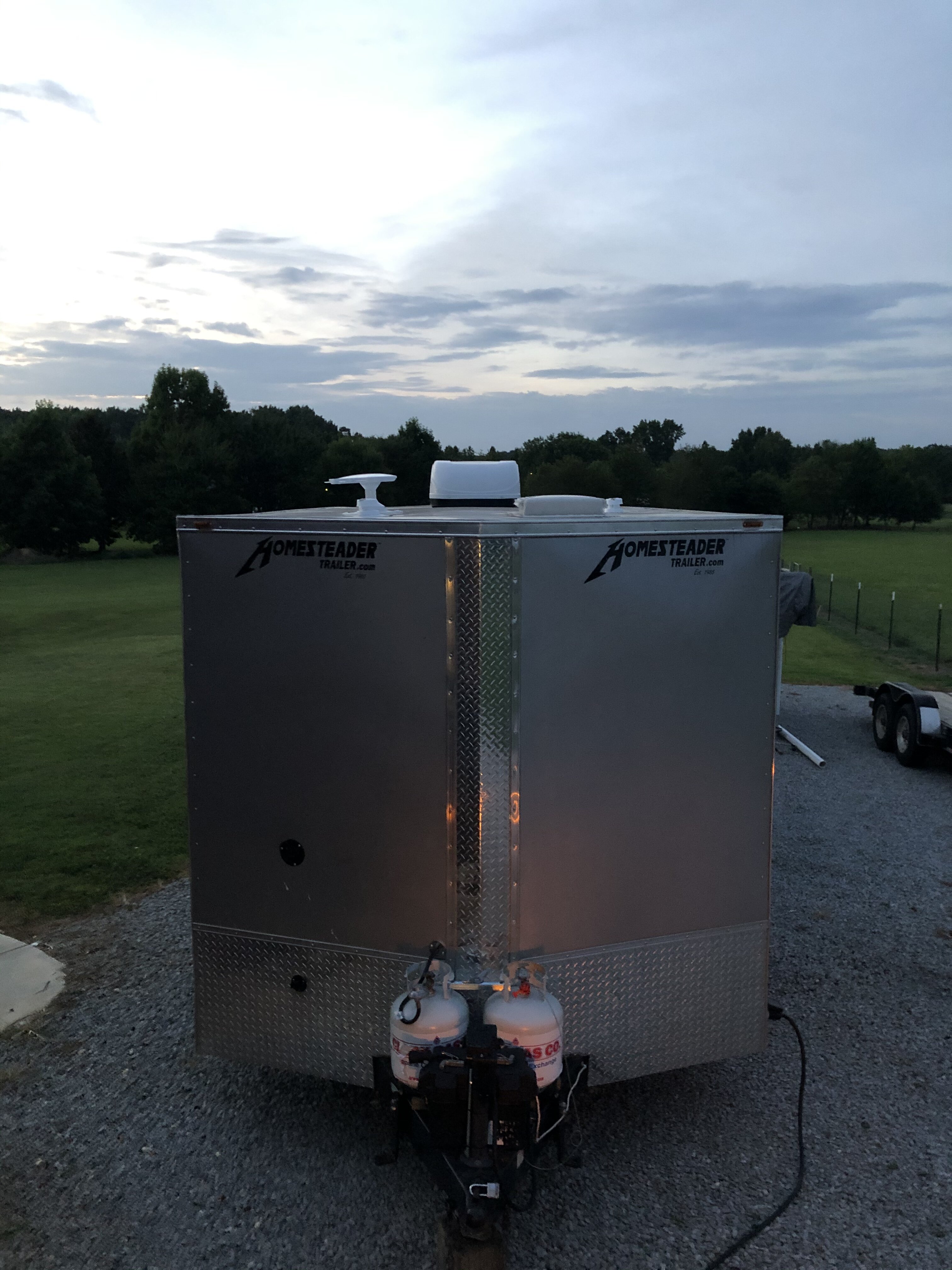

Rooftop air, digital antenna, bathroom fart fan and rear roof vent.
Good call on flipping the perches. Any idea how much "lift" you gained by flipping them?
Our last two enclosed trailers have had 3'' lifts and so I don't have to worry about dragging the back end anymore.
For the roof vent, check out the RV Roof Vent Covers. I didn't add any to our 38' trailer so was constantly opening and closing vents based on the weather. But the cover was one of the first additions to the 28' trailer. Now I just leave the vent open when it's parked at home or in transit and it feels better/less muggy inside the trailer.
I gained about 6" from the flip. I was worried it would be way too tall but it still sits lower than my buddy's camper. It did not affect the towing at all that I can tell.
That is the exact cover I have on the static vent on the back (hidden in picture by ac unit). In the bathroom, I used the Fan-Tastic EZ Breeze powered vent. It is low profile and the shroud has the louvers turned down next to the roof to keep rain out. https://www.rvupgradestore.com/EZ-Breeze-Powered-Vent-p/22-0659.htm
That's great on the lift not having a negative affect on the trailer towing.
Good deal on the vent cover. I wish I had had put them on our other trailer too.

Fyi, if you order a new trailer, pick the straight axle option and it's basically a 4" lift compared to the standard 4" drop axle most enclosed trailers get.
