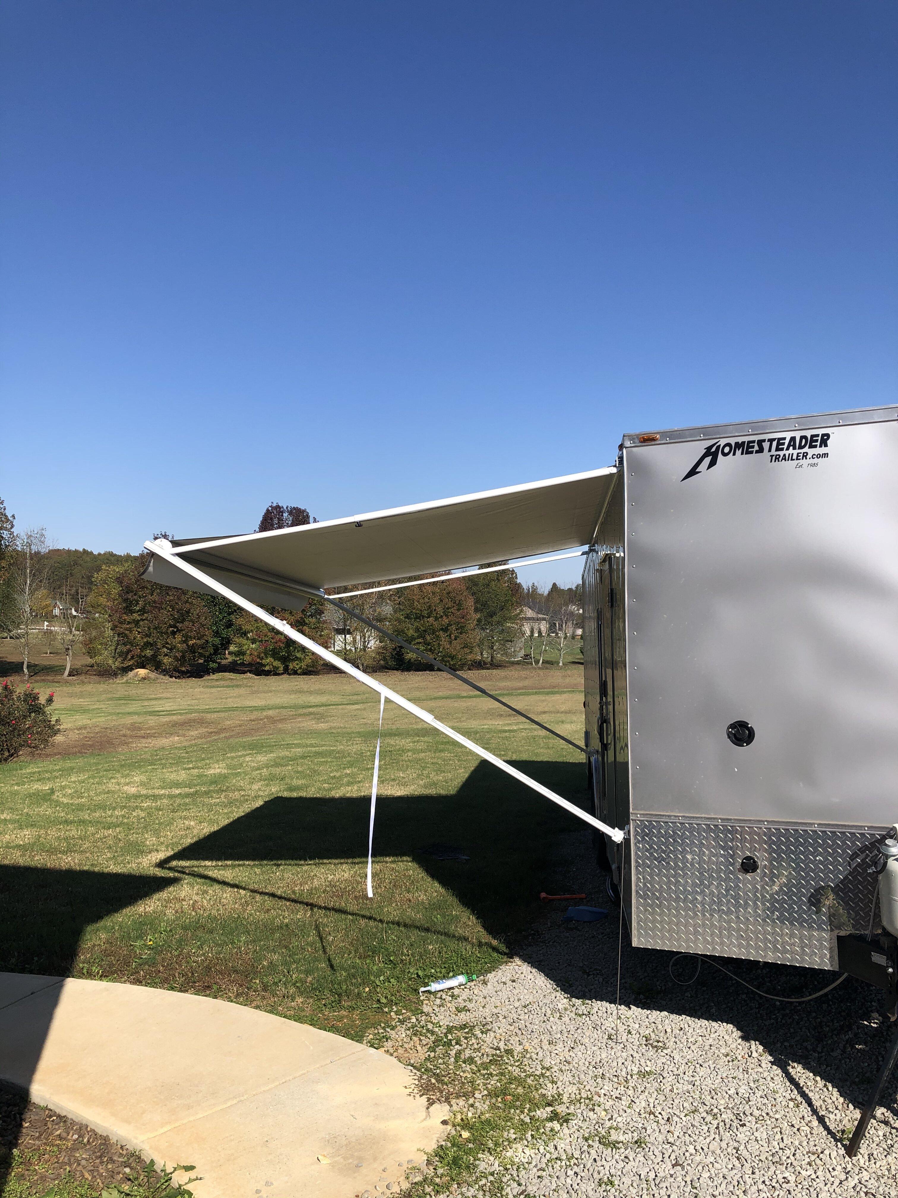

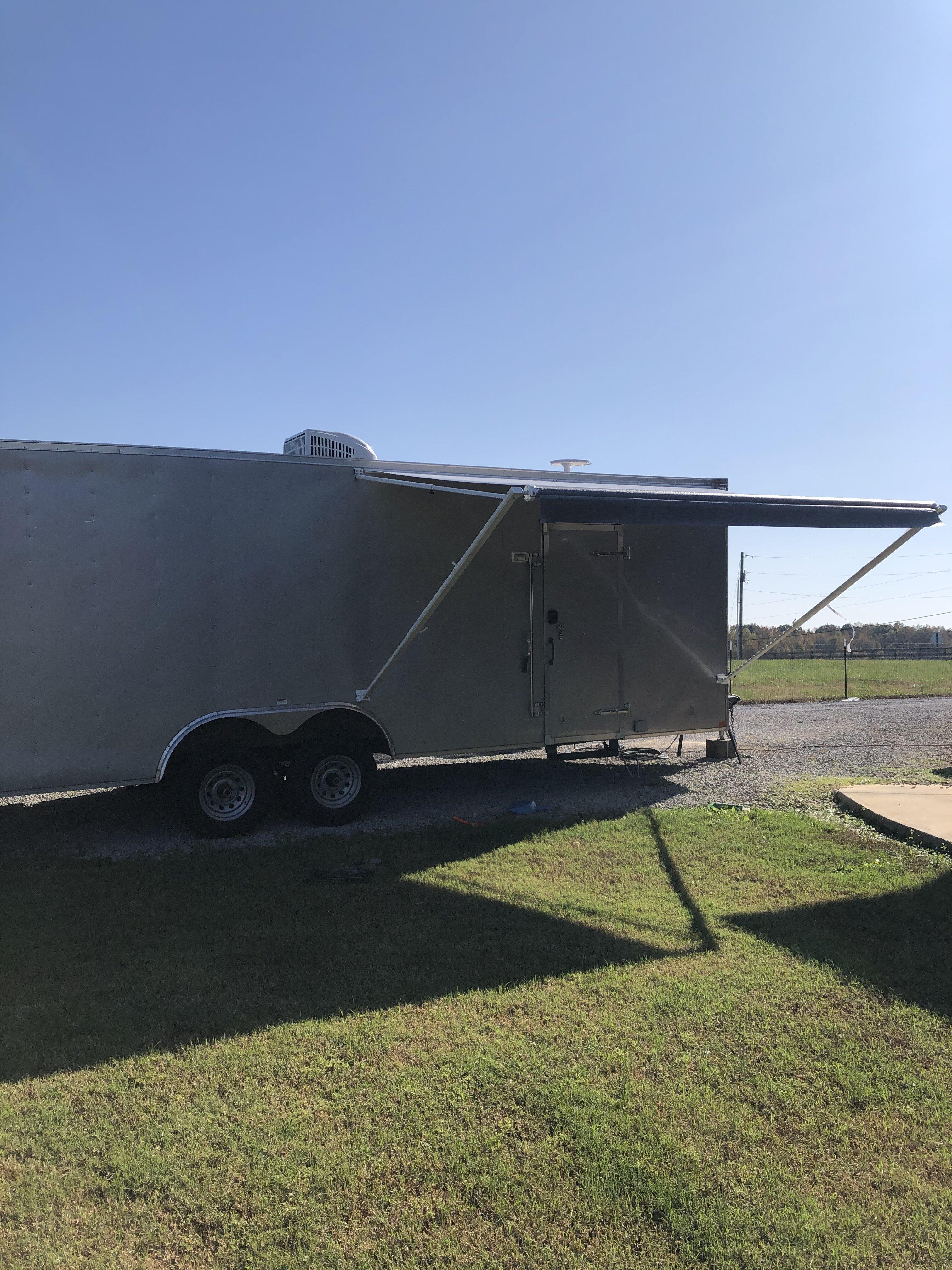

You talked me into it. I found a 12' shipped for $381.

Please share where you bought it. Also please tell me what was involved in installing it.

https://www.alekoproducts.com/Retractable-RV-Patio-Awning-12-x-8-ft-p/rvaw12x8blkst33-ap.htm
They have 15% coupon code on their homepage, didn't charge tax and free shipping. Other sizes/colors available.
It isn't hard to install but the directions are horrible. I did it all myself except I had to get help sliding the fabric in the trailer rail. I used my own stainless screws and bolts the ones they sent were made for a camper that already has an awning and weren't long enough for my application. Main difficulty is making sure you have a solid mount. I drilled all the way through the wall and put washer/nut on inside of trailer wall.
I used a mixture of their instructions and this video to install mine.

Shows "MERRY" as the current code. I looked on my invoice and it shows DSC-653 as the code if you want to try it. If you get one and have questions, pm me.
