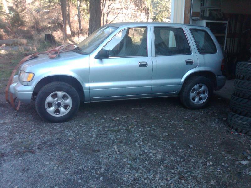

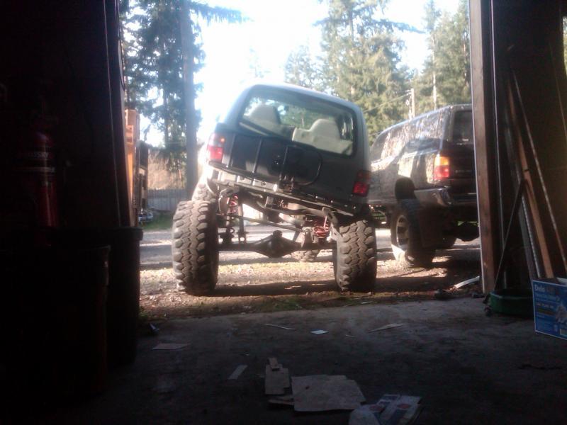

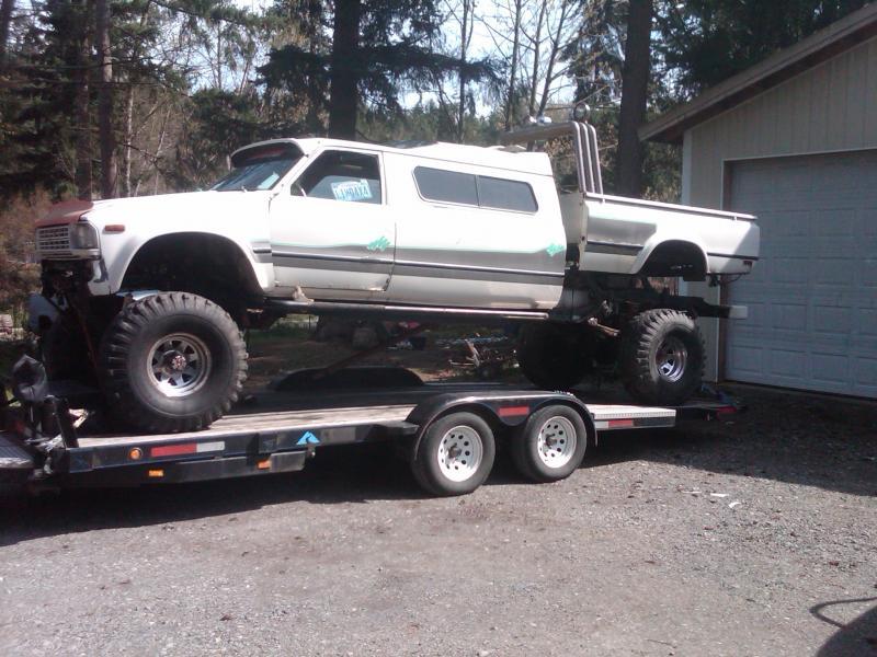

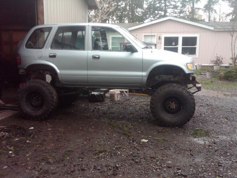

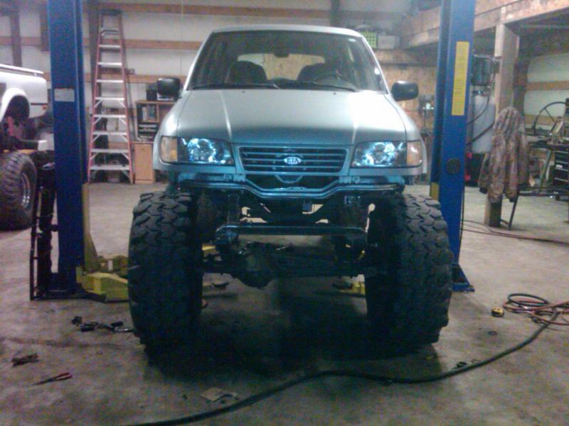

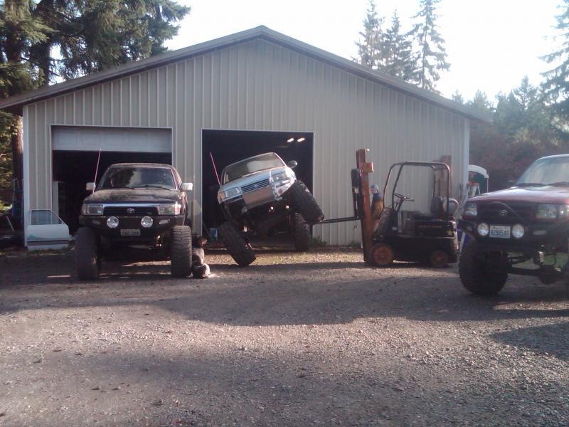

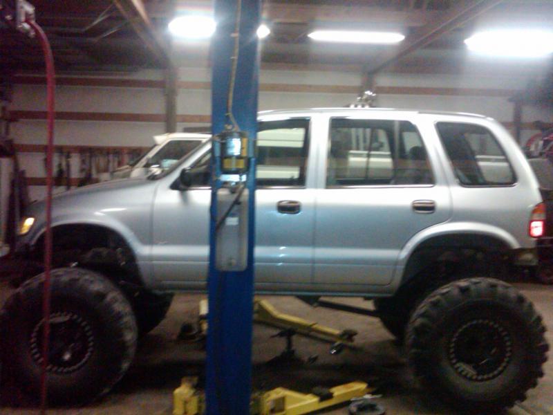

Well I have been tying up a few of the loose ends on this thing the last couple of days and for those who noticed the upper link seperation at the frame. I fixed that :awesomework:. I took it outside for a bath. and got the shop cleaned up (long overdue) and me and my bro got an engine dropped in his tow rig. here is kind of a before and after pic even though the bumpers arent on it. and our ride to KOH next year :cool:

Out of curiosity, do you have a height measurement where it sits now??
Looking forward to the bigger tire pics. hehehe:awesomework:

Looks good! Little tall, but not bad.:awesomework: Edit: Nevermind, just looks tall.
Now what kinda motor did ya swap into the exteeeeeeeeeeeeeeeeeeeeeennnnnnddded cab 1st gen?:redneck:
Its 26" belly height and 80" to the highest point on tho roof. I might throw those other wheels and tires on tomorrow and get a pic :D
Its a little tall but it looks like fun. we dropped a 350 with a sm465 into the super mega cab it was going to get a 4.3 but it has to pull another mega cab behind it so 2 more cylinders couldnt hurt. It had a 22r in it so we knew that wasnt gonna work.

My truck w/37's is @ 6'6" belly is 20" ... I think its because the body of the truck is tall.:booo: Pics can be deceiving. lol :redneck:

i hope to see that thing drive down the road i live in graham. whats the deal with the toyota limo thing[/QUOTE).
Did you get your can swap all done I haven't seen your truck in a while? I think it might be a trailered rig but not sure yet. We are building the limo just cause my bro needs a tow rig. It was going to the scrapper so he rescued it and its at my place cause it was too long to fit in his shop.

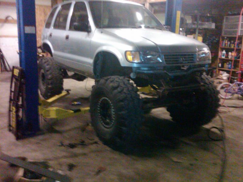

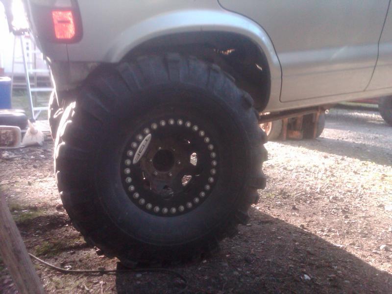

I got pics last night with the swampers on it but my internet is down so as soon as I get it fixed I will post em. I looks pretty cool with the beadlocked 40s on it tho. I'm on my phone right now and it won't upload the pics from it.

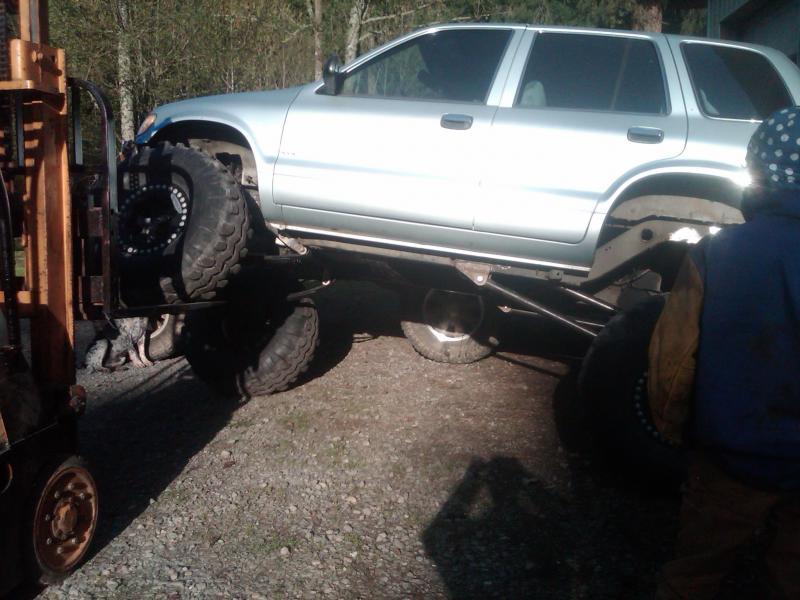

I made it home and my internet is working again so here are a few pics with the 40s on it. I think my tacoma is a little sad to loose its wheels and tires but its coo

hell ya looks sick on 4d's im gonna exo it eventually as for paint i just did a rattle can army tan paint looks pretty sick, so how hard was it to do a four link been thinking about doing it on my toy.
Cool cant wait to see it. I just did a three link on this cause I didnt want to have a fuel cell inside the cab, I did screw up on the frame seperation on the third link at first so fixing that was kind of a pain, but with all the kits for the yotas Some of those you can have all installed in less than a day ( since all the geometry is already figured out ) it would be super simple :awesomework:

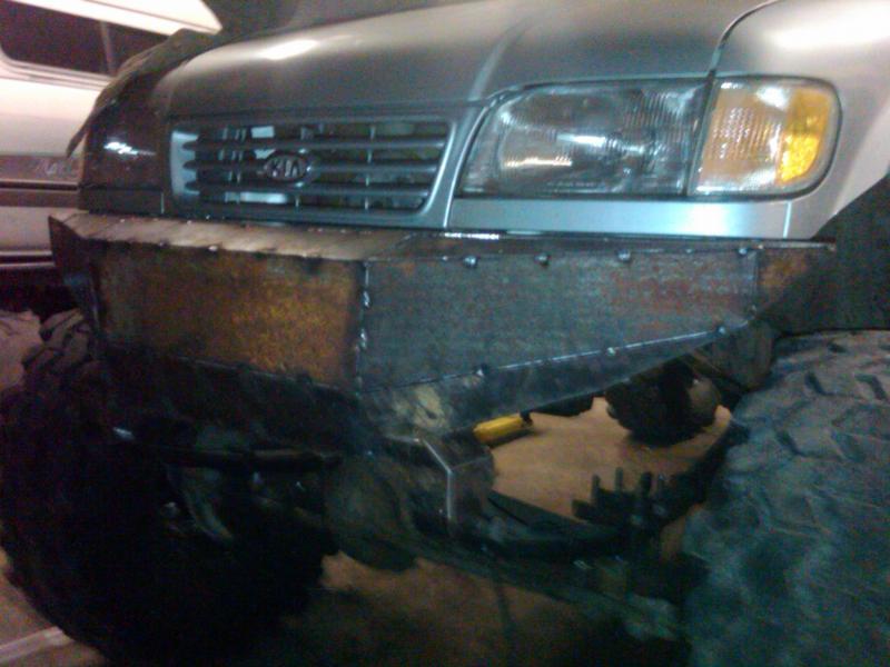

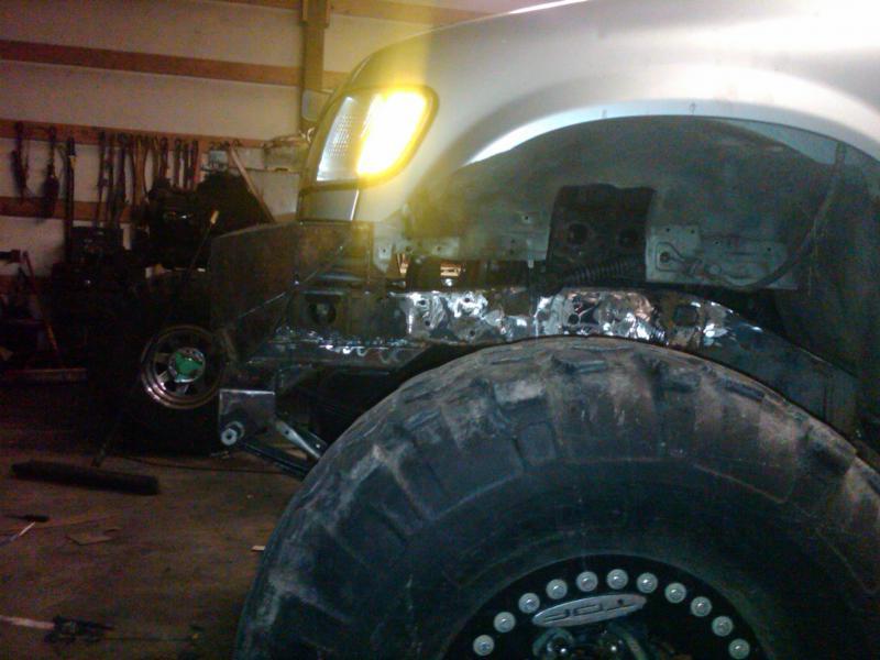

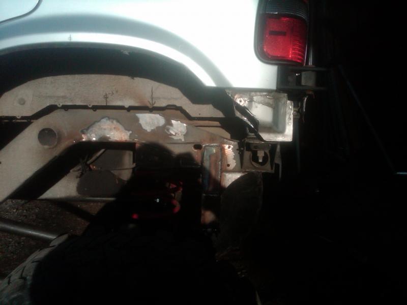

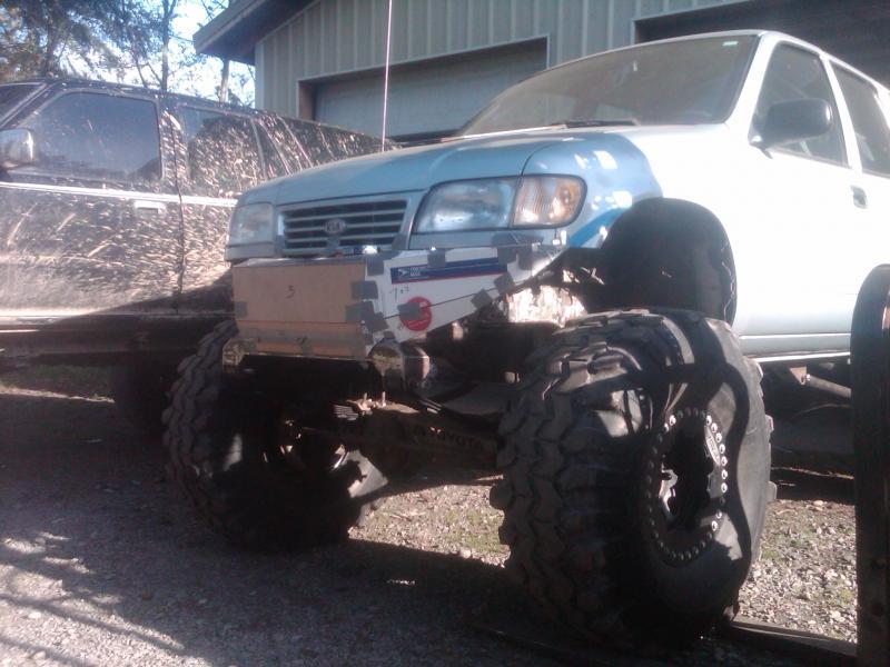

I got after it today it was so nice I pushed it outside to work on it :awesomework: I knew there was gonna be some serious rubbing so I didnt want to build a bumper and have to change it later on so I flexed it out and made a sweet cardboard bumper flexed it again and it all cleared so I started cutting some steel. I got it all tacked up on the outside and welded inside where I knew I wouldnt be able to get to once on the truck. I trimmed the fender a little bit It should be good to go with about 6 hours of welding and grinding. :D

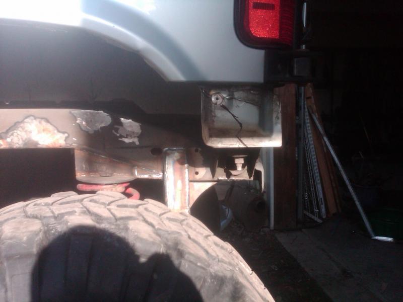

Also I got a little bit of trimming on the rear done too and got a good idea what im going to do for a bumper back there too
