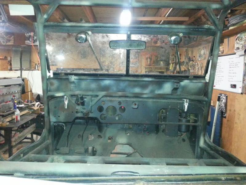

I dropped off the Willys the other day at James Koden's new shop. James has been doing custom rod work for a few years now.
I got started on the body work during the summer, but busy led to busier and it got stopped. I tried to put on the fiberglass hood that I got but the contours did not fit the tub. So I cut out the raised portion of the hood, with plans to cut out the metal hood and put this on. There it sat...
I purchased a new windshield frame, got it mounted but the frame is twisted. Second, the windshield brackets were different from the original and they hit on the cage. So, there it sat.
I knew James had his new shop and I've watched some of his custom rod builds. Mostly chopped rigs but some very nice work. So he's going to do the hood scoop for me, tweak the windshield frame so that it sits straight, mount all the glass and rubber, swap out the frame mounts from the old frame to the new one so that they won't hit the cage.

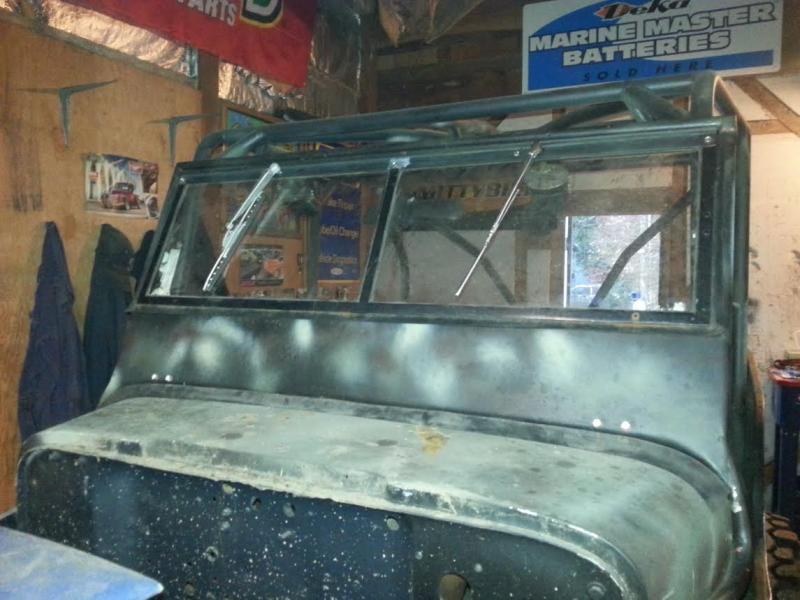

James finished up on the windshield yesterday. I'd post the pics but it looks like I have to get my money paid up before I can post more pics.
No problem. It has been fun working with these rusty old windshield frame. Everything is swapped over and ready. Hood will be done and should be ready by the end of next week.

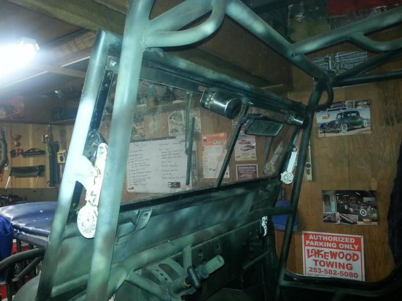

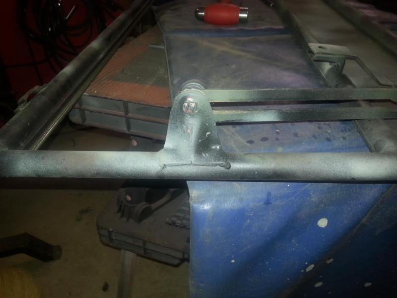

A few updates from Rew-T customs.
The windshield is now on properly.

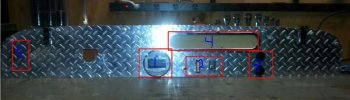

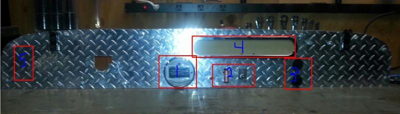

The new dash is mostly done. The headlight switch is not in yet but that and the wiper switches will go on the left side of the steering wheel.
1 is the radio
2 is the winch controls
3 is the 12v power plug and dual USB power jacks
4 is the digital instrument cluster
5 is the future home of the headlight and wiper switches.
