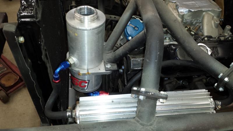

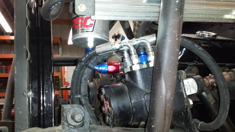

I did get the steering stuff put back in and system bled--found I had ram hoses backwards, ya that was a lil odd. :haha:
I just gotta get some nylocks for the tie rod bolts and that is done,

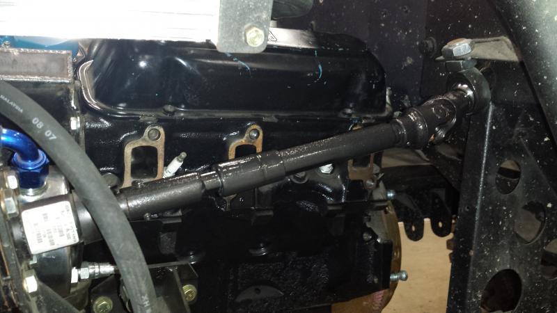

Cleaned the poor rusting steering shaft and got some paint thrown on..

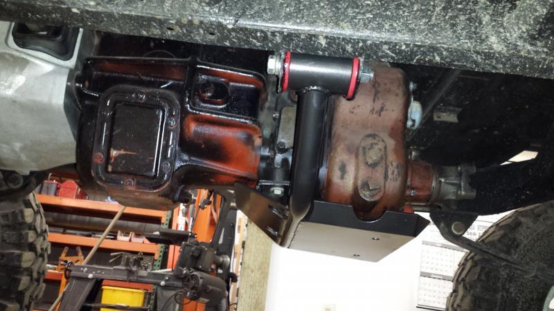

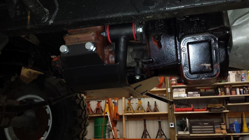

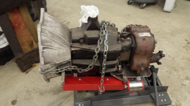

Got the cross member painted (new tranny jack) and got it all bolted in..

Is that really a Rockwell 221 behind a 465? If so damned good idea to keep the rear driveline angle in check!
Good eyes.
Why any different with this unit? This was quite short and the rear output is low on the Rockwell.
It actually seems to line up very well.

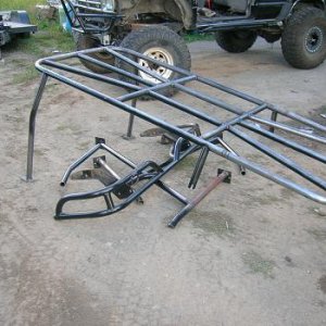

Drug this baby out and got it all cleaned, polished up and start naking slider/steps while i wait for oarts..
That's awesome. Nobody uses the case because they can be hard to find parts for. They are rather tough though so I doubt t you'll have any issues with it. I'd never actually thought about using one of them in a flatty, it's pure genius. :redneck:
Genious, aka a stroke of BS luck!
