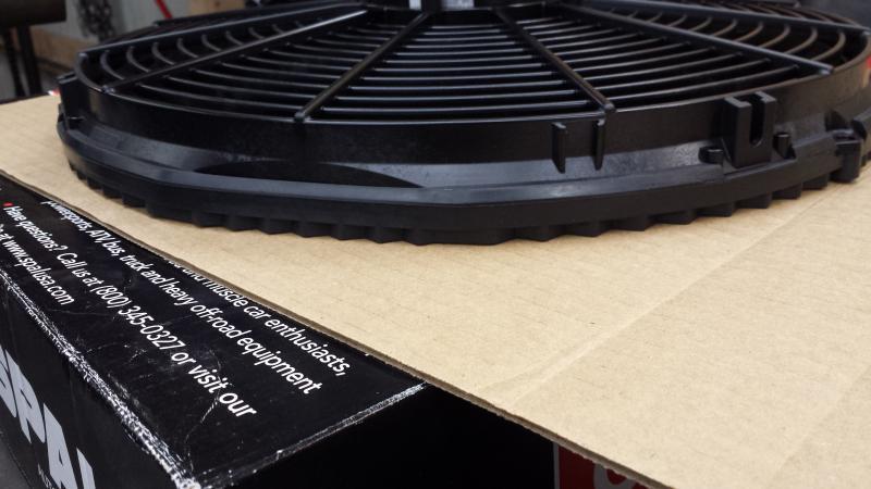

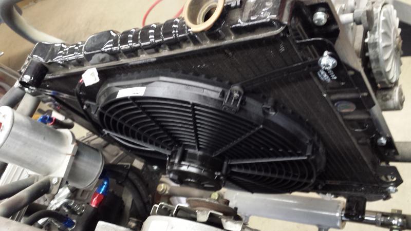

Got some goodies so time to get more done. Will be running the same spal fan i am since i know its a great unit. This time i found the part number for the rubber gasket. Pulled the rad and got it mounted up.

Rad is vack in for good.. Next will be diving into belts and hoses and brake lines..
